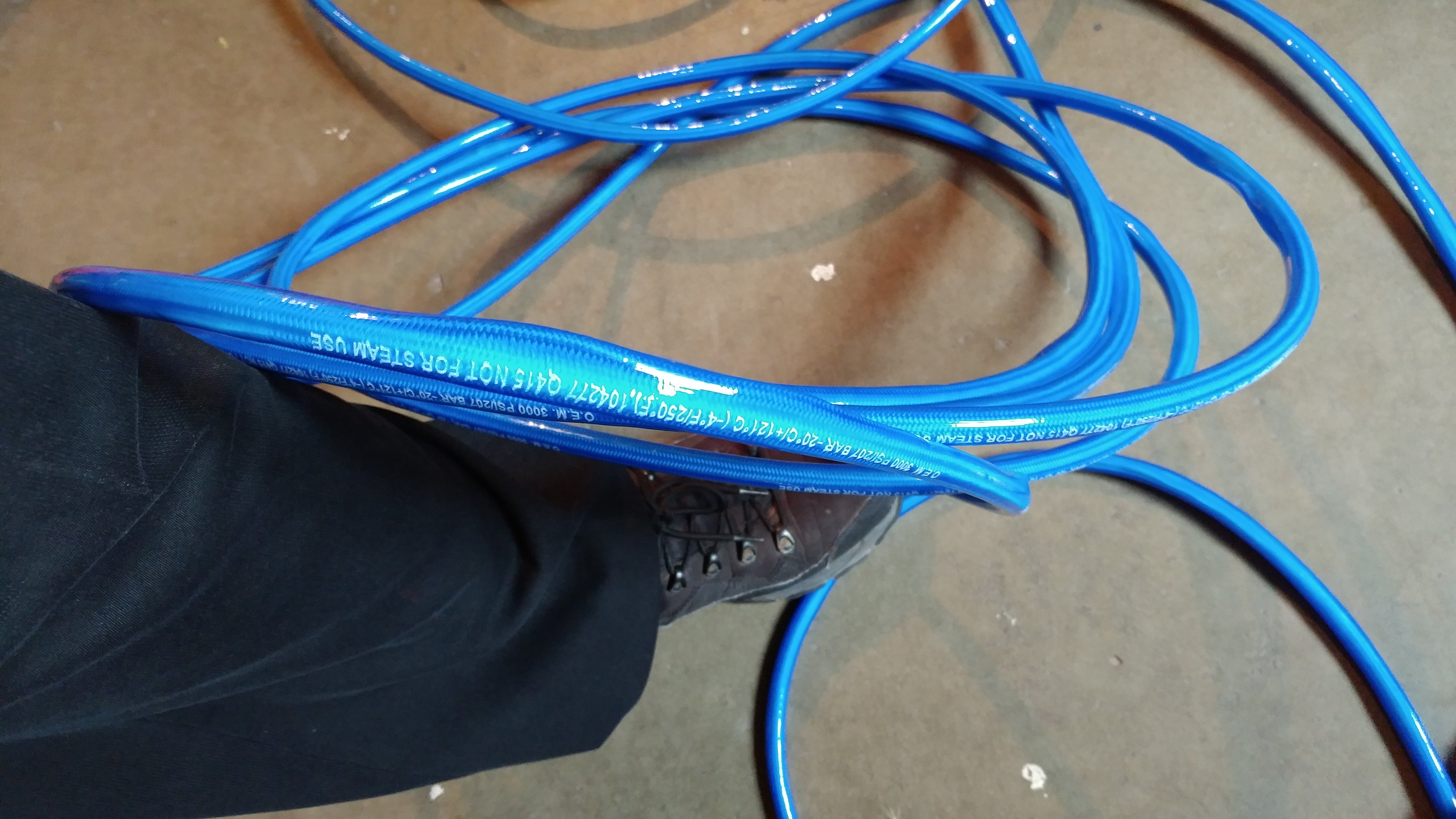

Yes, this hose says right on it, Not for Steam. My thermostat, that activates my dump valve for cooling, failed. I was getting well over 250F at my heat exchanger. It really spiked one day and I was blowing steam. It bubbled, or bubbed :winky: , the outer wrap. The hose itself seems to fine yet.
I do like the weight and the flexibility of this hose. The outer covering gets a little sticky so it doesn't slide well on itself, but it lays out nicely. No coiling.

There, that was easy.
You can see how the outer covering has blistered away from the hose.

It is an issue. The question is what temperature it actually reached.
Ron's Quote " I was getting well over 250F at my heat exchanger. It really spiked one day and I was blowing steam."
We have been over 250'F with several TMs for 6 months and not seen any blistering.

I would be very concerned about Ron Werners hose. Think of blowing up a balloon, when you initially blow it up it takes alot of effort, subsequent times it is much easier. That hose will not take the same heat and pressure that it initially did. With Ron's hose there would now be two strikes against him if he continued to use it. (1)Not to be used for steam, as the Desk Jockey said we market steam cleaning. (2) you would be using a hose that is visibly damaged, if someone was to get hurt from it who do you think would be on the hook?

Ron needs to cut off the damaged end & recrimp.
The hose takes industry standard 100R7 crimps.

I just talked to Ron
His problem came about when his John's Custom HX sensor failed and let the unit get too hot for too long. he has a "blister" at the machine end of the hose which he is not concerned about. He feels the clear cover has nothing to do with the integrity of the hose, and if it were to blow, it's at the machine where (maybe) no one will get hurt.
Larry is correct, Ron should cut off that section of hose.

Larry, what is your opinion of the importance of the clear cover?
The clear cover is a wear layer to protect the braid.
The working strength of the hose is in the reinforcing braid.
For TM's with poor temp control, I would use a 50 ft. of wire braid at the TM.
It was required with the Parflex. Less of an issue with the 250'F temp rating of this new hose.

The affected area is at least 10-15ft away from the truck fitting. I still feel this hose will last for a couple years even after this overheat.
I wouldn't hesitate to buy another length or to recommend it. Its super flexible, it does take the heat. If you're truck is running the kind of heat that mine did, you need to tone it down. There's no need for that high a heat.
