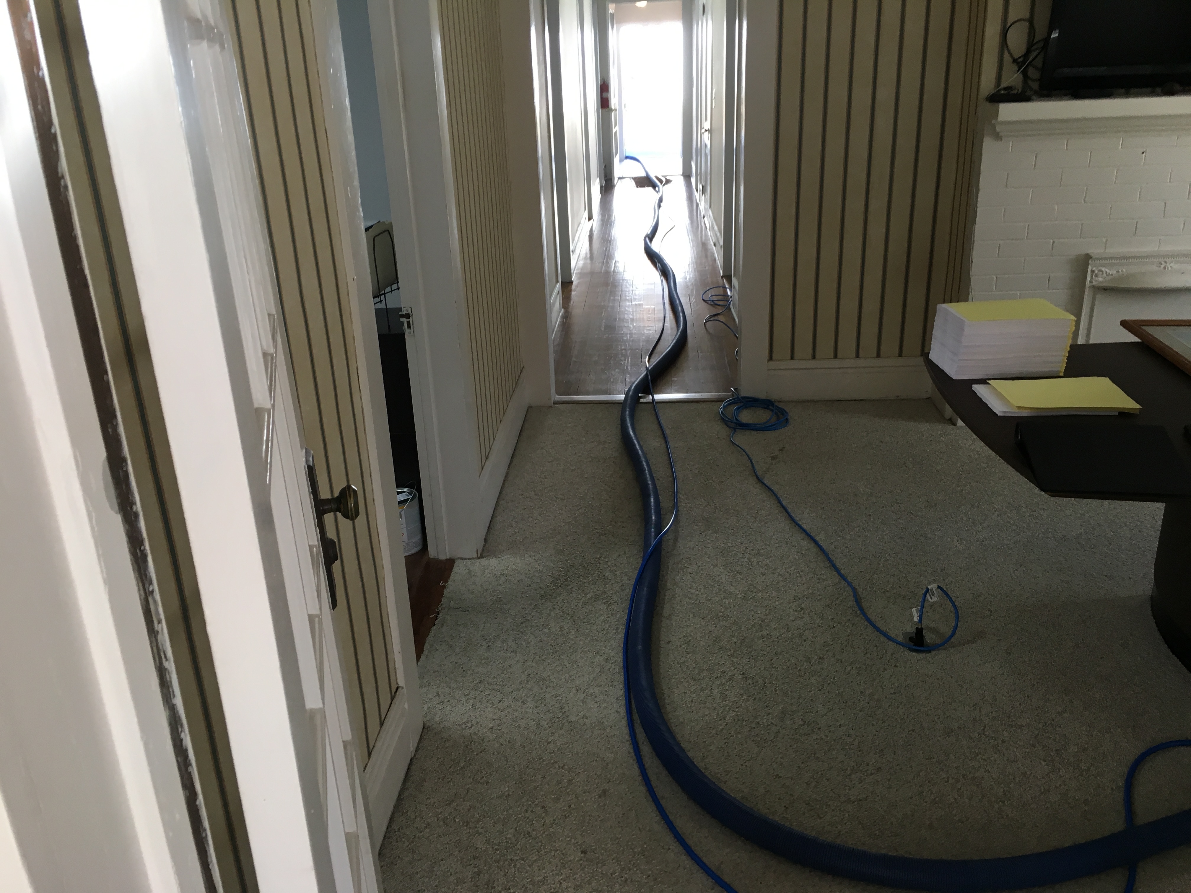

I used the Larry hose today on carpet and upholstery
Noticeably lighter than Parflex
Noticeably more flexible
Does not feel as hot to the touch
The skin is tacky/grabby as well as a pita to hand coil but I'll assume both will get easier as it breaks in
Only time will tell on the durability and longevity, but it sure appears to be a winner.
I dont think I'll use it anymore, I want it to look new for the RMH raffle.
Thanks for letting me try it Larry, by the time our Parflex needs replacing this stuff should be well tested.

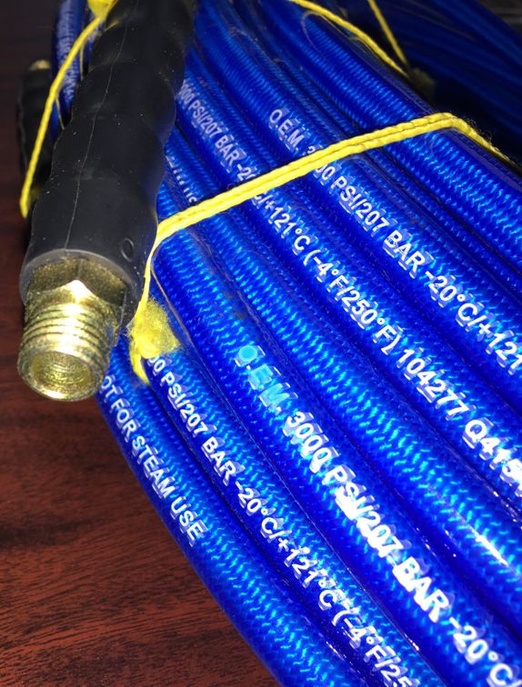

On the first run, I’m liking it. I’m a little curious though... when I pull the trigger after several dry passes, the sound of the water shooting out is quieter than it normally sounds. After a few wet passes, it sounds normal. I don’t think it’s steam, but I’ve been wrong before. Any clues?

The hose says "No Steam". You better pull all that off your truck immediately.
My water doesn’t get hotter than 235f. And this hose is rated at 250f. I’m not worried.

Matt, I'm sorry. I just can't do it anymore to you. I'm just screwing with you. Like the time I told you that you can't use your Cimex because it didn't have a built in breaker. lol
You’re a SUMBITCH! You really had me worried on that also. Dude, I drove a 6hr round trip to get that cimex and was driving myself crazy trying to figure out how and where to put a stupid breaker on it

Last I checked steam was 212°
Steam is not 212 degrees. That's just the boiling point of water. Your machine does not produce steam. It produces super heated water which passes through the hose. True steam machines usually start at around 300-400 degrees. Can get much hotter for specific operations.

View attachment 76879 On the first run, I’m liking it. I’m a little curious though... when I pull the trigger after several dry passes, the sound of the water shooting out is quieter than it normally sounds. After a few wet passes, it sounds normal. I don’t think it’s steam, but I’ve been wrong before. Any clues?
Since the braid is stronger,
the new blue hose probably does not expand as much from static pressure.
That smaller pressure storage capacity doesn't make as much noise.

That kinda makes sense. Either way, I'm still happy with it. The heat shield that covers the crimps is a little flimsy, compared to what I'm used to, but it'll work. Is that your product, or does that come from the hose company?

We have a black vinyl heat shield that is slightly longer: strain relief.jpg
But I like the factory model since it keeps the hose at the crimp cooler and it should prolong life under the strain relief.

Another good trait about these hoses I've found out this week is how much easier it is to roll up the hose.
Unlike the other hoses that I have to make sure is laid out in the straightest possible lines before I roll up, These are piled up in one area, and the memory of the hoses helps untwist itself while I'm rolling it up. The other hoses would automatically twist themselves up into knots if it were rolled up this way.
