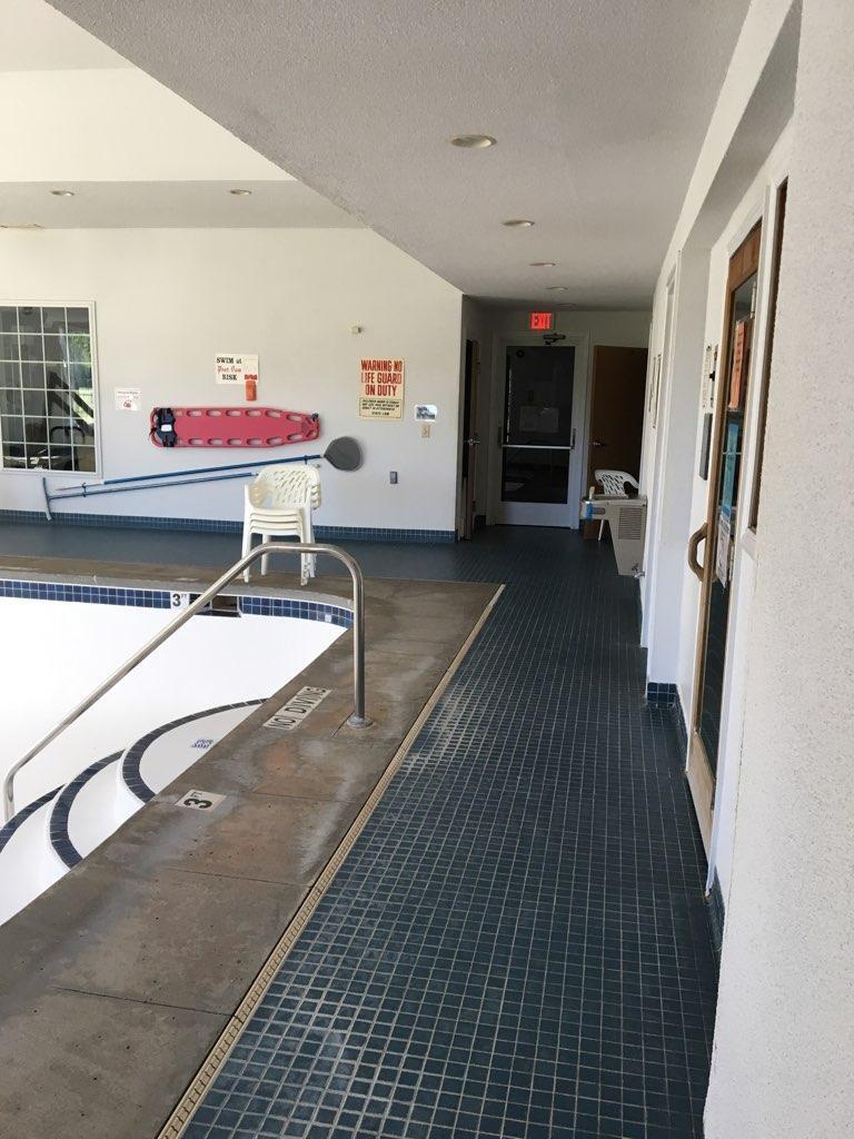

Got a call from a good residential customer today. Owns a health club that is going through a revamp. Tile/concrete in pool area looks terrible and needs to be cleaned up to hopefully "like new" for the re-opening.
Actual pool also needs to be cleaned/pressure washed due to construction soiling.
Would a strong acid cleaner (I currently stock Prochem Restoration Tile & Grout) easily do the trick on the tile & concrete?
I have a turbo hybrid and Cobra Hand tool at my disposal. If I need to reclaim water from pressure washing the pool any thoughts on throwing a water claw hooked up to a TM in a low spot? Any chemical limitations on what I'm assuming is epoxy coating in the pool? Care to point out any of the dozens of other factors I'm missing on a job like this?
I would be able to charge a fair rate but nothing exorbitant. Worth the hassle?

I bet some of that is permanent damage....
Just did a local YMCA pool this summer...similar situation even using acid, but we even saw the top layer of ceramic gone, and the concrete permantly damaged too from all the solutions in the pool

You MIGHT be able to get a bit of that efflorescence off and hide some with an enhancer but it will all be back in a week.
Hire Chavez to use some Muriatic Acid and it may last two weeks.
Pass, seriously pass.

Why would you clean it with an acid? Isn't the ph of the tile already negative from all the chlorine? Unless you're talking about acid treating it after you do the normal alkaline prespray.
The only thing I would say MIGHT look better is the darkened areas from the oils of people's feet. Everything else is damaged from years of chlorine on it

I agree with those who say this will not clean-up great nor stay clean long term.
If the expectations are realistic (low), this si the process I would use:
  1. Clean with alkaline cleaner, Viper Venom Powder would be my choice
  2. Clean with an acid, Viper Renew would be good
  3. Rinse with plenty of water with a little alkaline detergent added to neutralize the acid.
  4. Coat the tile with a color enhancing sealer. This helps hide the wear.

Concrete need diamond hone/ refinish tile need a lot of manual crawling to remove hard water then clean

I think it's made by advanced. I hate to say no, so I would promise nothing and test an area.
Mop on cal clean with a cheap plastic mop(throw it away when done), let it dwell, scrub with a doodle bug and rinse. See what happens. Warning do not use in/on or near anything metal that you want to keep.
If they are looking at replacing it maybe you can be a hero. Managing the owners expectations is the key.

All depends how busy you are. And how comfortable you are taking in unfamiliar work.
My spell check on earlier post had mind of its own
Those low spots on tile that pool and dry.
1. You want to remove most mechanically
2. Folllow up with cleaning using acid base and agitation.
If I remember cal clean is an acid. Phosphoric is another good acid for minerals
The hardest part will be the grout lines and mechanically removing most of it without scoring up the grout.
If try to go straight acid- you likely be unsuccessful and eating up all the good grout around it
There is possibility grout is stained - but will 90 percent better
