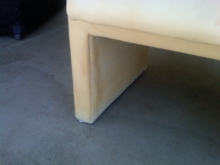

"THIS IS AN EXAMPLE OF CELLULOSE BROWNING"
3. If the fibers are natural, you should suspect cellulose browning.

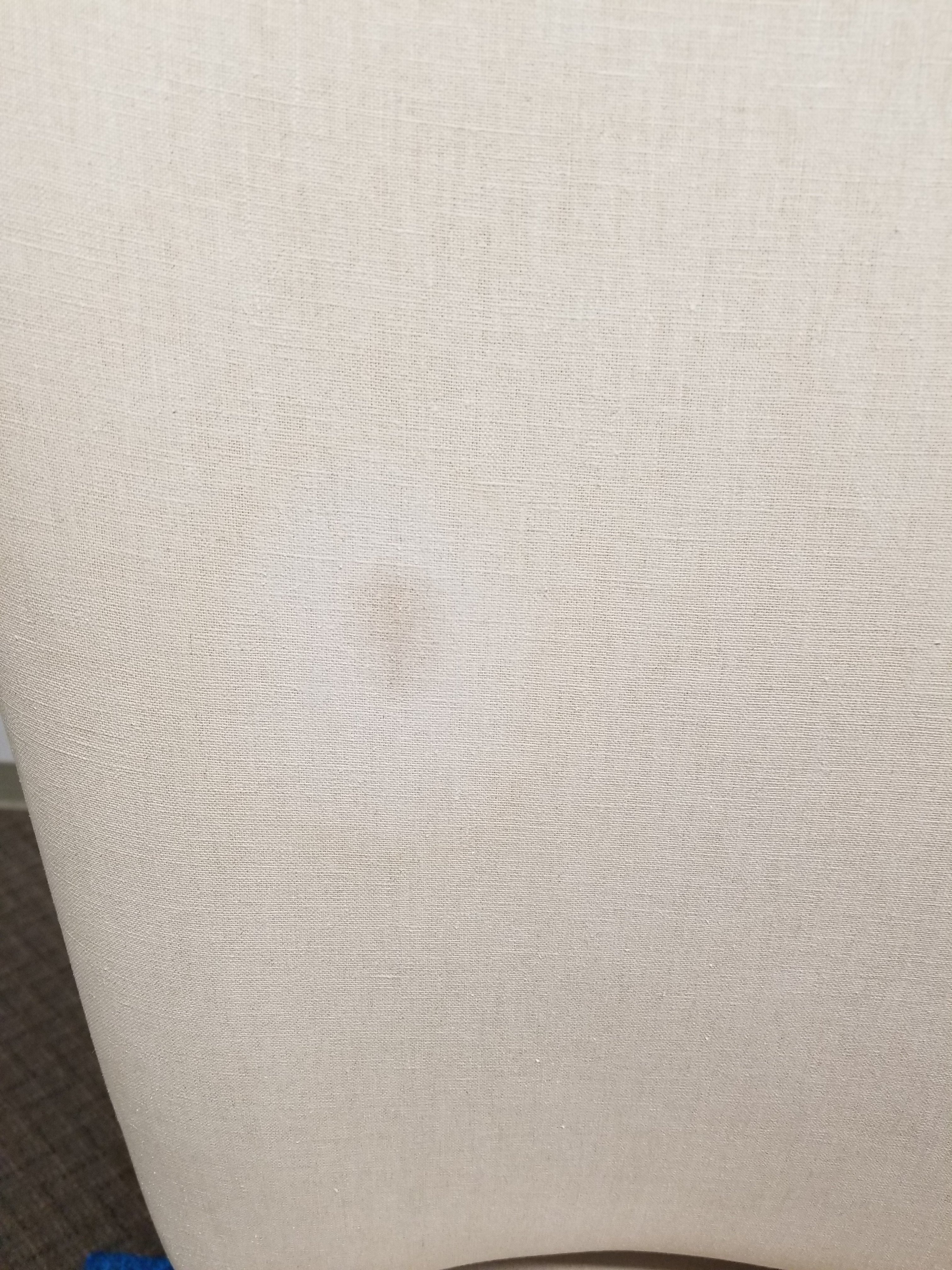

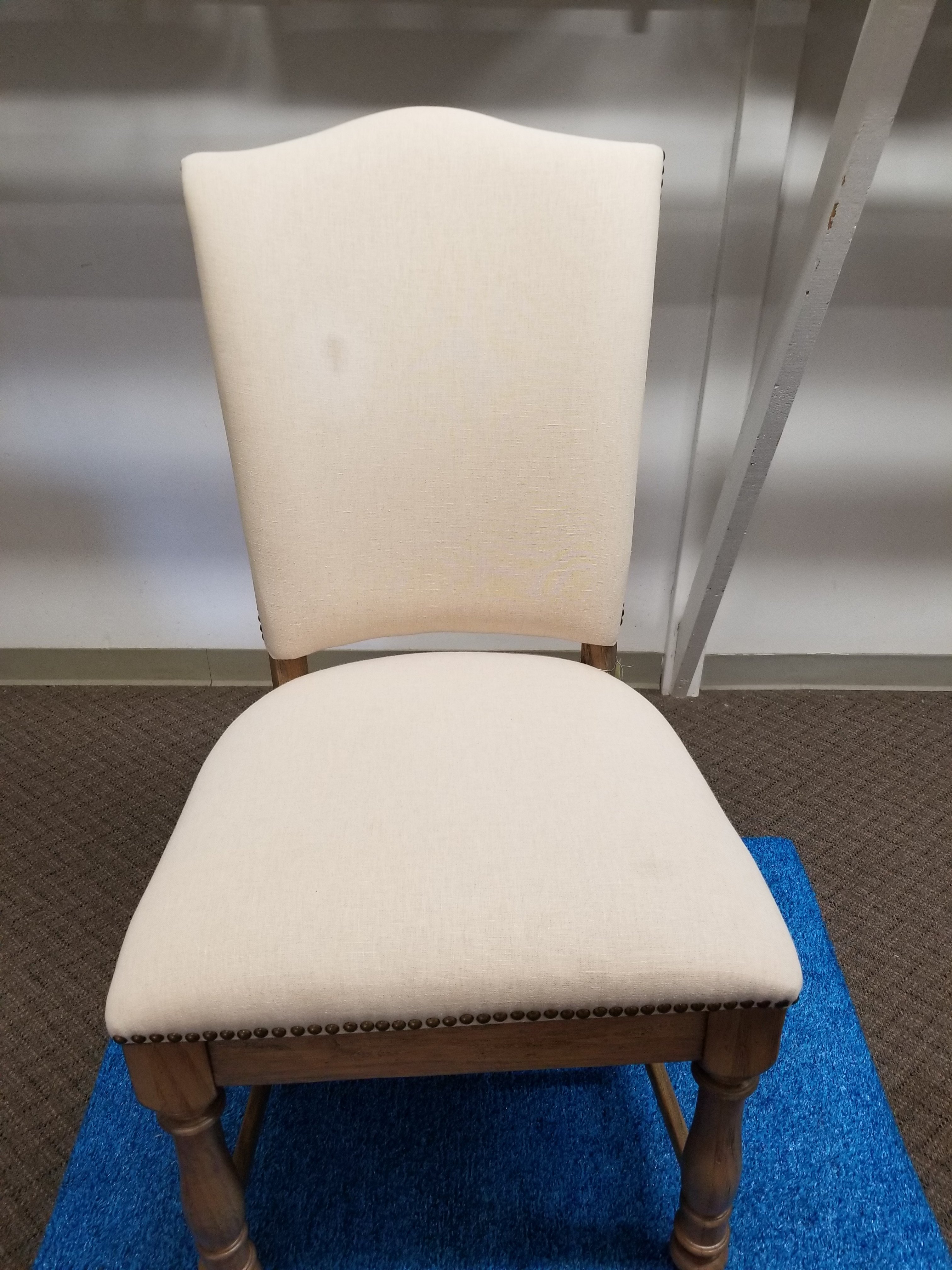

This chair was brought in last week. A casualty of Thanksgiving???
It had a large nasty water ring where the homeowner had worked on it and made it far worse. (Wish I would have take a pic) We misted distilled water as you suggest for a first step. It did fantastic! We did it a second time and now there is only a very slight ring left.
Now for the spot. The homeowner got too aggressive and distorted the texture some and left a halo. We will attempt a neutral cleaner and see how it responds. Unfortunately there was no fabric protection applied and with such fine fabric I'm not very hopeful for removal of the spot.
It did correct the nasty water stain if nothing else. We shall see where it goes next week.

Thanks Jim. I am going to abuse it, then try to restore it. I want to try with an alkaline upholstery prespray, dry vac well and see the results. Then I will do it the right way and see what the difference is. Got to get a tripod for my phone.
Cleaning Professional
12,857
This is a great way to learn. The only hint I would like to give you is that new fabric is often forgiving of alkalinity and overwetting. The cellulose material (in this case linen) hasn't yet degraded, and sometimes protector is present. You may not be able to turn it brown.
I embarrassed my self 35 years ago during the early days of Haitian Cotton. I had an upholsterer make me a cushion, cleaned it carpet detergent the end of the first day of class, and told my students:
"This will be brown tomorrow"
It was as white as it was the day before.
