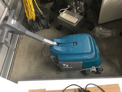

I already placed my order on the dirt dragon. If I’m not happy with it, I’ll send it back with their 30day guarantee and get that t1
What makes it better?
CJ-FL
Jan 28, 2018
445
Florida
CK-FL
As you could imagine, Steemer guys are hard on equipment. I never owned a Dirt dragon because of the bad feedback from other franchise owners but what I can tell they said the T1 is much more durable. we have probably 15 T1's with the oldest probably being close to 5 or 6 years old.... surviving a Steemer tech who will just toss it in the back for 5 or 6 years has to say something for its durability. My main complaint is the squeegees themselves.. if the tech doesn't raise the "vacuum head" or store the unit on it's back the squeegees will warp. They also turn "gooey" after about 6 months of use and need replaced (about $40).

lll sell you one of our used T1’s... half are the green Tennant color but more recently Corporate got them in Black and private labeled. I’ll replace a green one with a newer black if you’re interested. PM
me tomorrow if you are
