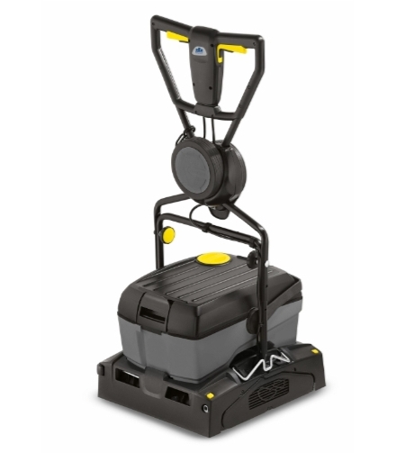

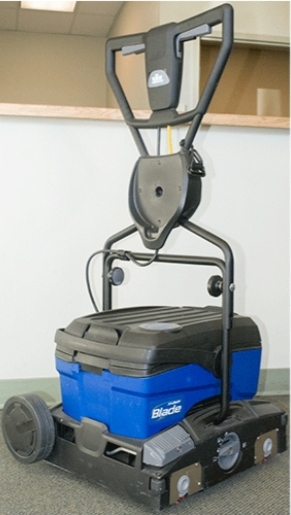

I had the karcher branded version of this Br 40/10? seen them as windsors as well.
It did an ok job but looked the berrys, I didn't do enough to keep it... sold it to my brother for $100 more than I paid because I care
he's used it less

Has anyone else used that Bona Power Scrubber above? I'm really wanting to get a machine like one of these to make the job more simpler and technician dummy proof for the future, so I'd like to know which one would do the best

I'm considering getting one of these from my local Janitor supply.
I love that it holds 12 gallons, and that it has the crb method in front of it. I'm wondering if it sucks up all the slurry so the floor isn't too wet. What's your thoughts?

its too big for residential its for malls supermarkets etc... you'll have tourettes before you get it inside
demo a karcher if you like grey
or a windsor if like blue..
..or use your TM after a 175 or crb scrub

I hate these stupid little chemical tanks on those machines. I'm targeting big hardwood floors, not little house rooms (12X14'). I just put a bid on a 35X75 room
12 US gallons is around 45 litres
my 16" floor scrubber holds 30 litres and runs for around 40mins non stop on VCT without refilling in a supermarket..

I don’t see why our suppliers are trying to sell us these little 3gallon tank machines then.
Anytime you have to stop to drain and fill the tank is worse than having to put the wand down to move the hoses.
