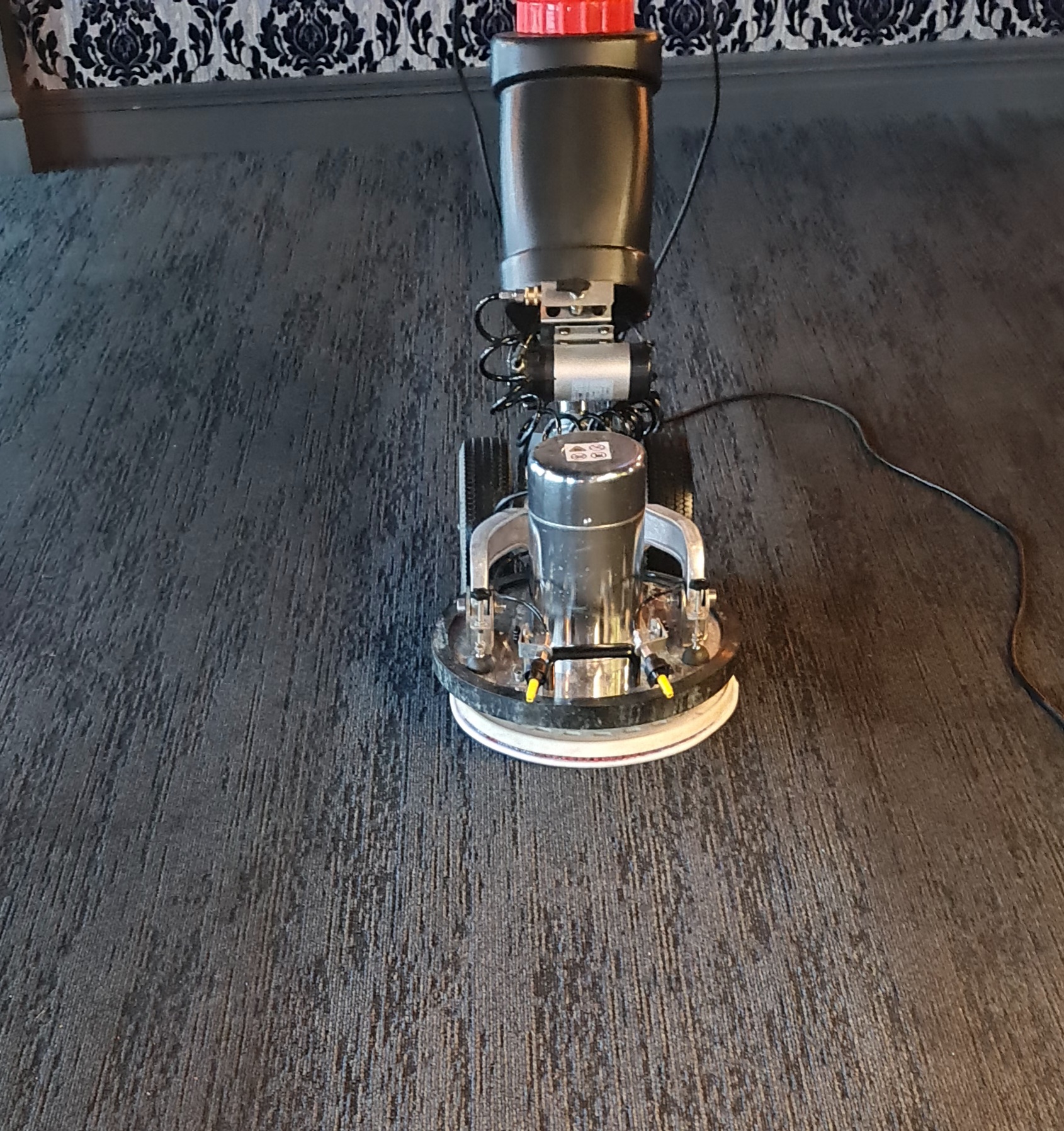

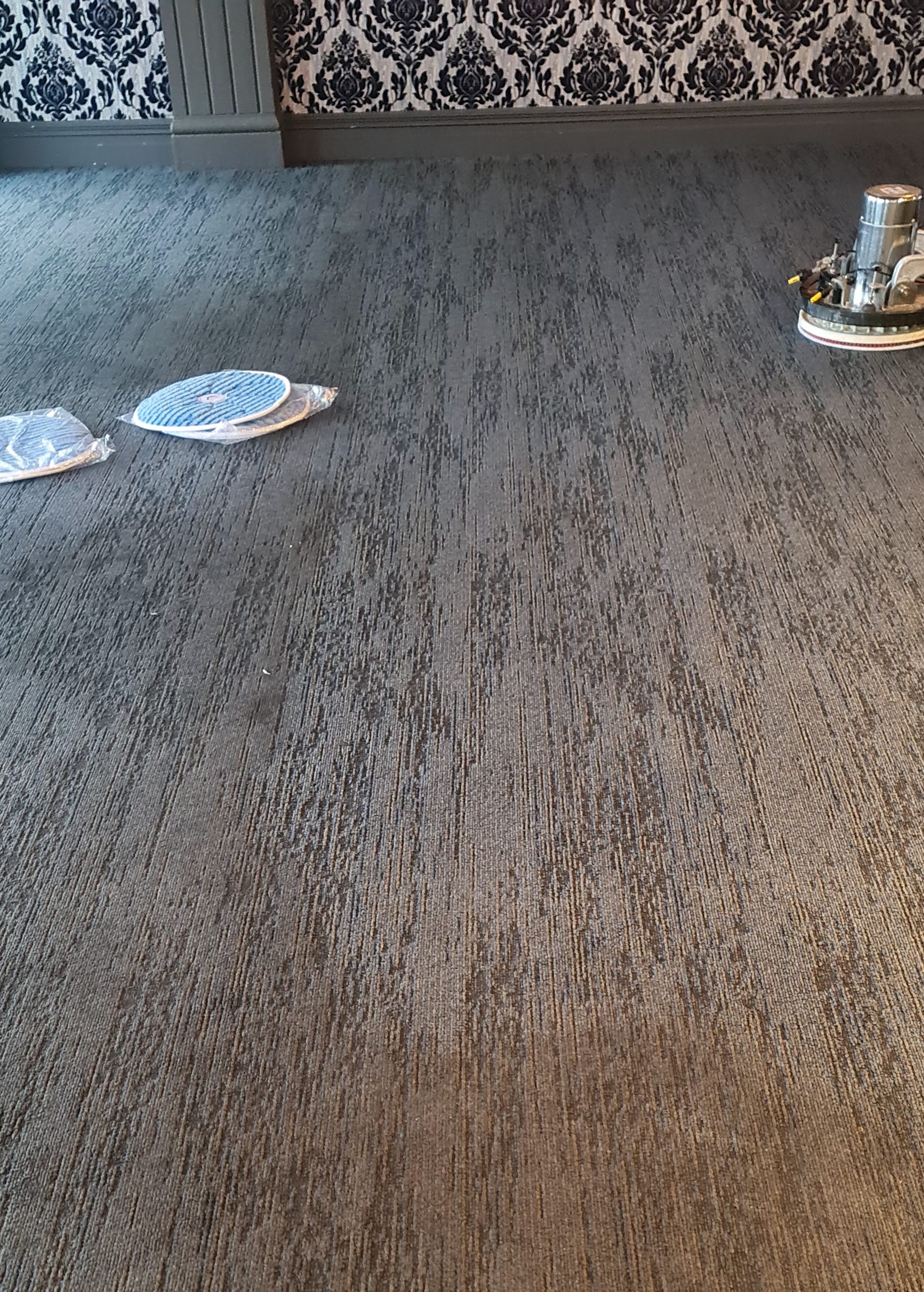

When I clean CGD that is pretty nasty, I get a cotton pad semi-wet and watch it turn black, while still not getting the carpet wet as HWE. But since I do get it more damp when using a wet pad, I just run a MF over it after.
Seem to be working because my commercial side is growing and the clients rave when I check on them.

This is the thing. It's really a process for commercial carpet. That's where it works best. Like you, my commercial side is growing. Friday I have another 10 story building to do, Saturday, I'm giving an estimate on a 14 story building. I have a 32 story building to schedule in as well as 2 towers downtown in August.

this is the worst cgd I personally encap, I start 7am (their requirements) I'm out by 9am and they open doors for lunch service at 11am
they're open 7 days into the wee hrs, HWE puts them out of action too long
*it gets HWE once a year on staff social day, encapped other 3 visits

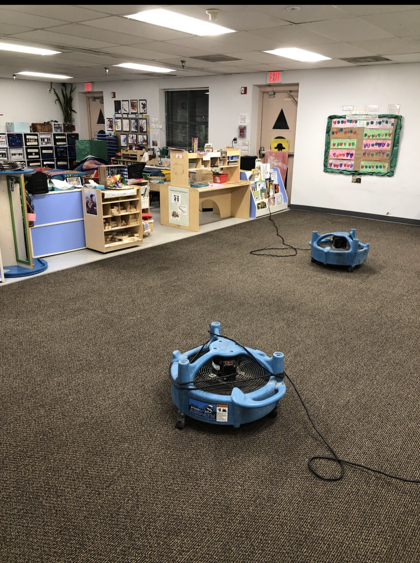

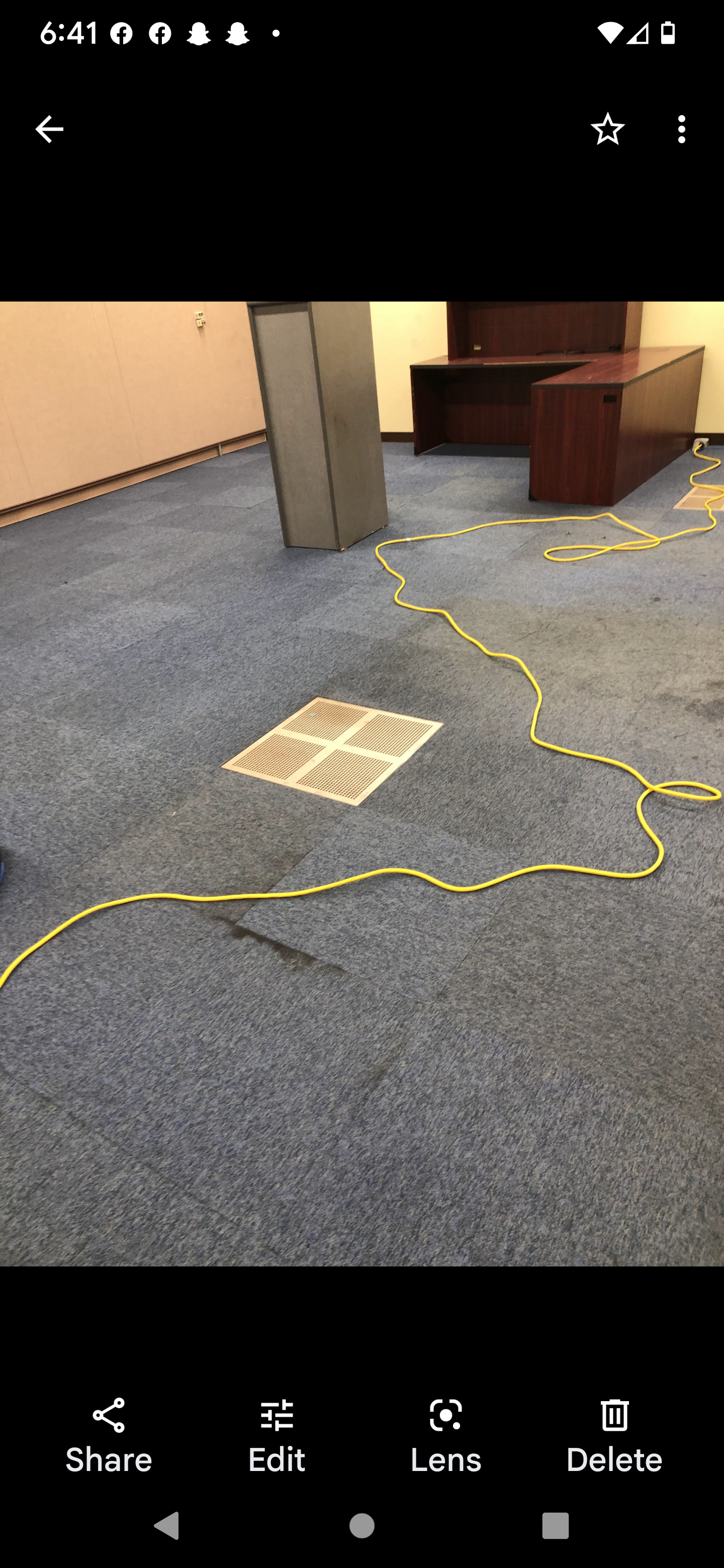

I've done both, the vlm came out great there was no way to run hoses doors locked government facility.
Would've been 350 ft run easy
Basement area that would have been swampy.
My commercial jobs dry fast!
