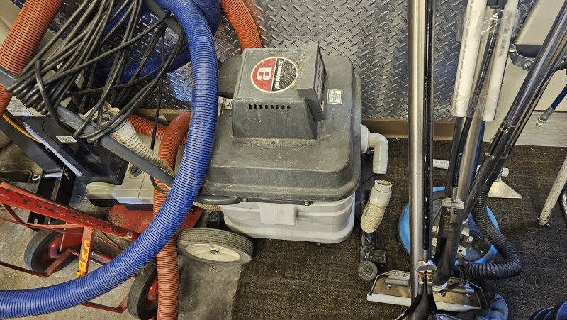

I'm always broke, and I actually already have a couple of those shop vacs and they are a pain in the ass to dump, when you run them till they are full water poors out the hose when you unhook it and then it spills out the vac port. The hose get twisted and when you try to untwist it the machine sometimes tips over.
With my portable I can run 25 - 50' of hose, it's easy to drain, and I can use a decent wand.
I also use that old portable for rinsing the slurry. I use a neutral floor cleaner for that.
I had an EDIC porty and it wasn’t worth 2 cents as a porty. 110 psi 😏I started using it as a vacuum for slurry and might’ve lasted 6 months. You couldn’t clean it enough. That crap gets in the vacuum motors and soon it just craps out😏
my old Ninja is still going but I probably don't do as much wax removal as you. Bearings are going in one vac motor but still works. I still have a couple of spare motors in the shop.

Should work fine except for the wax build up in the tank and hoses. I have an old portable that I use for that. I clean out the tank and hoses with stripper. I don't know if I would want to do it with a nice machine.
