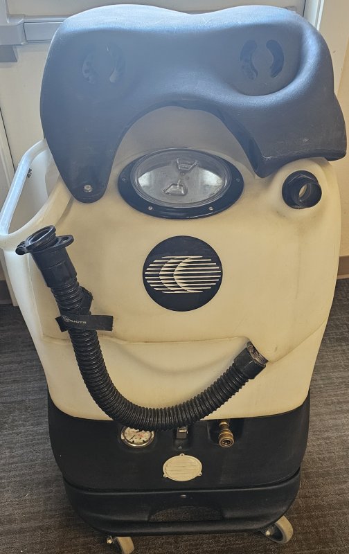

Any reason I can't do wax removal with my portable and Mikey's Hard Surface wand? Other than wax in the waste tank, what's to worry?

Should work fine except for the wax build up in the tank and hoses. I have an old portable that I use for that. I clean out the tank and hoses with stripper. I don't know if I would want to do it with a nice machine.

I'm always broke, and I actually already have a couple of those shop vacs and they are a pain in the ass to dump, when you run them till they are full water poors out the hose when you unhook it and then it spills out the vac port. The hose get twisted and when you try to untwist it the machine sometimes tips over.
With my portable I can run 25 - 50' of hose, it's easy to drain, and I can use a decent wand.

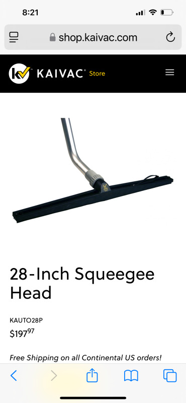

This with a Rigid wet vac is the cats ass for stripping small floors. I wouldn’t even want to get a good Mikey floor tool in that. It will swivel to even get behind toilets beloit or not.
It’s gone up a hundred since the last I bought, but it’s so worth it.

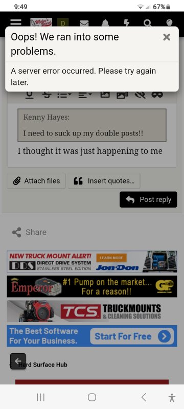

Double post?
Test

Most of the floor guys use a Tennent or Nobles or something with the squeegee on the front and push it around. When Diana was on the #truck with me, I wanted to buy one for her.😂 She nixed that real fast. She said, I don’t want to push a tank full of water around. She just used the Kiavac Squeege wand and 50’ of hose. Actually it was effortless. (says me😏)
