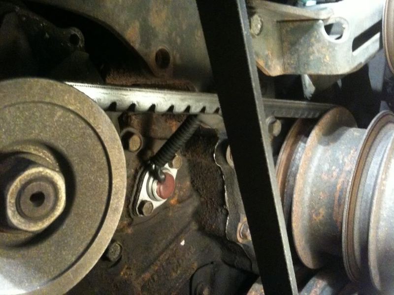

billy your truck should be fine. ive had this issue with two of mine. you engine is going into limp mode because one the sensors is not within parameters. i had the same issue, would be driving down the road and bam the truck would either start to choke or completely lose power for a few seconds. the check engine would come on and off as the truck derated itself ( it is protecting itself). the problem i had both times was the same sensor and it sounds like it is the engine speed sensor.
81 Magnetic Sensor 2373119D00 1 $73.96
went to the dealership and told two of the mechanics that were there the sypmoms and they told me to check two things.
first check the two wires that are connected to the speed sensor, more than likely they are corroded, burned, smashed, damaged in some other way or just disconnected. they told me either way if damaged or not to cut off the factory connectors and butt tie the wires together to ensure proper connections as to say, if it hasnt failed yet, it will fail in the future.
second, is to check the sensor for proper operating perameters. in other words you need to check the sensor for it operatings specs like correct ohms and volt test. i dont know where i put my manual but i the service manual that brad f. sent me it listed the specs for the sensor. both of mine were out of proper operating perameters. so i changed both. most ud dealers should have them in stock.
i am almost sure that it has to be the magnetic sensor, it is located at the front of the engine. will go outside and take some pics to give you an idea.

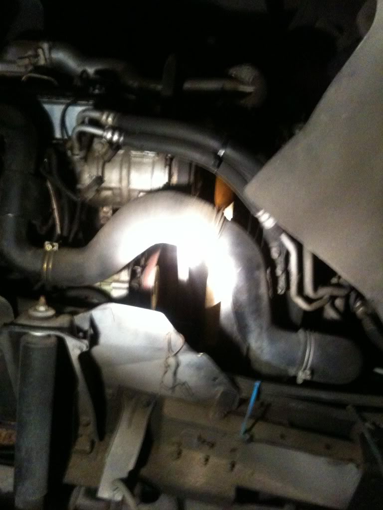

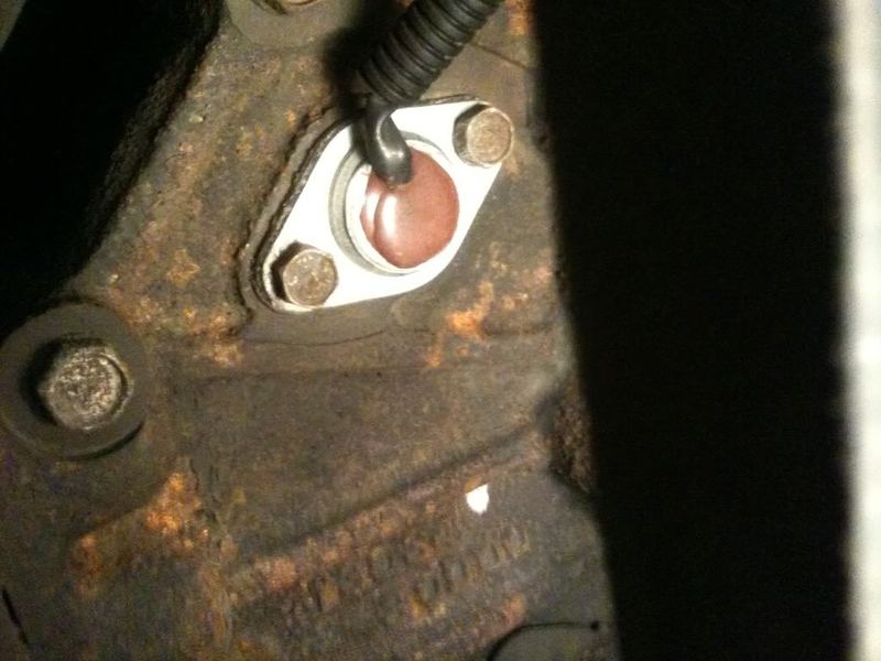

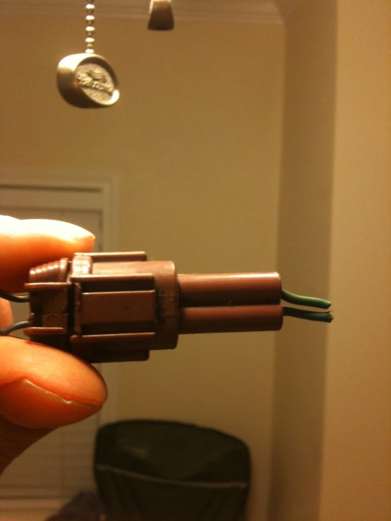

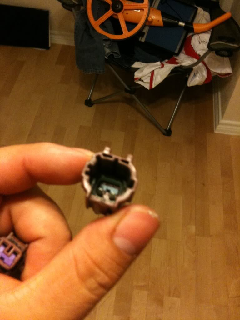

here are a few pics. sorry about the quality i just did it quick with the iphone.
here is a pic of the actuall sensor.
in this pic i am standing beside the front passenger tire, lean over the tire and look through the belts.
you need to look between the large black hose and the frame to see the location of the sensor.
here is a pic from the drivers side, of the wire of the magnetic sensor and how i cut them bought some covered connectors and re-did the connection.
here is the pic of the factory connections that have a high failure rate.
