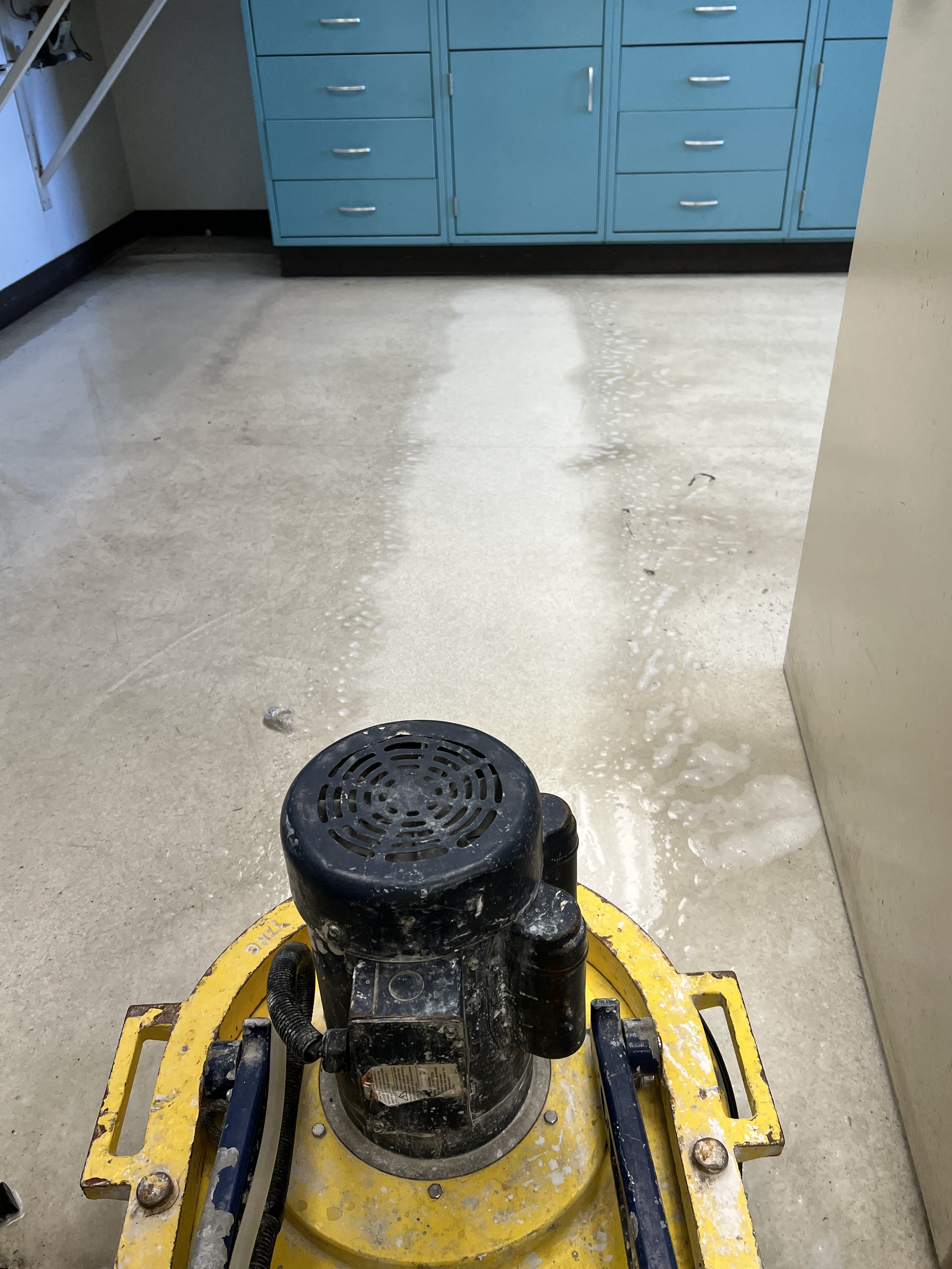

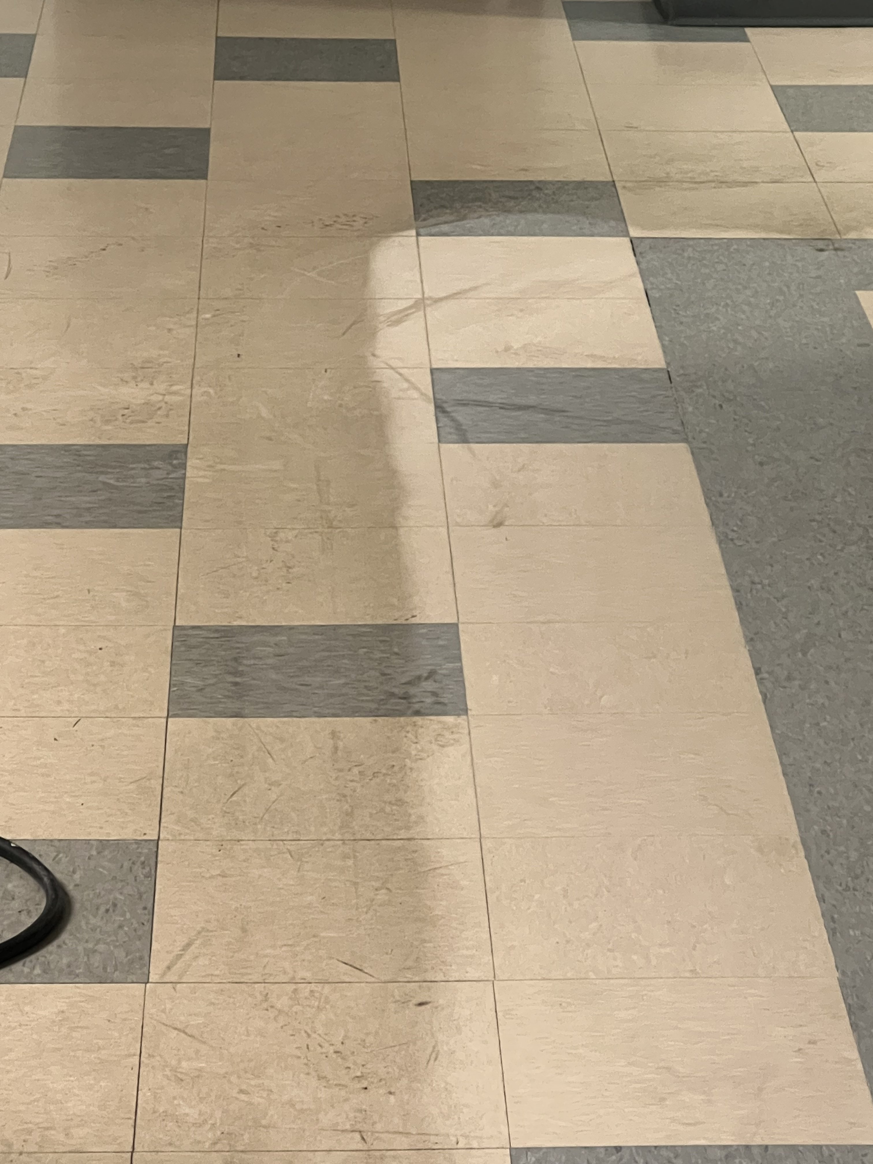

Top pic was using neutral cleaner and SPP pads, the second and the video are of a strip out at a water treatment plant using Betco Extreme stripper and Alligator pads from Excellentsupply. Both jobs used the Cimex Diamond Finisher shown in the video. It’s heavier and spins faster than a CR48 Cimex for carpet.
