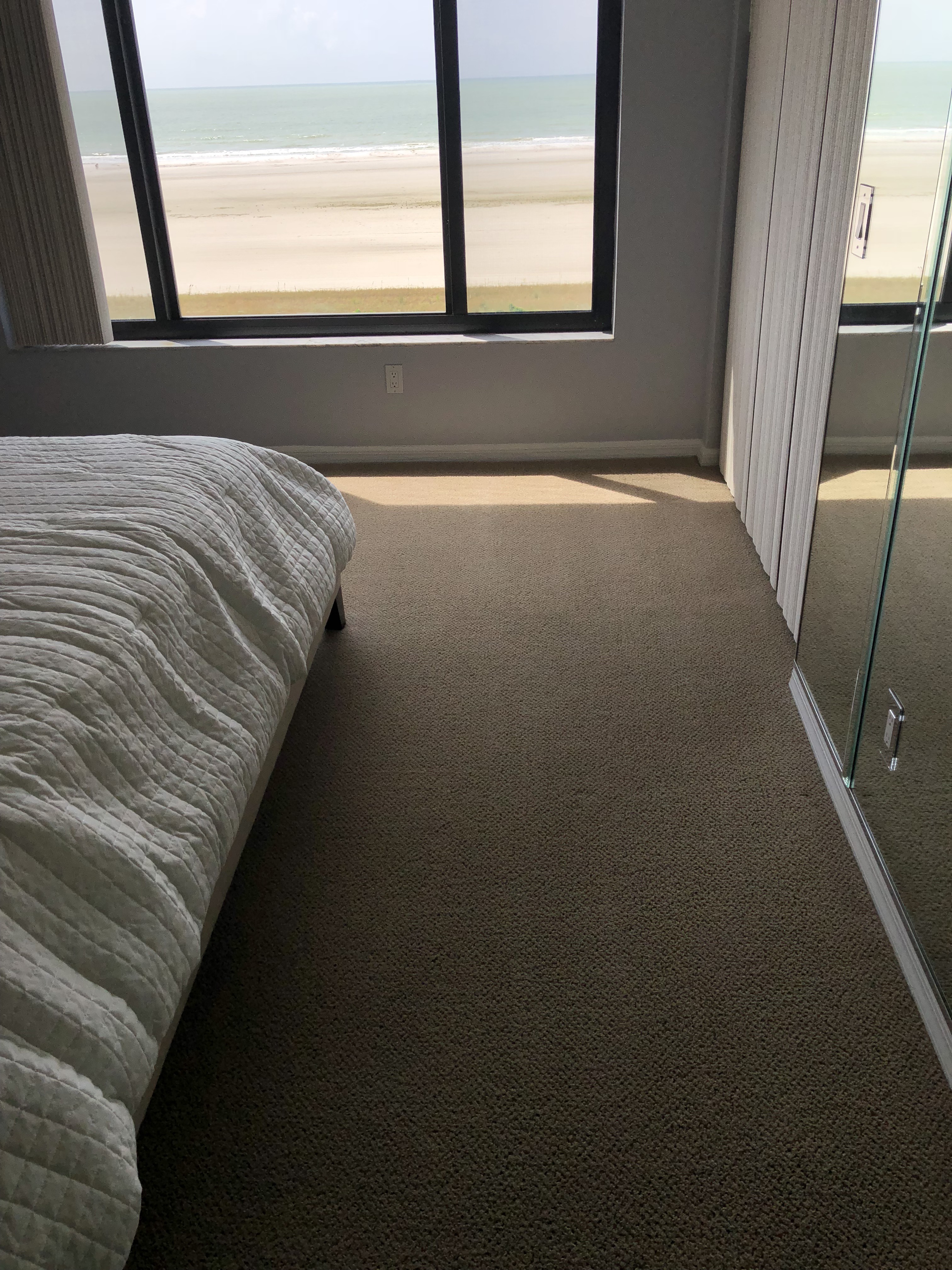

Using Mark's Blue Rinse...very slightly acid...near neutral. I use it because it helps clean... emulsifiers? Today I used my little porty on the 5th floor over looking the Gulf of Mexico. 4 gallon bucket of water gets a quick squirt... an acidr1.jpg ounce or 2. Did a very nice job. Dries nice and soft.
