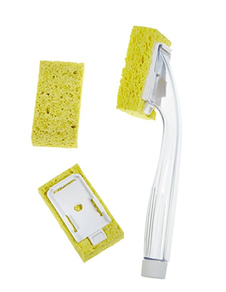

I was trying to think of some way to slowly introduce a defoaming agent directly into my waste tank if needed and was thinking of using a sponge, but then the sponge handle thingies made perfect sense.
I have knocked down porty tank foam with a quick shot of fabric softener before in a jam, I see no reason why it wouldn't work if it can be delivered slowly over time.
