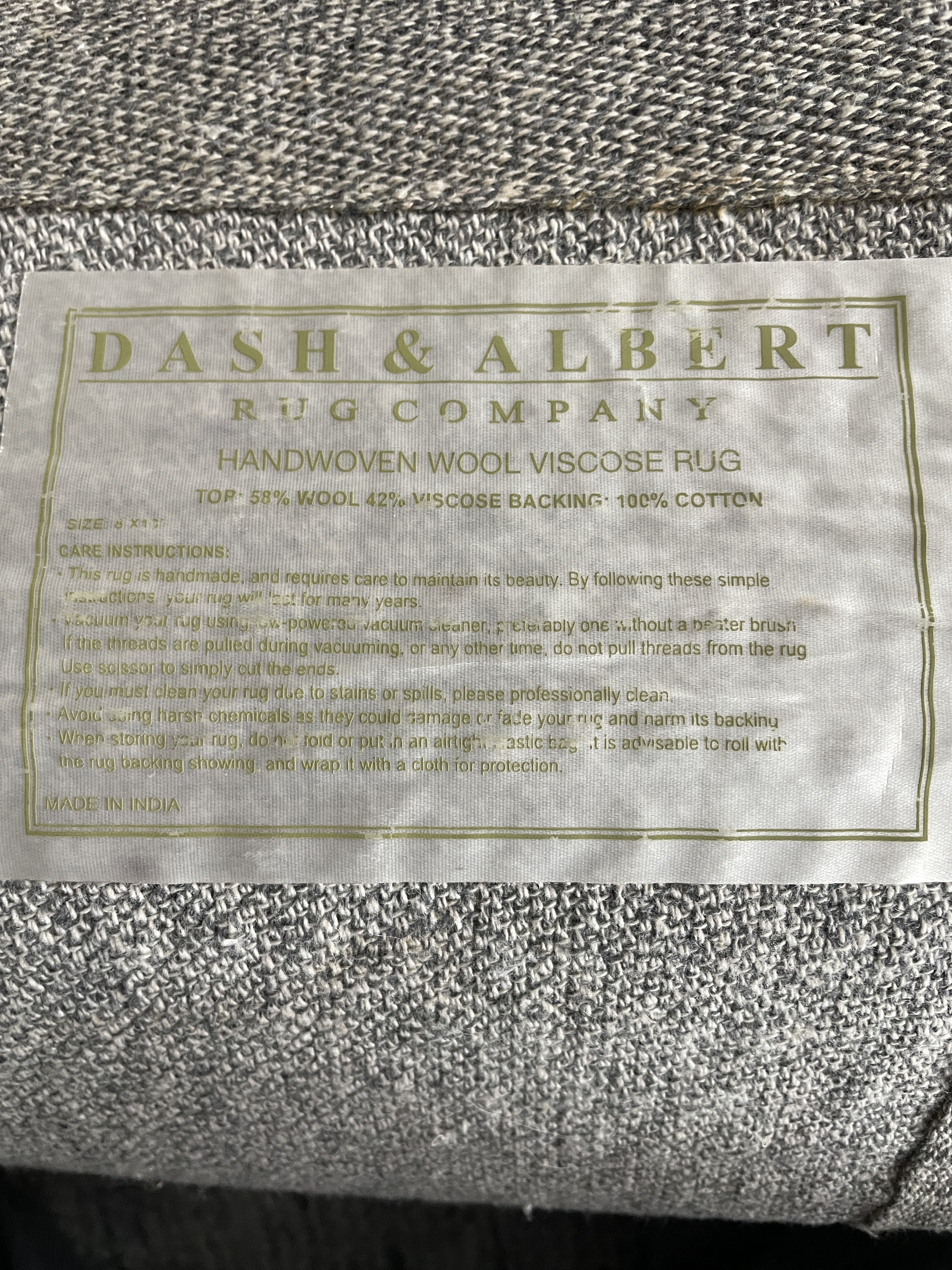

At least Annie Selke (Dash and Albert) warns people about what they're buying:
The delicate fibers of viscose-blend rugs are best suited for low-traffic, gently used rooms only. Not suitable for homes with children and pets.
On the website at least.
Mike J
Feb 21, 2022
1,326
East
Mike Joannides
Thanks, I didnt see that.

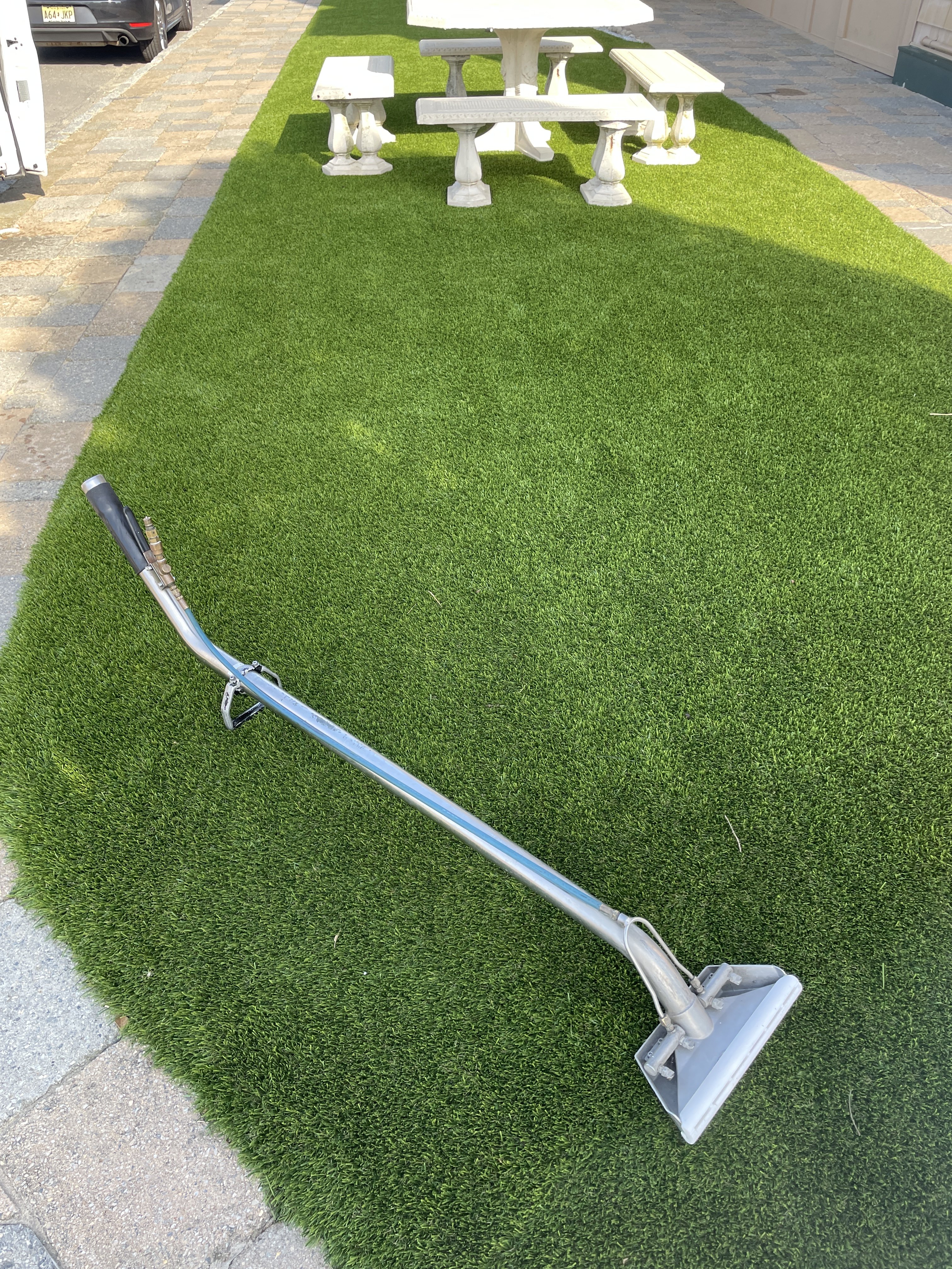

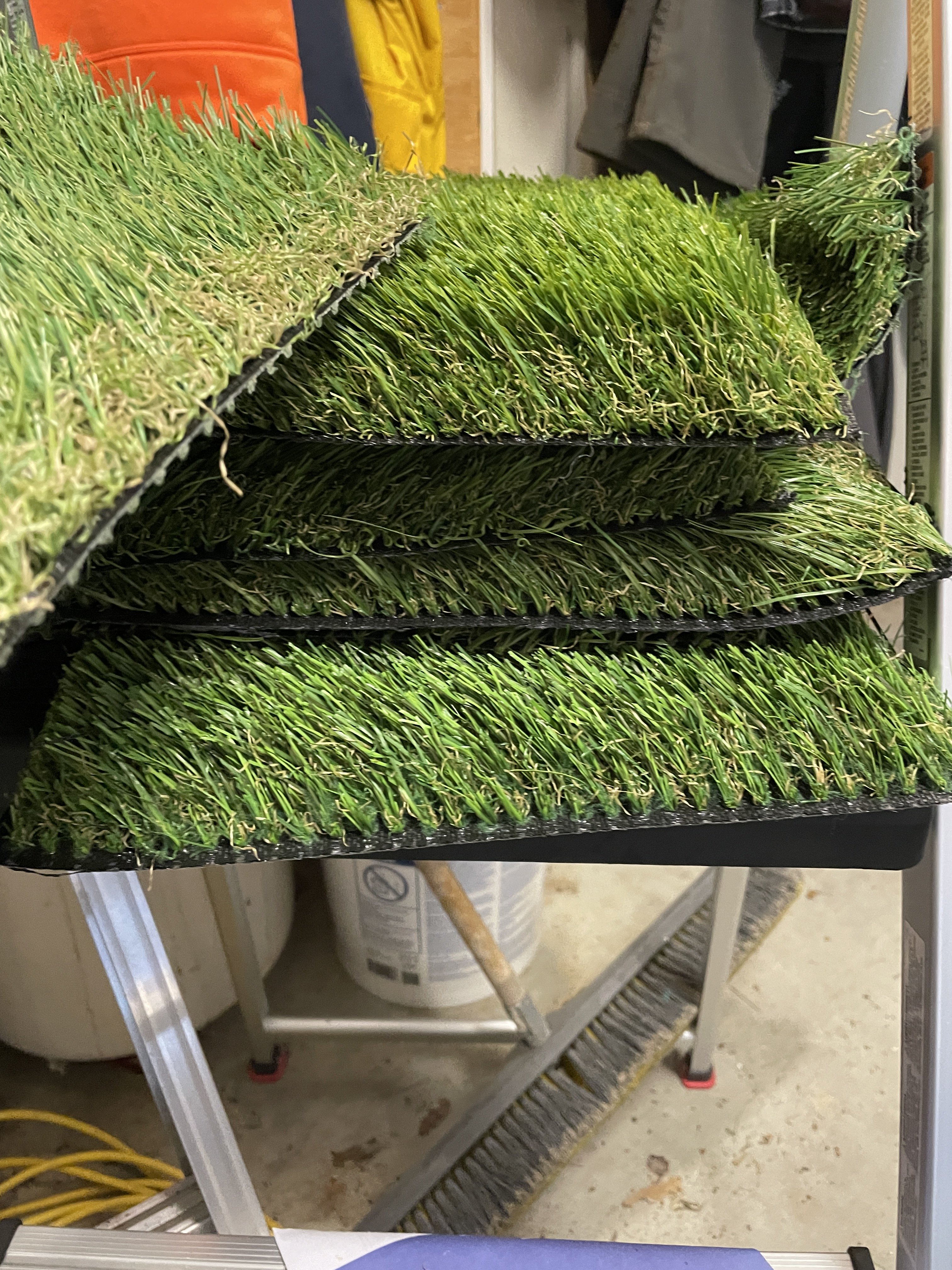

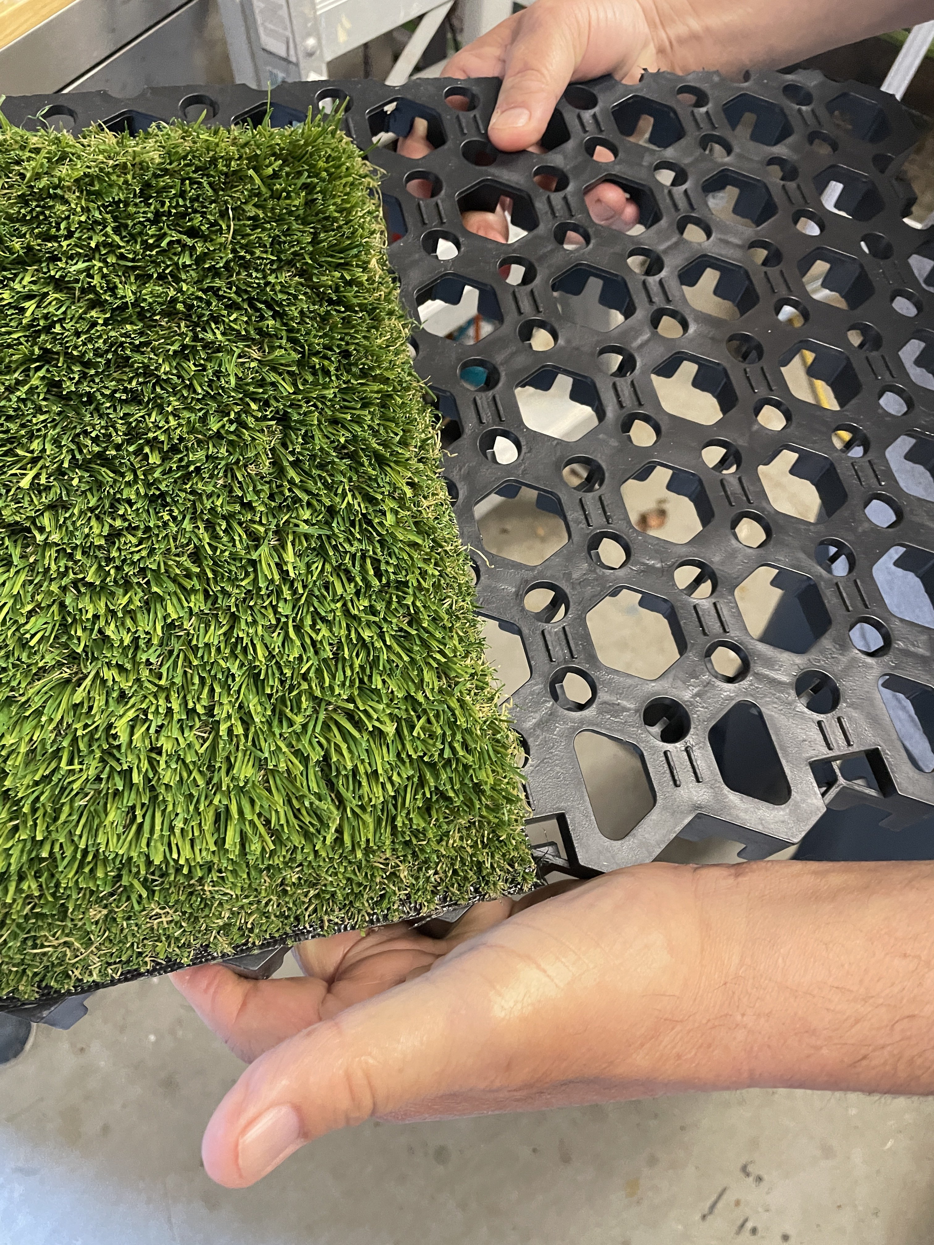

Funky grass too.
@ $16 to $20 per sq ft, I decided to go around it. Do not want racing stripes here.
