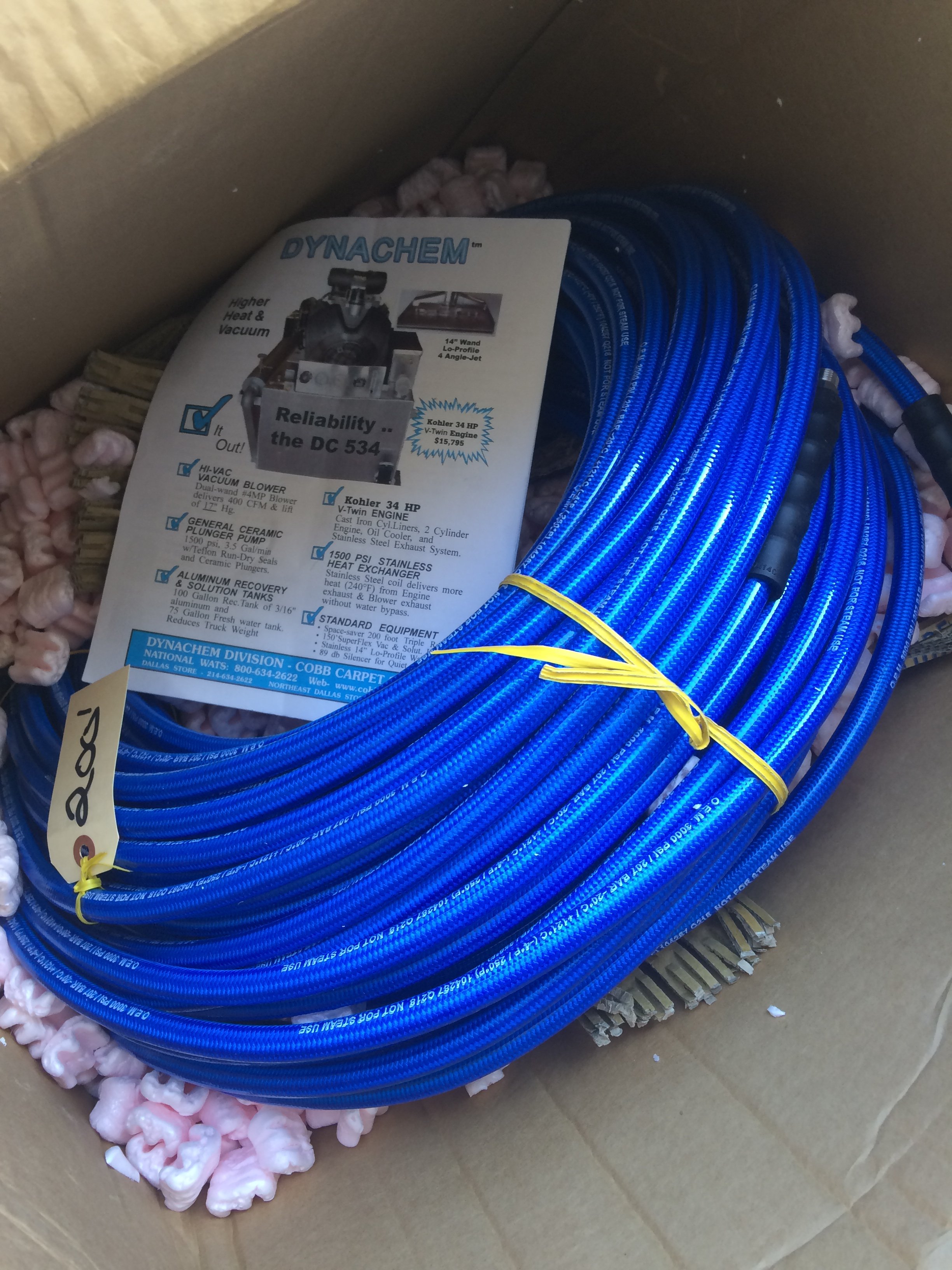

So I bought 300’ of the Cobbs thermoplastic hose.... let’s see how long this lasts... I usually only get around 6-8 months from Goodyear.

Lets me know how it is for memory. I hand coil my hoses. I'm thinking of ordering 150 ft or so. What was your cost delivered?

I’ll have to look at my CC statement, but I also had to pay UPS border fee. I’ll have to get back to you on the total.
Regarding the memory, I read on here, and also talked to a guy named Roger from Cobb, the first few times a guy uses it, it definitely sounds like it got some issues when coiling up. Which I was assured that would go away.
We will see...

The cobb hose(blue) has virtually no memory. It's also lighter than parker hose.
I'd highly recommend those using thermoplastic to use a 50' of steel braid off the truck or you will cook the hose.

The only thing I don't like about this newer hose is that it is sticky. Doesn't slide well over itself and I notice a little more drag on the carpet. Not a big deal.

It does grab corners more than I like. I’m considering getting a very high grit sandpaper on it to see if that would help.
