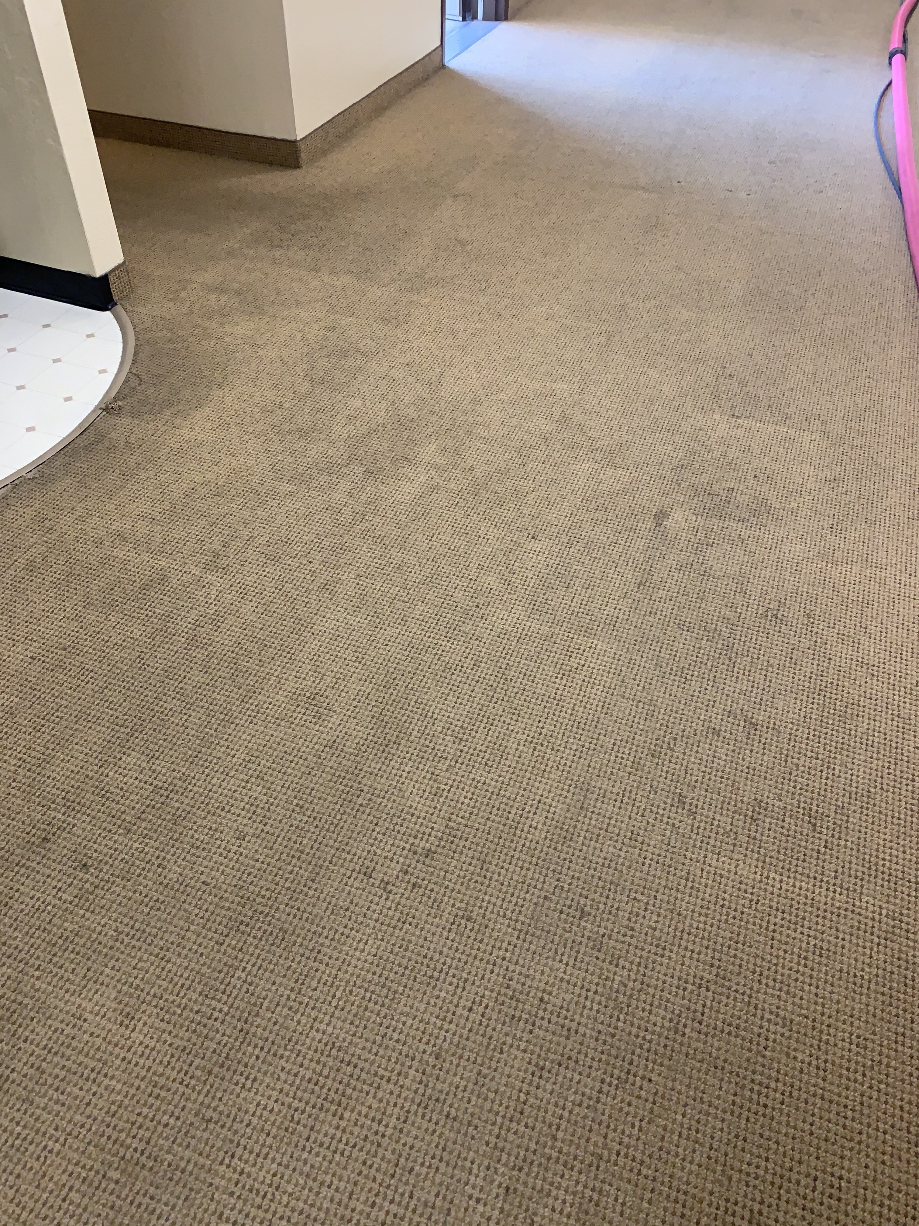

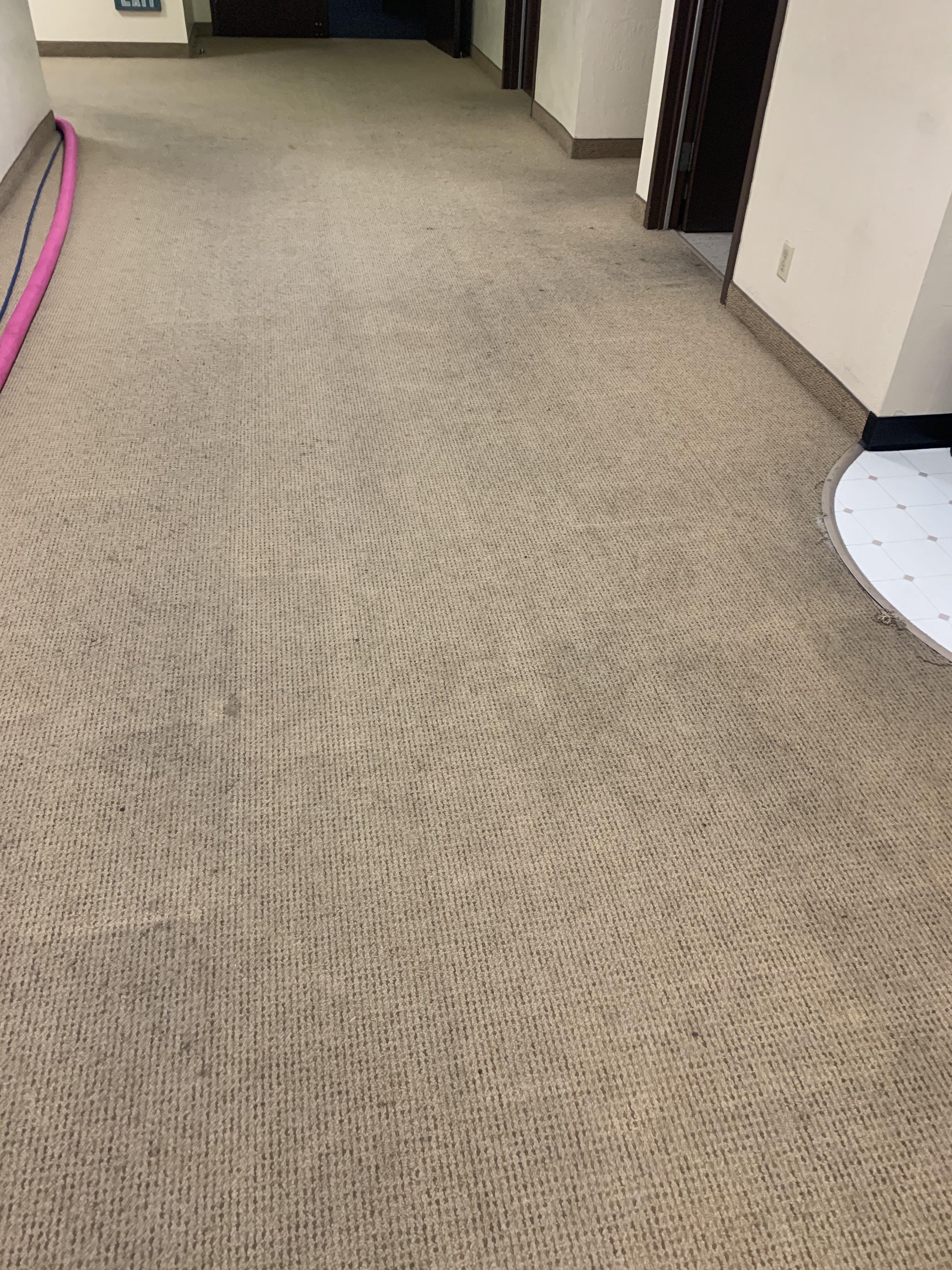

Jay Wags
I quoted this account two weeks ago they scheduled at the beginning of the week for us to come out didn’t think much of it
When I arrived I found out that it was just cleaned by the competition and they were unhappy with the work
My price was considerably more and the other guy promised the world
To be fair the carpet was darker and there were some large spots that are gone but obviously there is a lot of room for improvement
This group owns 20 properties in the area
Will update with pictures as we go!

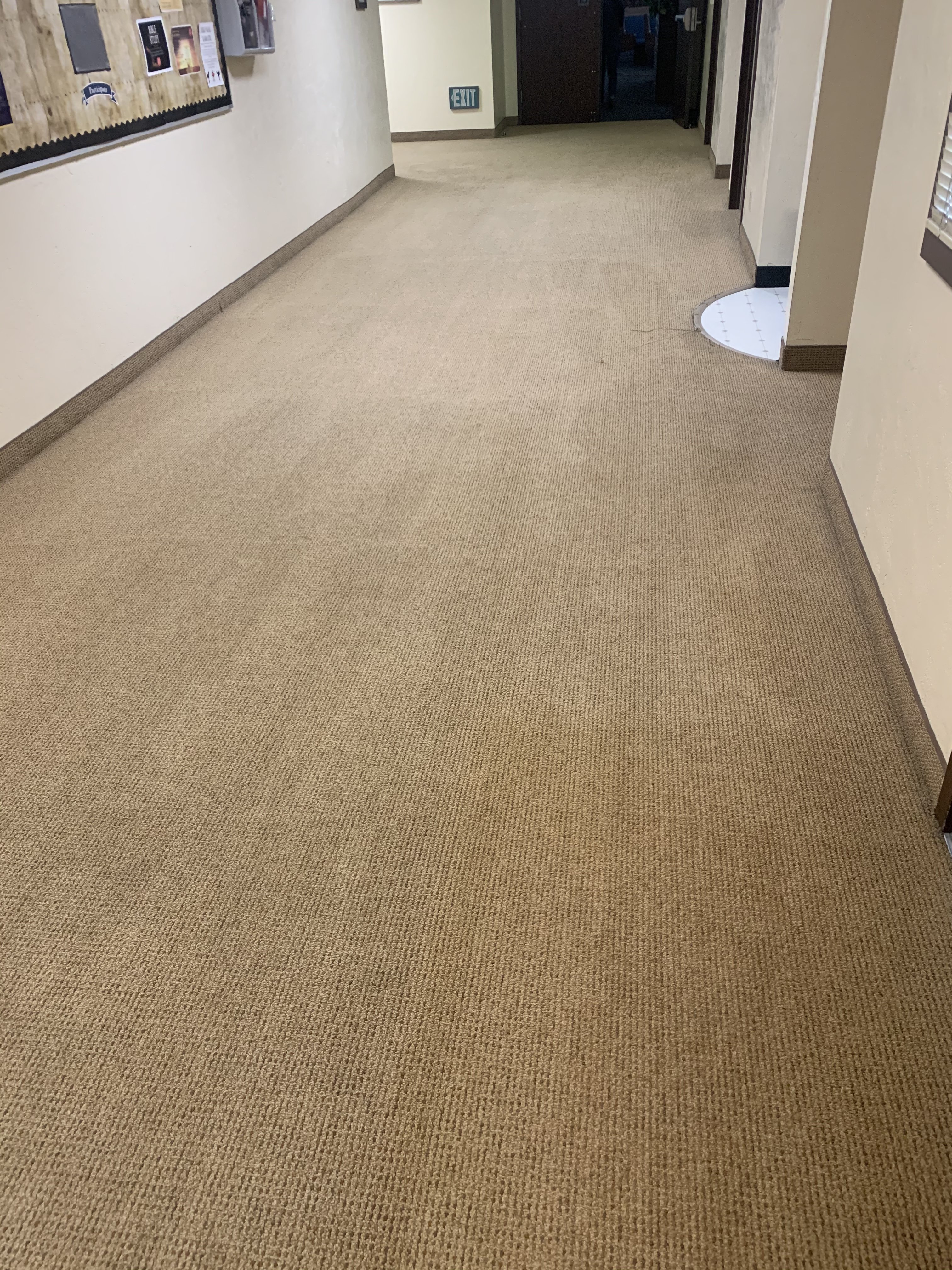

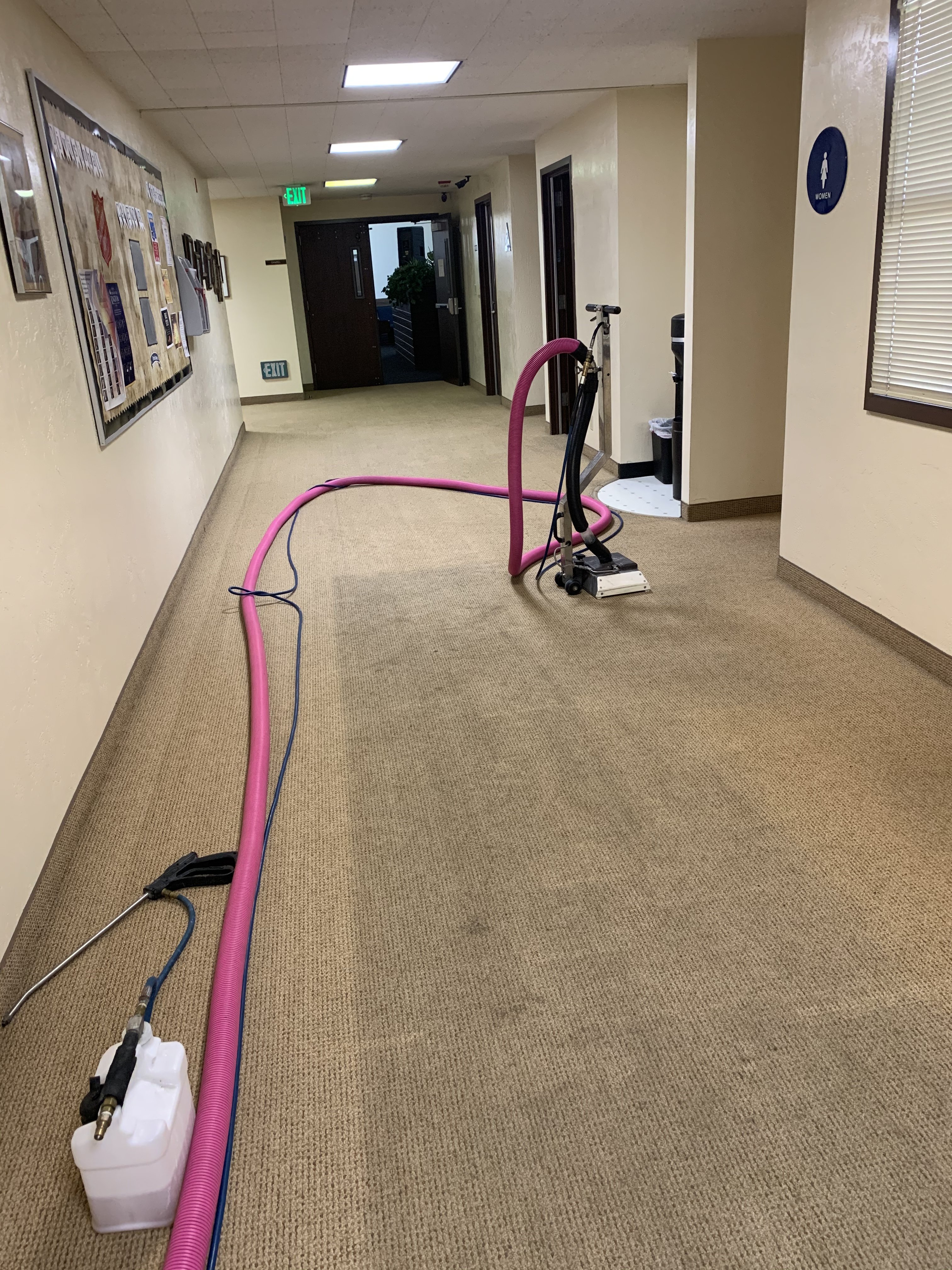

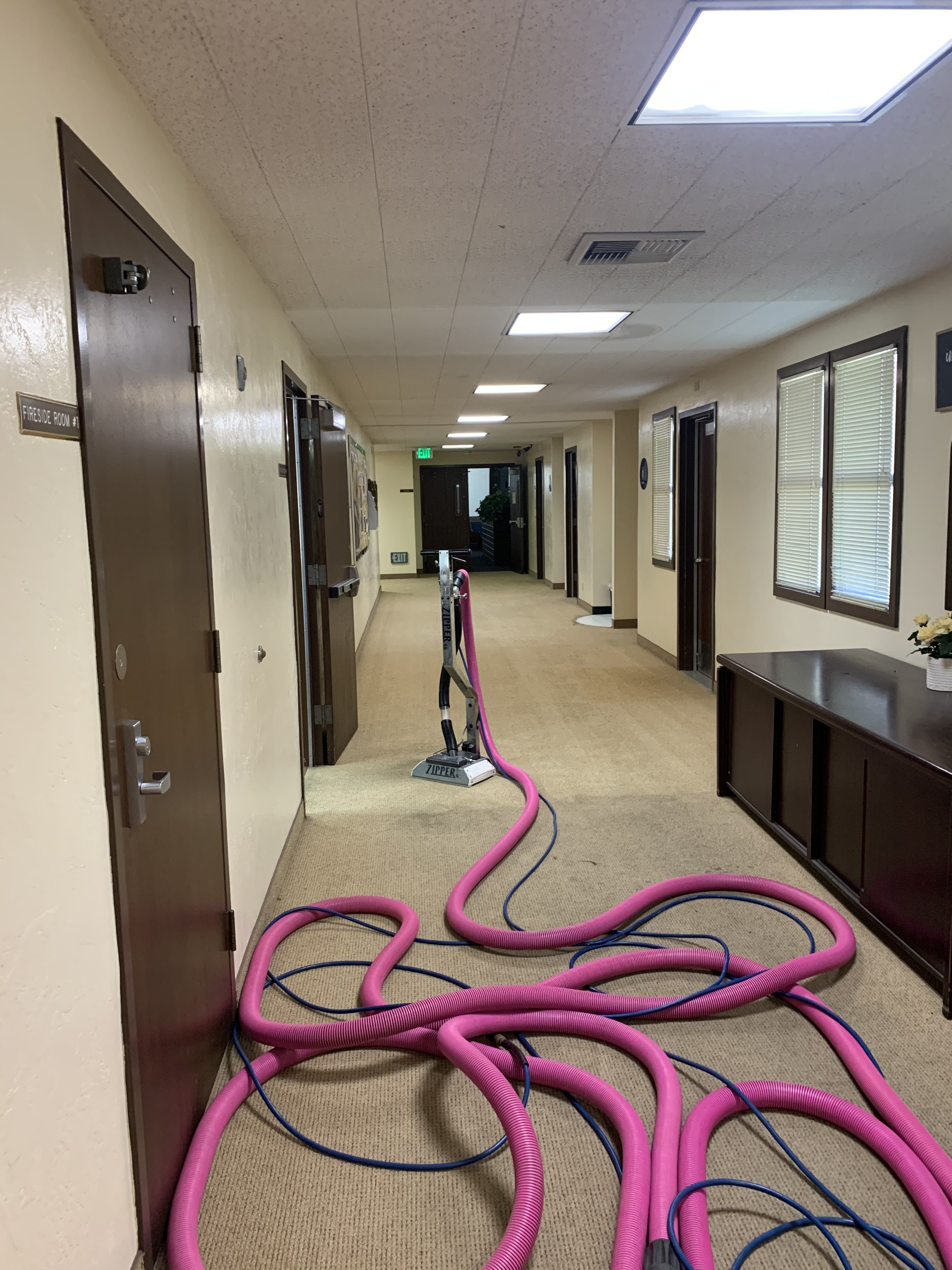

So much foam it’s crazy lol it’s moving slower than I would like
Probably need to post bonnet
Also everyone thinks they should be walking on it as I clean

Prep them for the likelihood that you will need to do a touch up. After it dries just a quick once over with encap on any recurring areas.
Exactly I scheduled them for a “low
Moisture post cleaning” in two weeks
I explained after the years of not cleaning and cleaning improperly we will need a few cleanings to get it back to being under control
Then we will clean less frequently

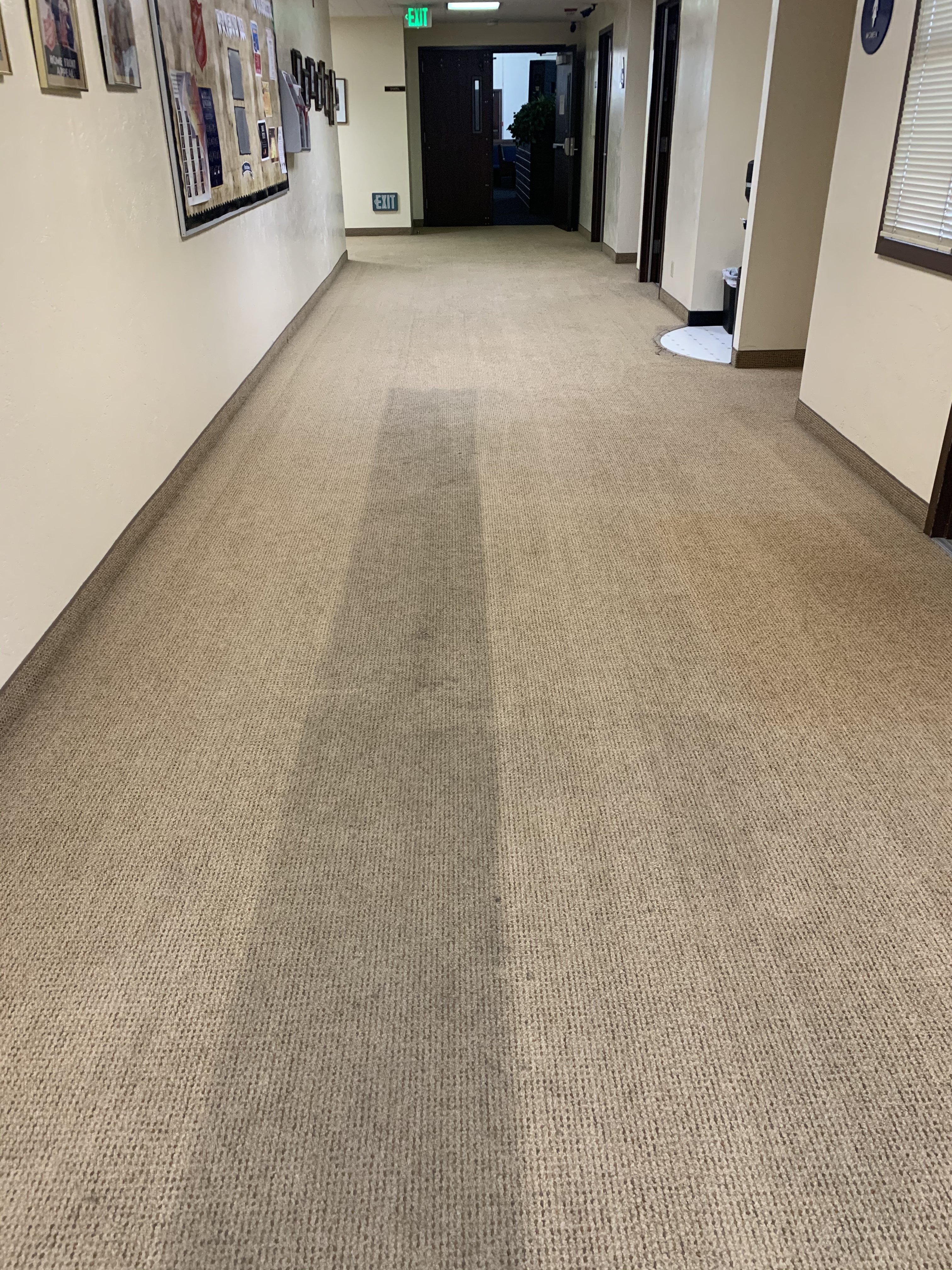

Honestly it’s better not 100
But better
They are blown away
