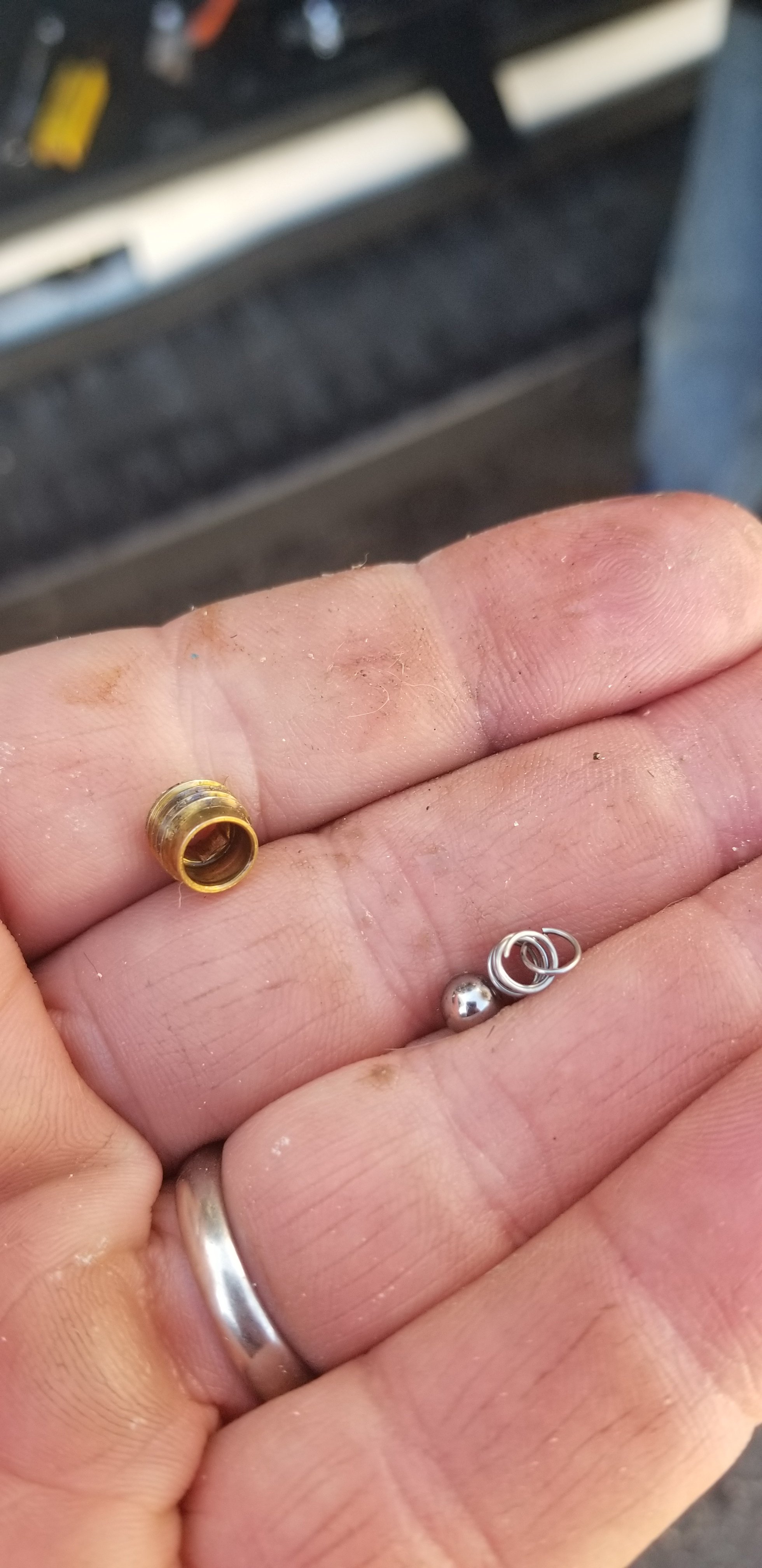

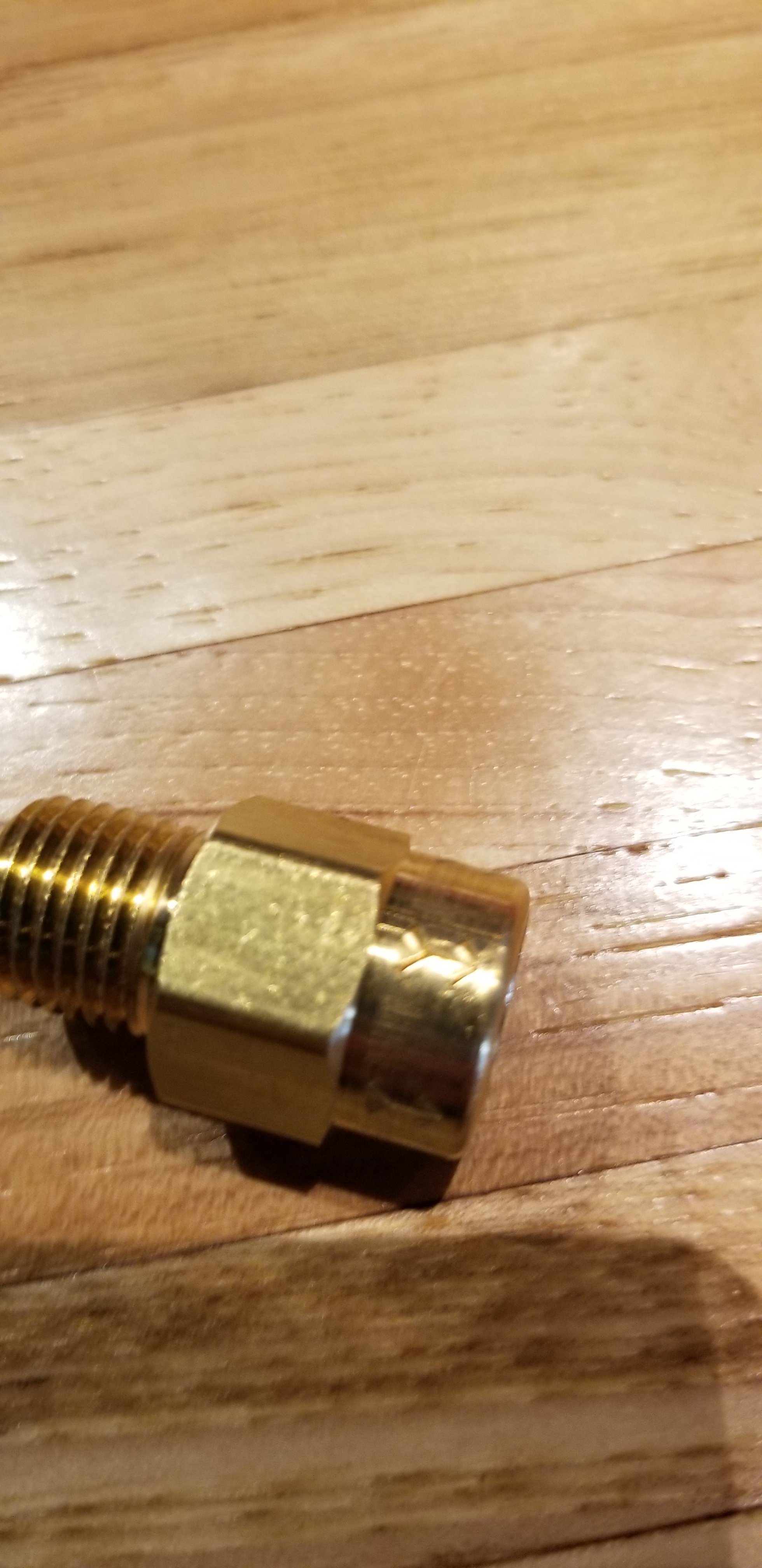

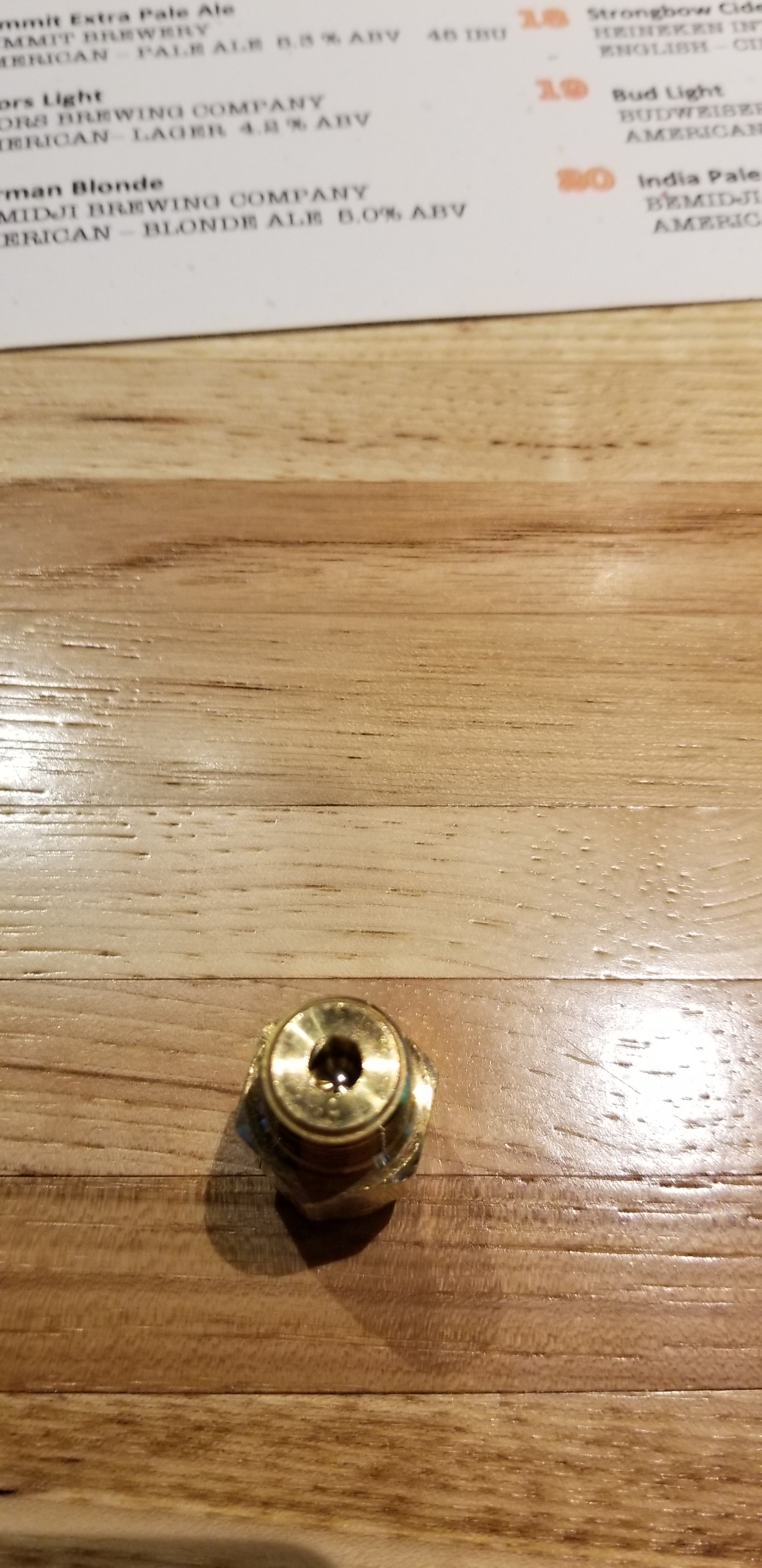

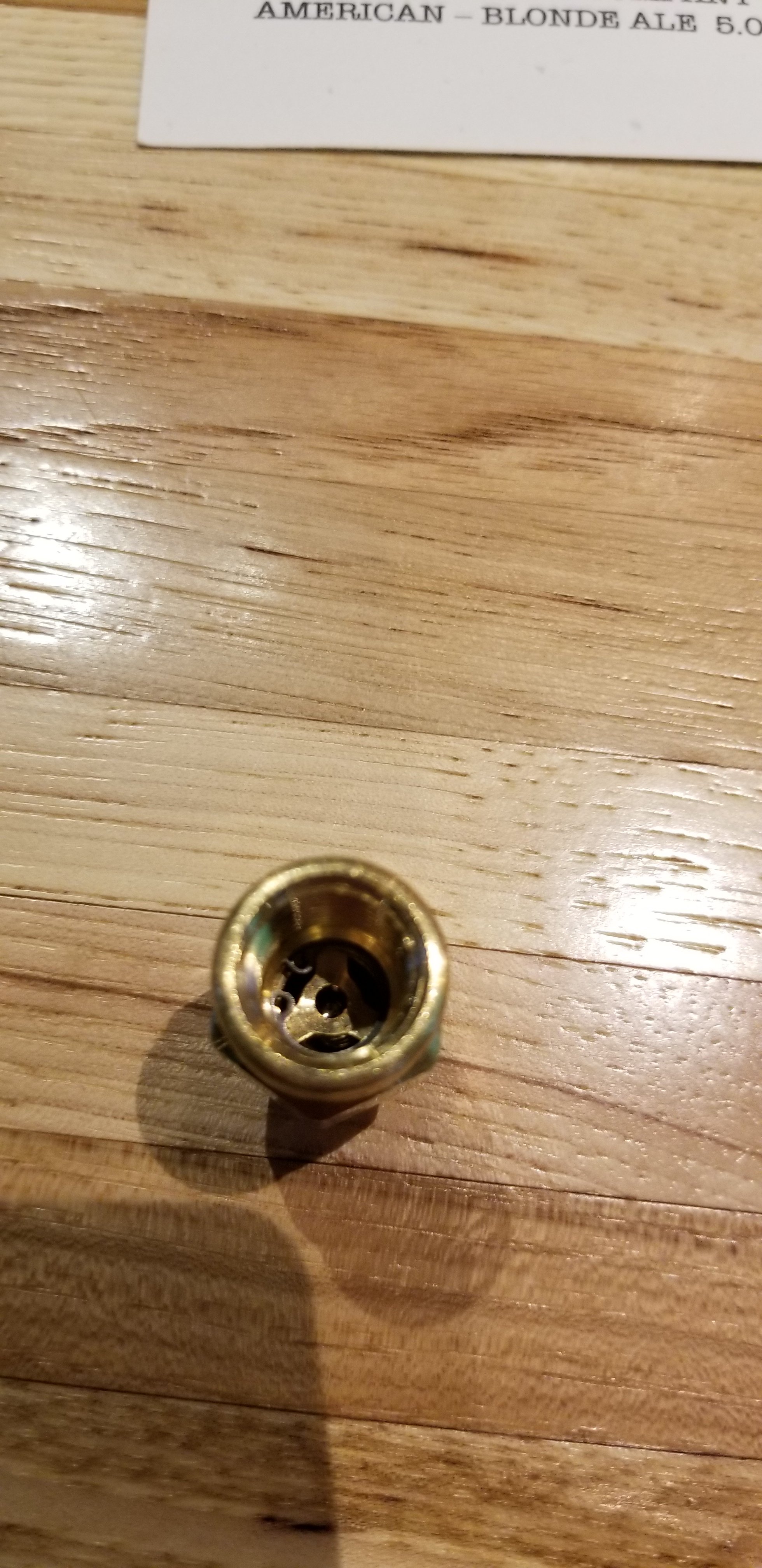

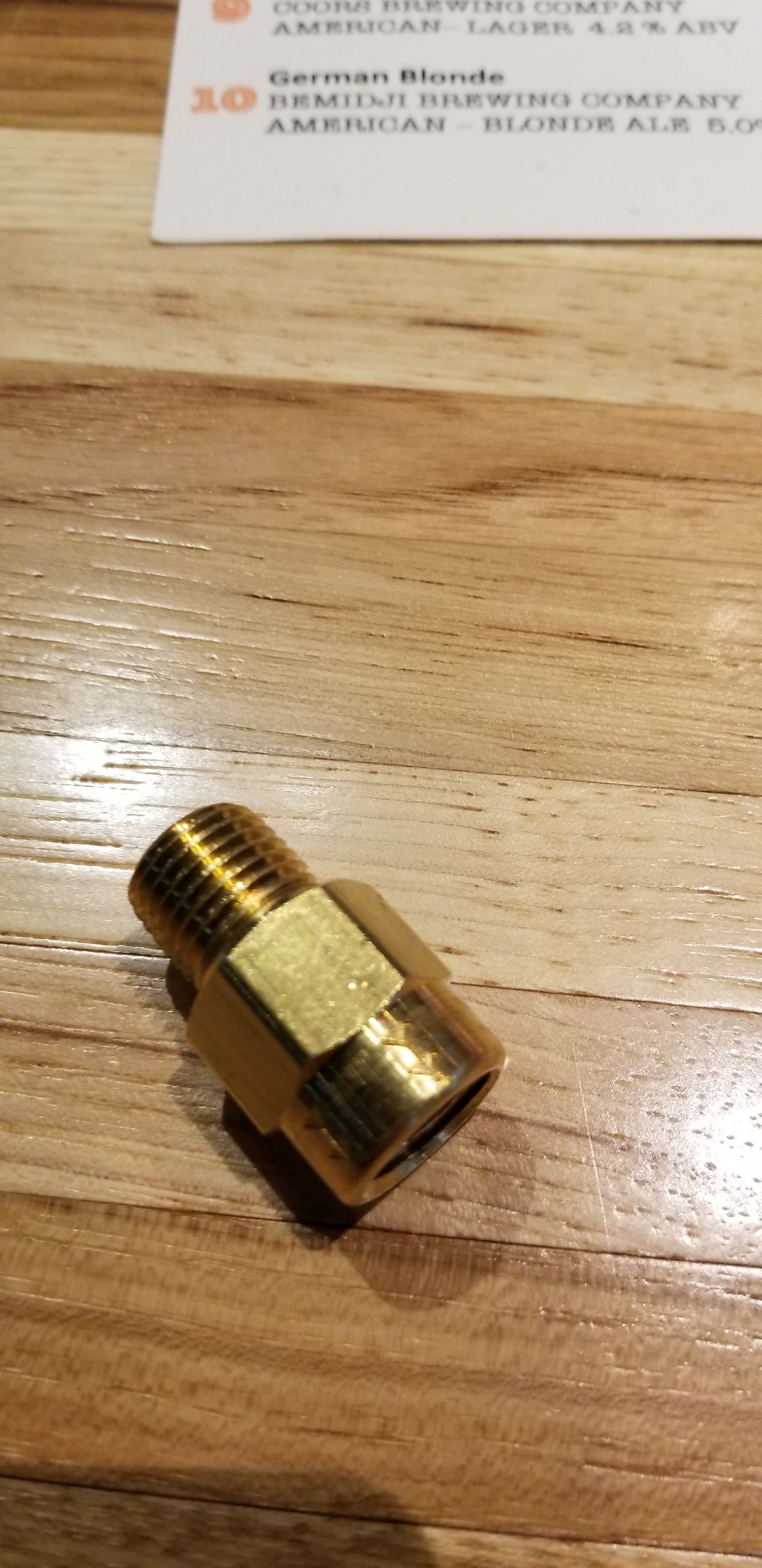

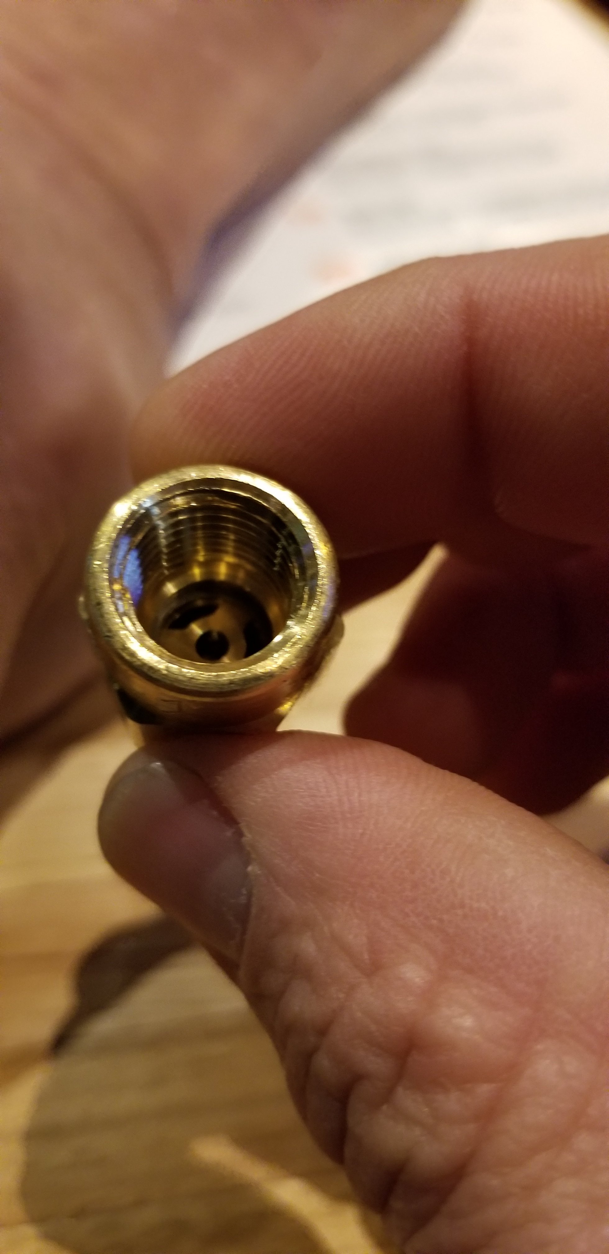

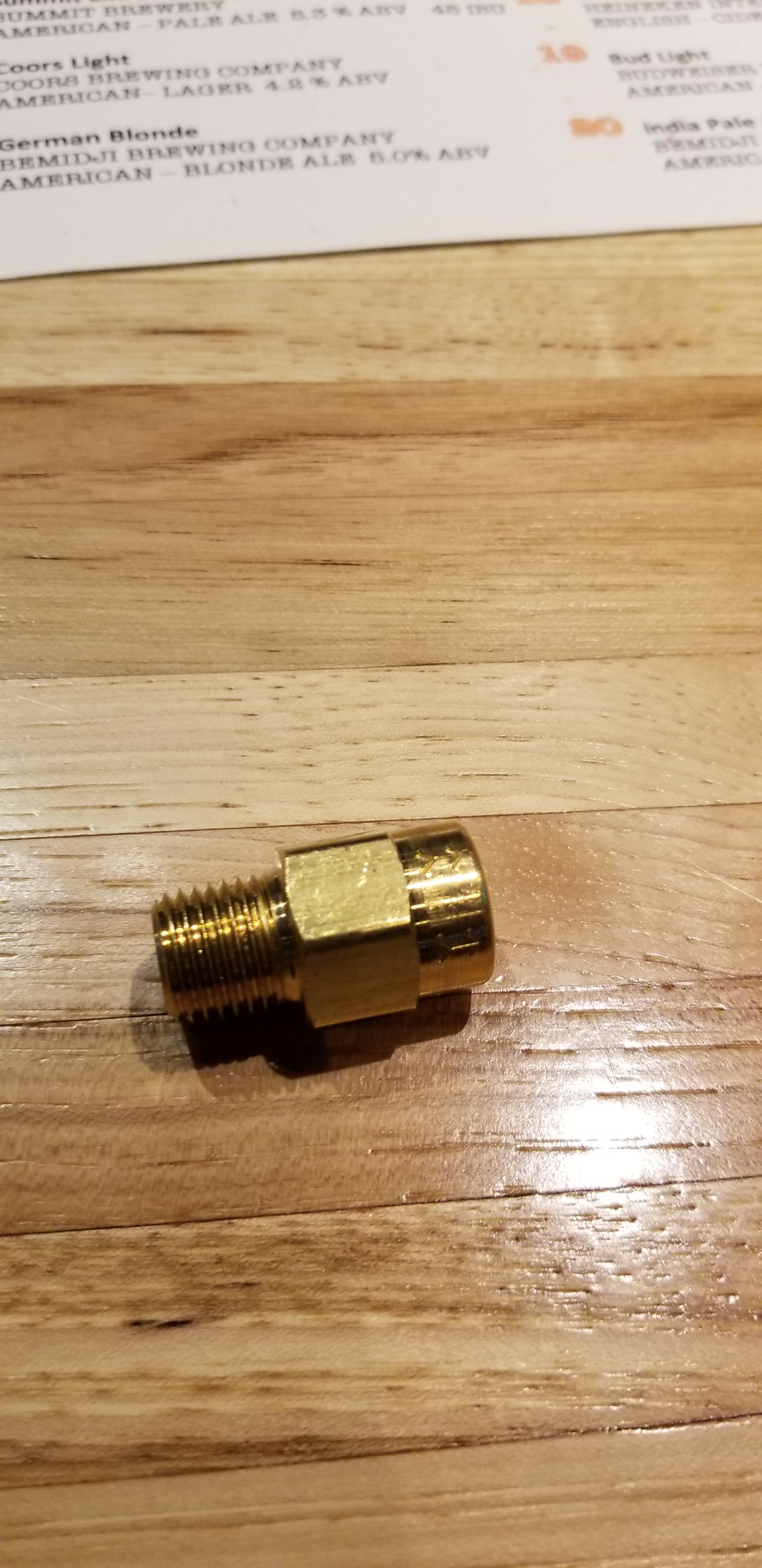

These damn things..
117,373
I give up..
28,280
I've taken all of mine out. Installed 100 mesh before the valve. Yes, the wand drips a bit but it's manageable.
