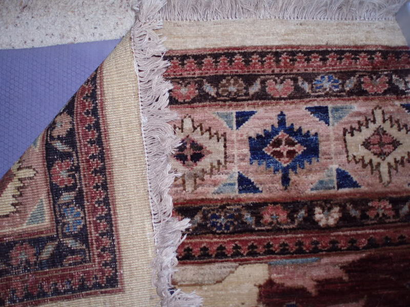

OK, Mikey
1. Probably Pakistan but much of the new stuff is being made in Afghanistan…. it looks like an a rug made by art resource. Colors, design, heavy chemical wash wet a corner it should feel slimy and smell like chemicals or vomit. These can be problem bleeders and a weird slurry of shit usually comes out of these in a wash

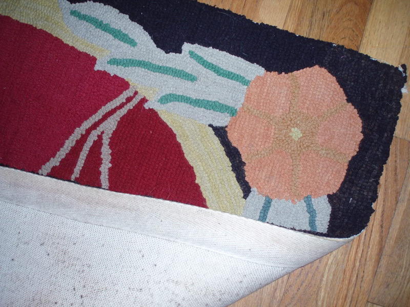

3. Hooked rug. If the binding on the side is a glued on separate piece of material it’s Indian. Cinese if folded over usually hand sewn sometimes glued One way to tell a tufted rug is from China or India.

Hooked rug. If the binding on the side is a glued on separate piece of material it’s Indian. Chinese if folded over usually hand sewn sometimes glued One way to tell a tufted rug is from China or India.
I sort of put that hooked up as a joke but damn if I didn't learn something to impress Mrs Piftleton.
