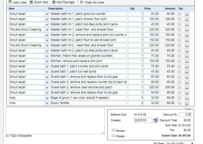

Working on tbe bid over breakfast on this grand day..

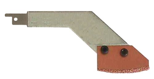

So how do you cut the bad grout out?

So how do you cut the bad grout out?. Box knife, many areas were filled with this crap..
I've used chisels when lots or all of the area need to come out, lightly tapping. There is a nice grout drill bit for a dremel tool that works well close to tiles. It's not super fast, but can work.

I was going to ask "$18k?..fo-reel
grout saw
need a short stroke sawzall with variable speed for best control
(like smaller Bosch, Millwaukie and Ridged )
otherwise, too easy to bugger up tile edges with large and long stroke saws
grout saw
18k?
