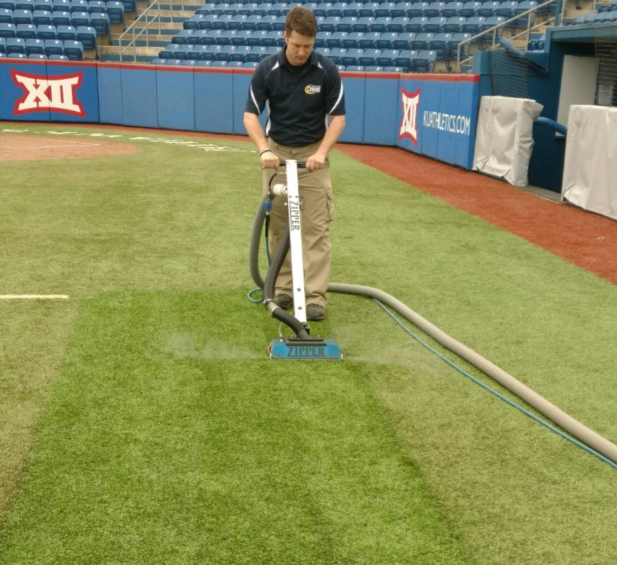

ZIPPER, not the spinner but standard.

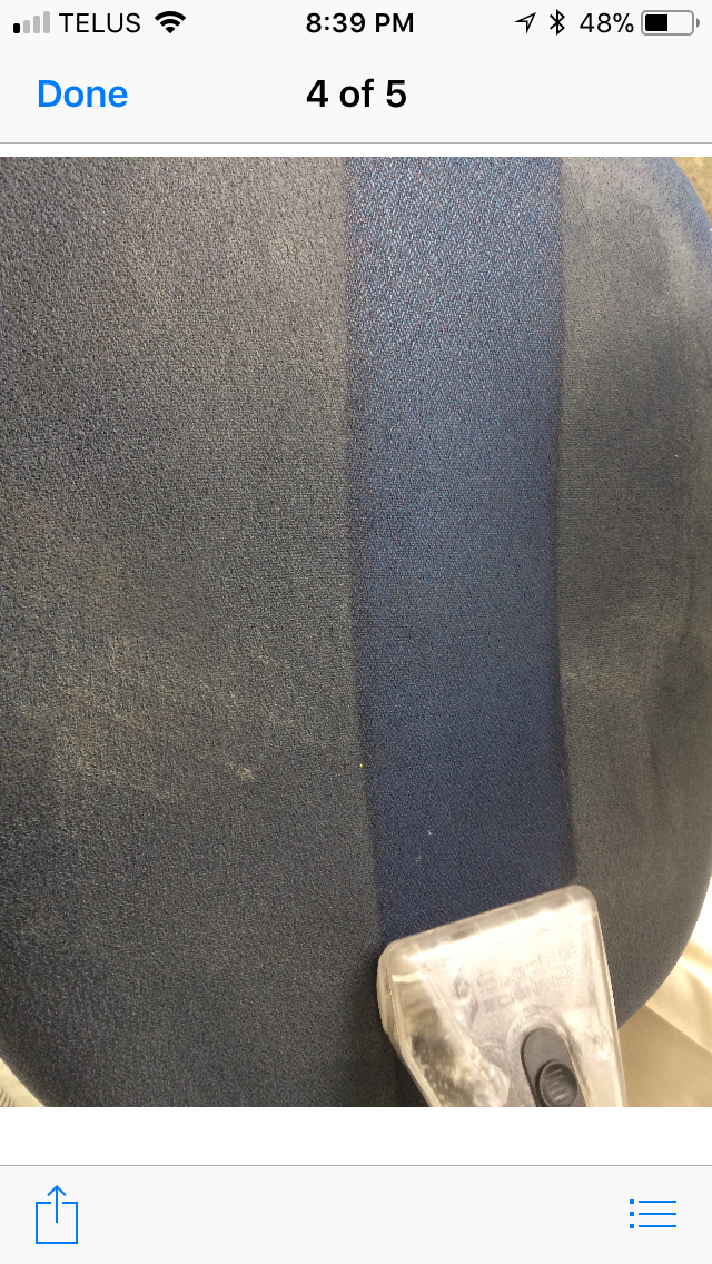

EXACTLY..... I do work for a large janitorial company. ALL the jobs they call me into to do, LOOK LIKE SHYTE.... they bonnet everthing. They use backpack vacs, no beater bar. When I vac, on average, I’ll go through 2-3 bags on a job. They soil load is UNREAL. After HWE, they still look like shyte, even after a 48 step Mikey special.... they left it too long....
