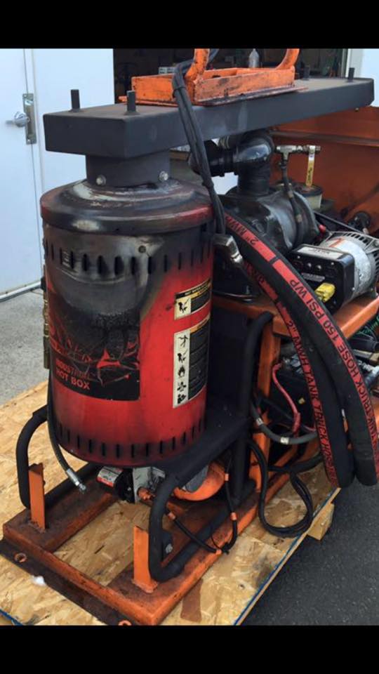

After going though my experiences with a Northstar, I would never let an employee run it alone. They put out the crazy heat, but you pay dearly for it in the long run.

Looks like that square exhaust did a very poor job of efficiently venting the hot exhaust away from the unit.
Knowing all too well myself the ridiculous amount of exhaust heat/force those things put out, I'm not surprised by the looks of it.
Surprised it did not melt a hole right through the top of it.
Very poor exhaust design for 350,00 fuel fired BTU's.
