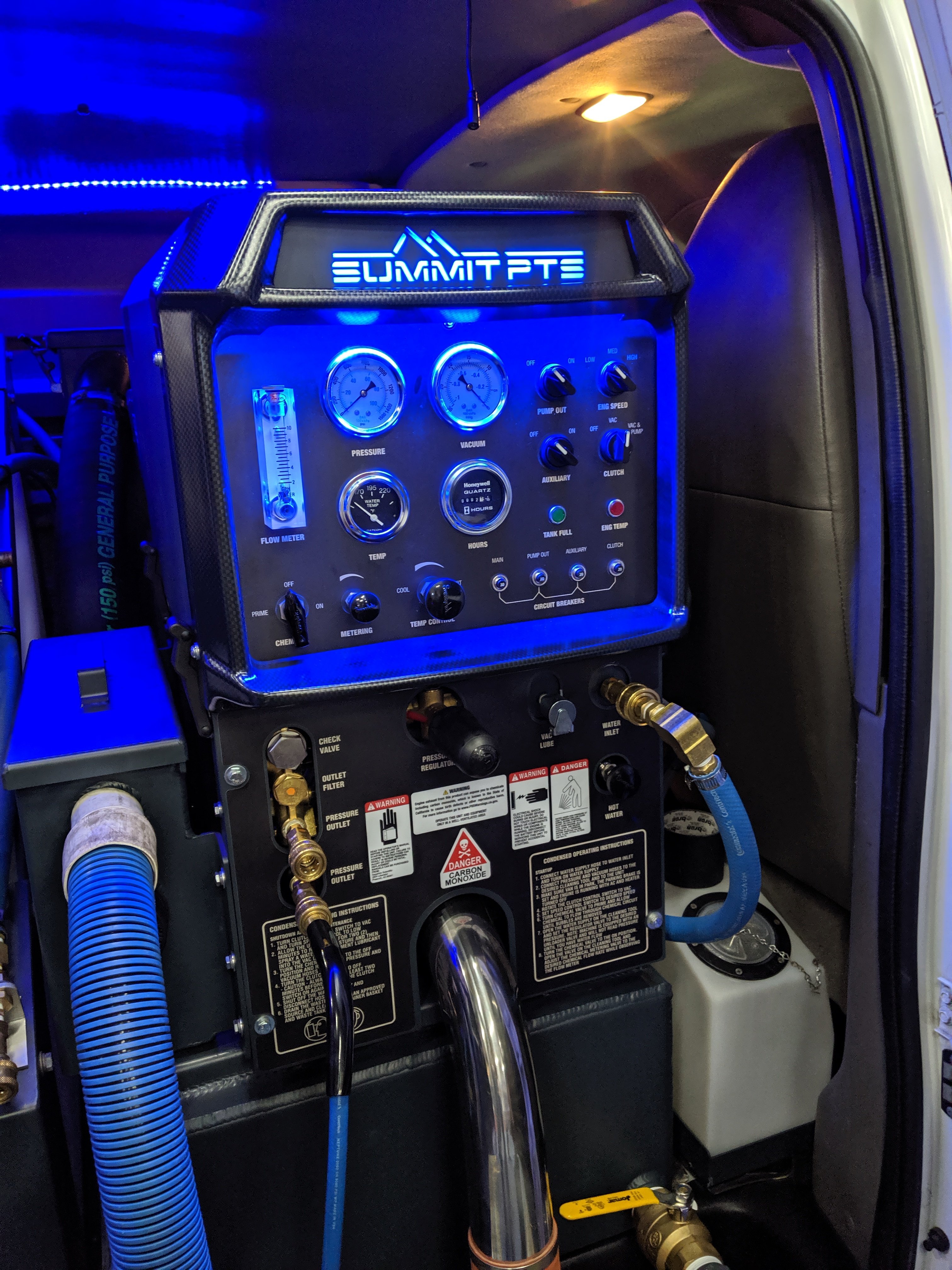

They should put a fresh water tank in place of the recovery tank. If you ever need to clean out the recovery tank now it would be near impossible to do a thorough job. With the stainless steel coolant heat exchangers you better make sure that your softner bottle is well charged or that thing will plug up fast, not a lot of room for ANY buildup between plates.

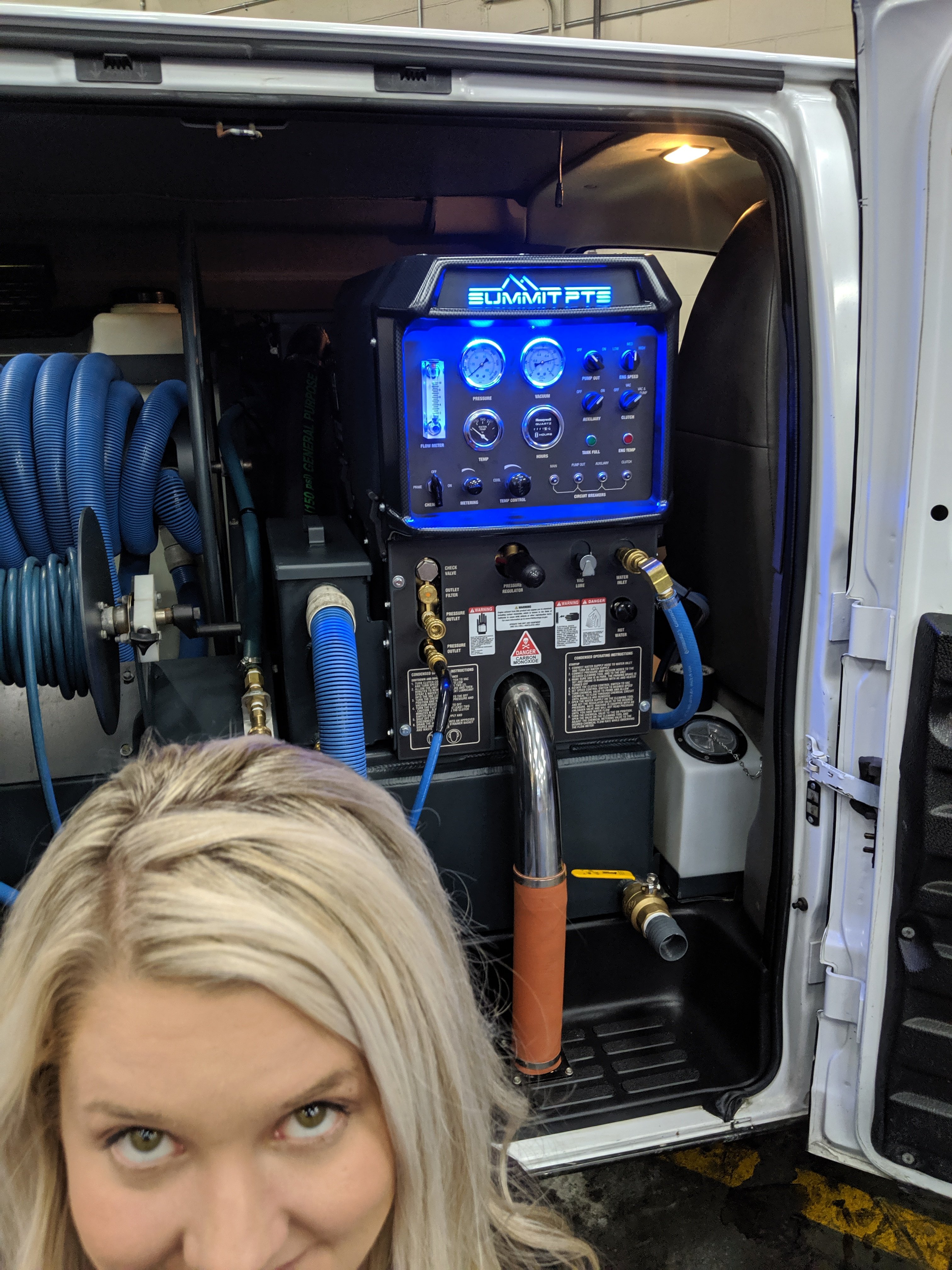

JHC... it’s like they are building TMs for women...
When Maria finally decided on the house she wanted by the beach, I was scouring through all the closed recent building permits, new roof, heat/air system, siding , radon inspection, electrical etc...
She was sold on the new LED recessed lighting throughout, NEST climate automation and under counter lights
Pretty is one thing... but make DAMN sure she’s a runner!

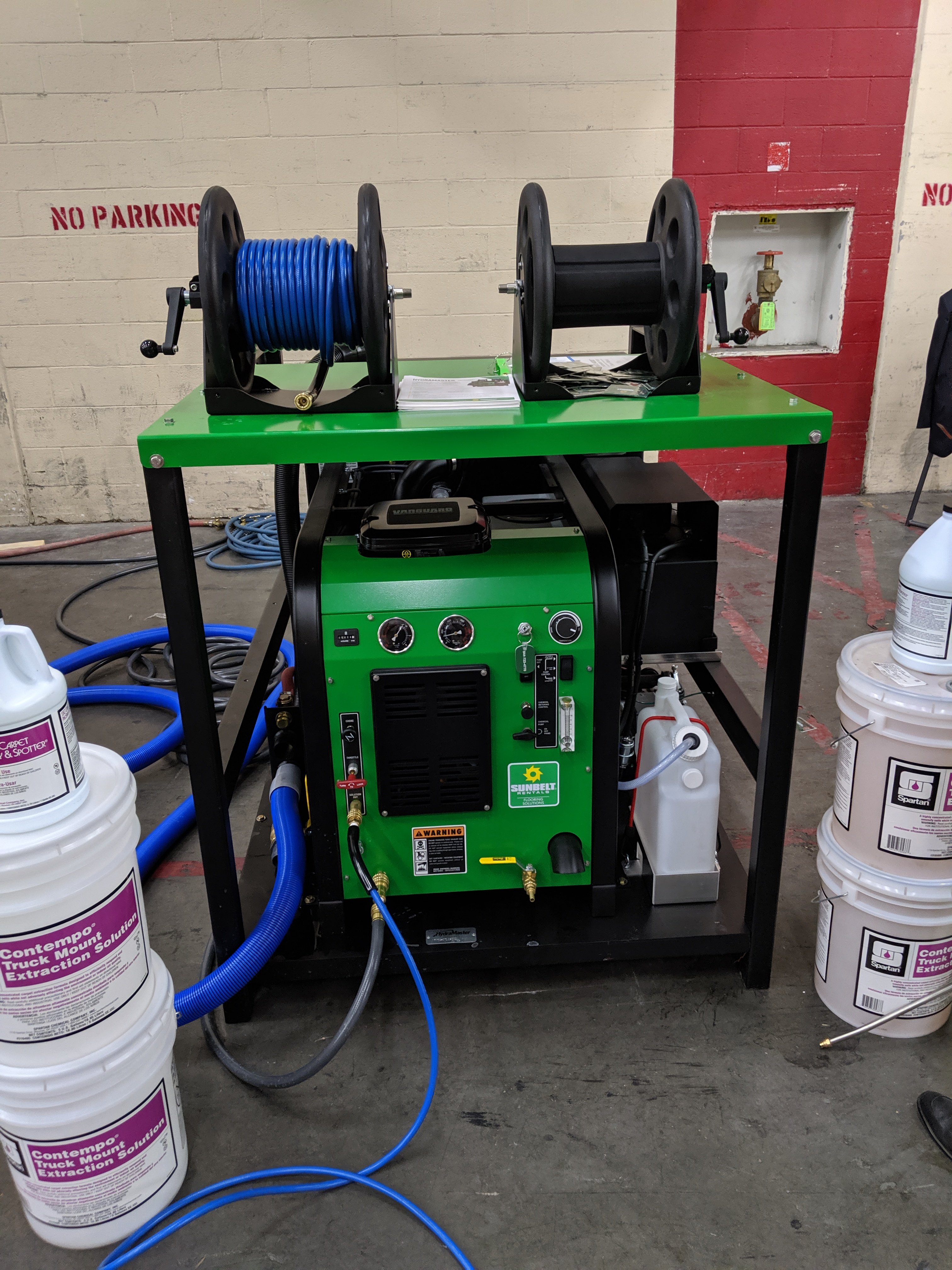

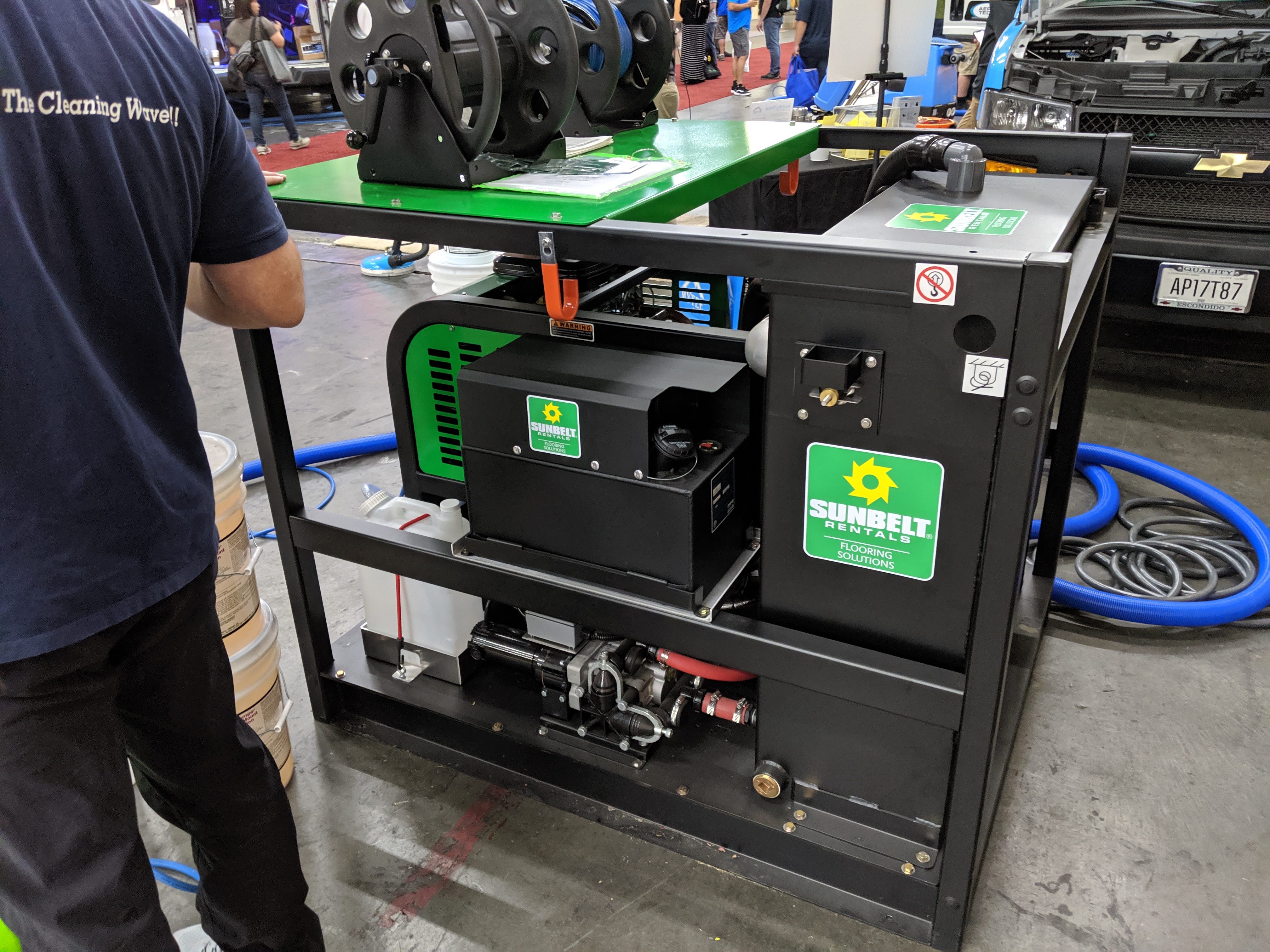

Oh good, now testosterone driven individuals can rent a slide in from Sun Belt.
Great!
Considering the secondary market all the little Bissells machines created for correcting soil saturated carpets.
With that rental in those hands, the sky may be the limit.
