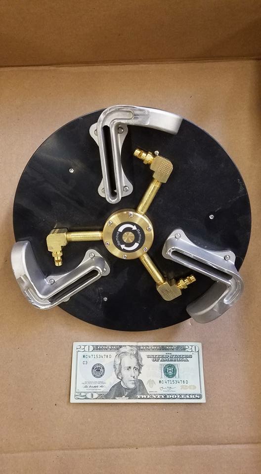

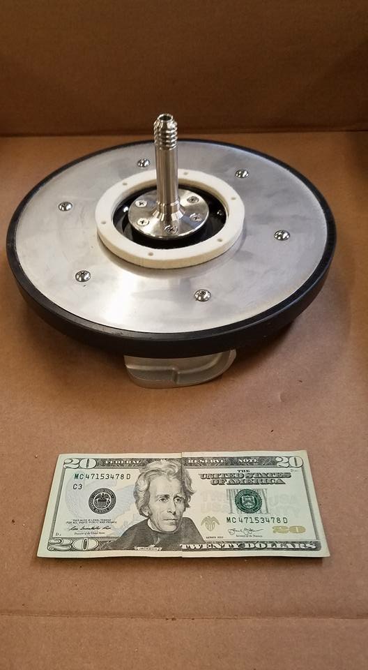

So today Rotovac has launched a new 10” cleaning head for 360 and 360i. It delivers better performance than standard heads on troublesome jobs. Also suits stair cleaning. $395 and available now.

how is a 10" round head good for stair cleaning?
what do you do?
change tools for corners, bull nose and risers?
or just skip them?
...not to mention being a 40 pound rotary machine on steps being an accident waiting to happen....
did you make up the "suitable for stairs" on your own?

Why would that perform better than the stock 3 port head?
Well. My best performing tool is my upholstery tool. Why?
All the power and heat inside such a confined space. So the smaller we go, to more we confine our forces.

What I did was..
Left the telescoping handles very short. Lay the machine out flat. Removed the plastic dome. Reinstalled the carry handle.
Sprayed stairs with HF coming down. Wanded risers going up. Put 360i on and cleanes treads coming down (machive was at the top of the stairs).
It was pretty quick as risers aren’t typically dirty. The treads were realky filthy it saved time and sweat.
I think my new wand will be better for tgis task.
With the machine is so short; it was easy to slide my hands down the frame and lift the unit down to the nexr step
Wanding is tiring, machining generally isn’t.

I have 2 RVStairPros dedicated for stair cleaning. They use the 7" cleaning heads. I have extra cleaning heads choked down to 1 jet each, jet sizing .05/1.0/1.5/2.0/ &3.0 set up and interchangeable in seconds to meet most cleaning challenges.
I can contour right over the bull nosing to clean, then cuff them. Really soiled nosing, I break out the Kleenright hand piece to flush sideways, and do risers.
That cleaning head as pictured would not be capable of cleaning over the nosing as it does not have the ss 'puck' that fits to the distribution chamber.
Hopefully the production heads will come with the puck installed.
