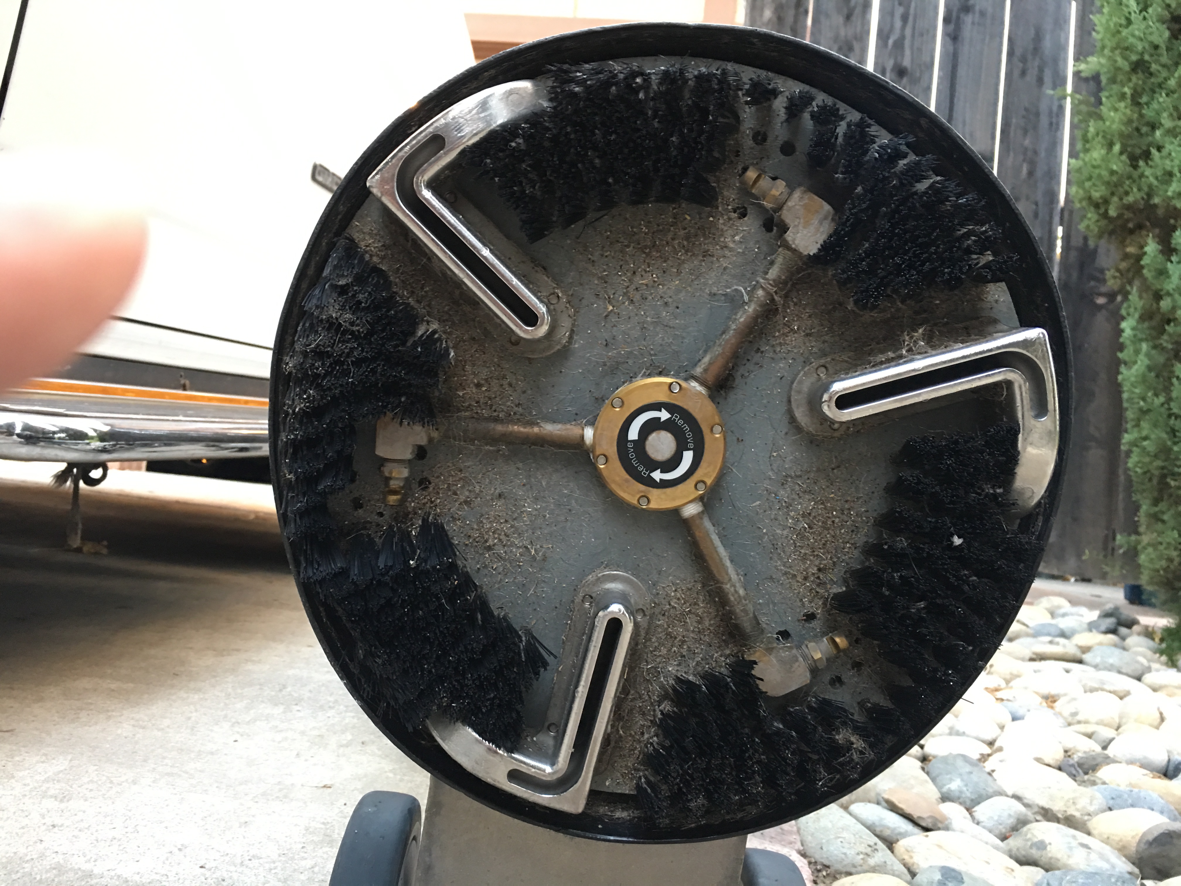

Thanks for these pictures. It helps. Hope it works well for you.
I think I would prefer the jets be placed closer to the swoop side of the vacuum ports so the spray would be picked up sooner in each revolution. It looks like you may have changed the jet position from what you started with as the jets looked like they were previously more centered between the vacuum slots. If anything, rather than the jets center spaced, I would have cheated closer to the swoop side of the slot.

This is what my redesigned brush head looks like after a couple jobs. Seems to work as intended.
One thing that I would speculate on since I’m not familiar with the Junior is that the brush on the 360i seems more substantial. Tufts look larger and seem to be closer together, giving more support and brushing surface.
