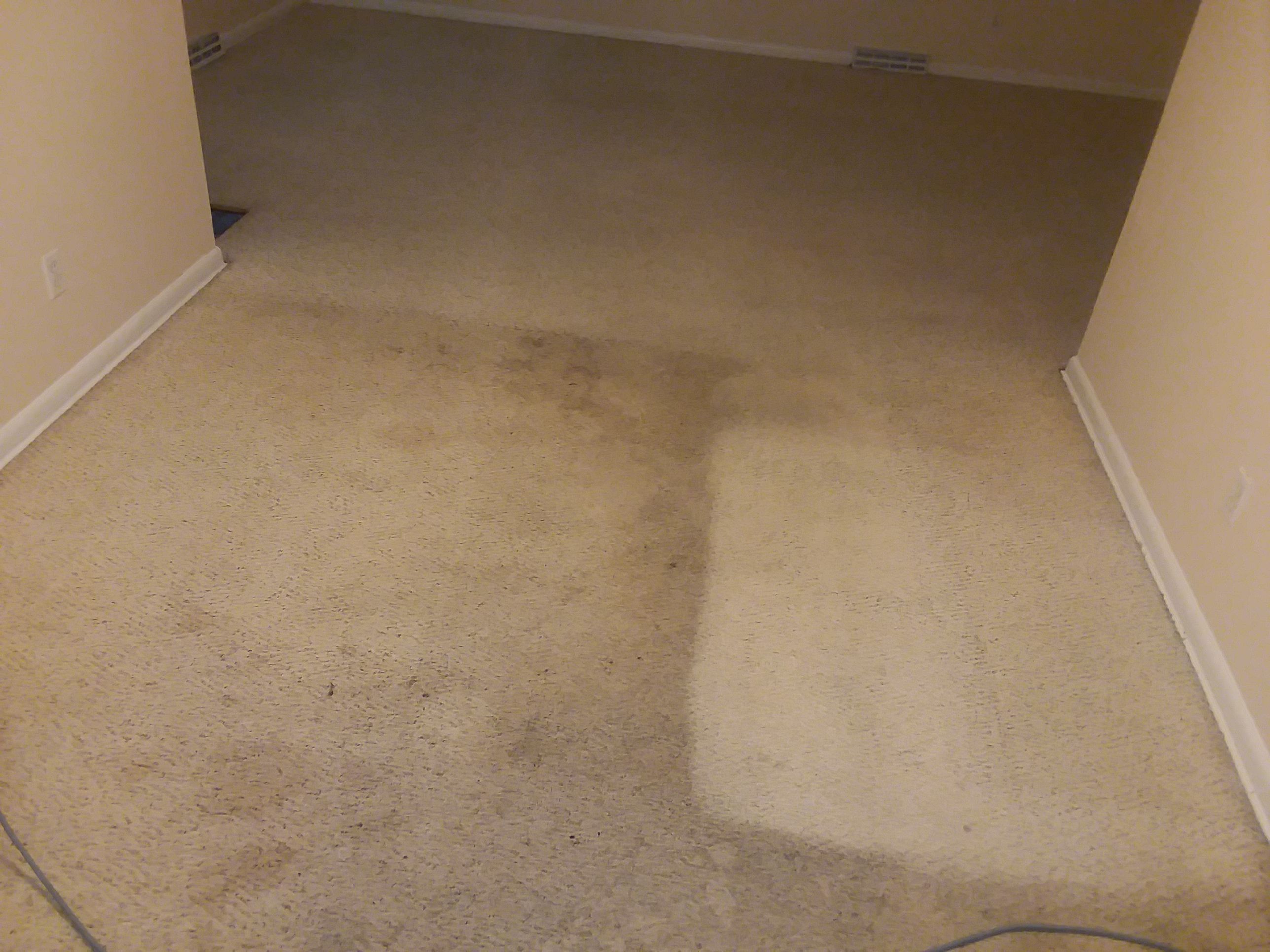

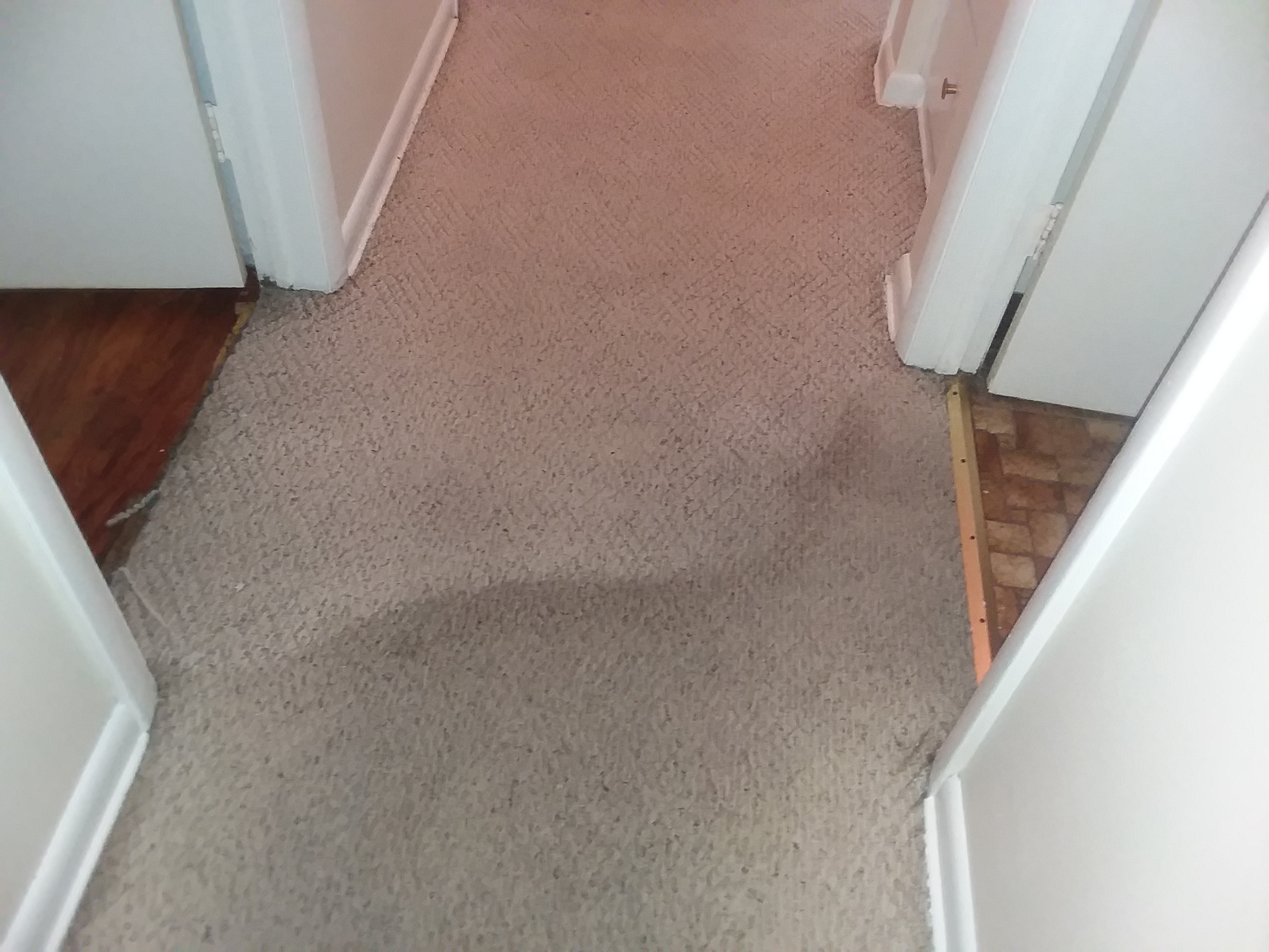

Used it again. I will admit, I was tempted to scrub and run. !! Absolutely trashed olefin berber.
Scrubbed with 175, mixed stronger than directed. Because I wanted to make it foam up and stay in the fibers. Was also temped to boost with something /anything as we carpet cleaners are wont to do!! ( But I did not)
Pics are of scrubbing, tank shower feed through a green pad.
Besides, it smelled sooo good. hated to flush it away!!
Rinsed with an encap product. Pics are of scub only, before rinsing.
The jar I bought, not a FREEBIE!!!! :winky::winky:
Also, just recently figured out how to post a picture. ( I am old and never make myself look into it!)
View attachment 86042View attachment 86043
