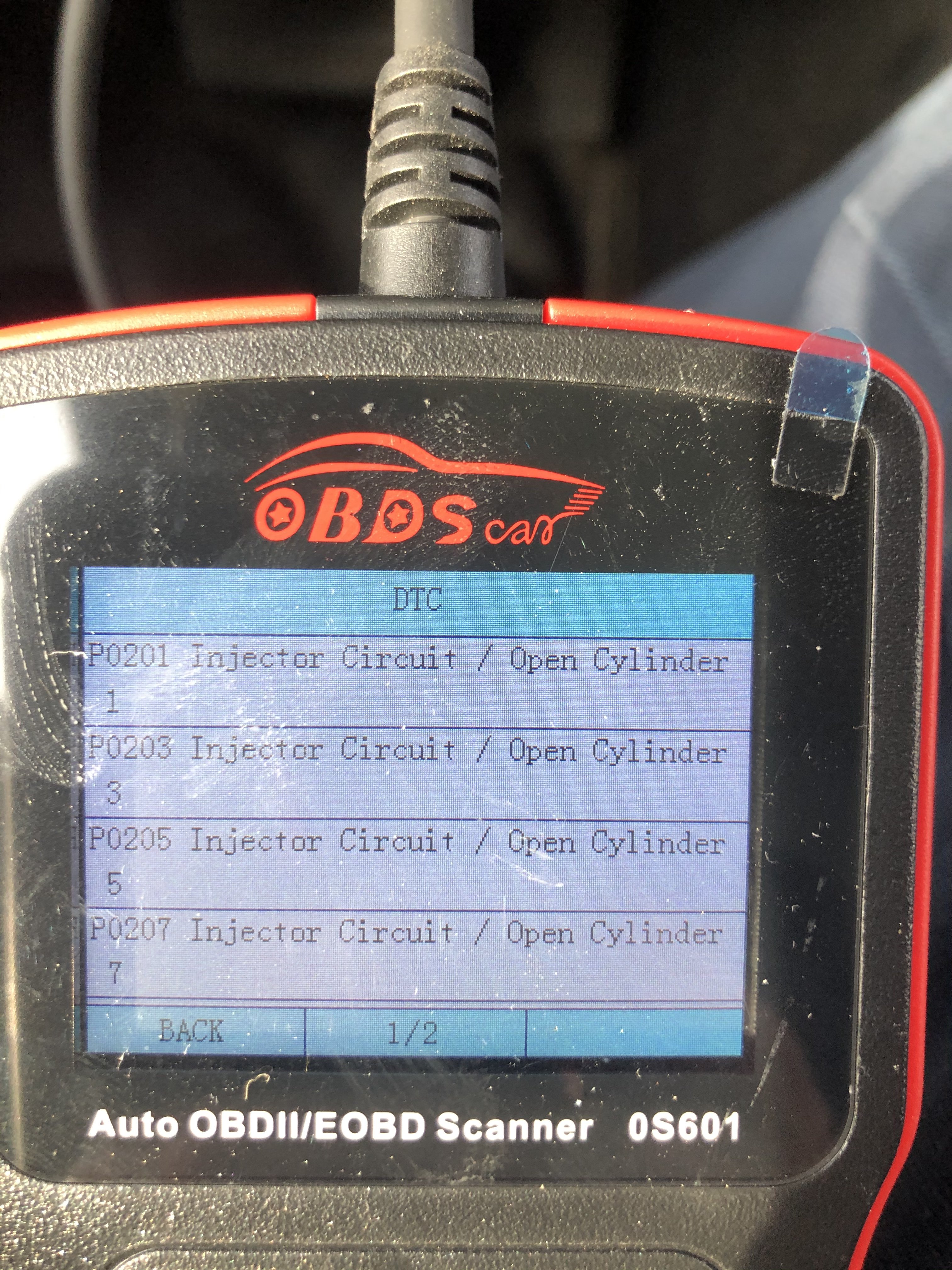

T & H COMPLETE AUTO SERVICE
212 E Ave K 6 #350, Lancaster, CA 93535
(661) 945-8770
https://g.co/kgs/1mY4wq
Dropped it off here 12/30
Hes had it three weeks without even quoting me a price on anything.
And he tore the engine up and it's fine.
The number one injector was getting 12 volts way to hot.
Over a week ago. Was supposed to get a harness in Thursday and let me know if it was fixed.
My 570 has been a work horse but with 14 inch of lift under load the engine is starting to bog a little.
I'm going in tomorrow and seeing financially were I stand and if I'm towing it to empire and leaving it to be repoed I'm done with this shit.
I owe 2 more.years to the bank.
And its.cost $750 to have it sit at the place getting fixed.
I can provably make one van work for awhile if my 570 doesn't take a shit too.
I'm just super pissed and dont see a happy ending with this shit.
