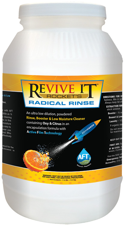

do you guys think they are legit? or bs?

The word " Encapsulation" is just a marketing term.
Anything that surrounds would qualify..................like.........water.
Look for Nanotechnology to be on everything soon.

Love the name. How close to Releasit can we get? ;)
I missed the name part.
Are you comfortable that true encap technology is compatible with both d-limonene and a percarbonate oxidizer Rick?
To everyone watching this thread: I'm not leading with a question that I know the answer to; I am asking someone whose experience and opinion I respect because I am not sure.

I try not to mix them.
I want to know which one to blame if something goes wrong. We've had sometimes poor encap results when doing it following nuclear HWE too soon, while the carpet was still damp.
My experience has been that if you have to add a lot of different chemistry to encap, you have a job better cleaned with HWE.
Still will be interested in Rick's feedback
Hi Jim,
I haven't tested percarbonate oxidizer per se in an encap formulation. If you're wanting to achieve safe oxidizing results with an encap product - hydrogen peroxide would be an option. There are hydrogen peroxide stable encap polymers. It's what we use in Encap-HydrOx.
Solvents are another story altogether. Typically most do not play well with an encap polymer. Adding d-limonene will absolutely foul a true encap polymer. As we've blended our formulas it's been a tightrope walk (a little too far one way or the other and the good crystallization we're looking for goes right out the window).

The post title was Powdered Encaps. The polymer bases that we buy are all liquid. I have never found a powdered base that was suitable for our applications. You can add a polymer base to some powders but are limited to about 5% of total formula. Double strength liquids can have 6 times the polymer content. Dilutions matter and amounts left on the carpet matter. The math does not work for powders especially when you recommend a dilution of 1 oz per gallon. The double strength versions recommend a 1 to 32 dilution. The result is that the ready to use liquid will have 18 times more polymer than the powder encaps. The other ingredients in the powdered encap can do great cleaning but the only thing the the encap in the powdered formula can do is to assure that there is no re-soiling tendency left in any residue. There would not be enough for the formula to resist future soiling like all liquid encaps will do to some degree.
Also I missed the scientific study that proved film formers any better or worse than crystals. I became skeptical of any of these arguments when I added .5% surfactant to a film former and automatically changed the residues to a crystal. My theory is that a crystal starts with a film former which has a surfactant added to form a crystal. I have not devoted any further research to this phenomena when I have seen both crystals and supposed film formers provide similar results along with both types become a commercial success. Both types work with the correct balance of other ingredients and both types sell very well. If a crystal was better then we would have made a formula with a crystal especially since we discovered how to do it.
