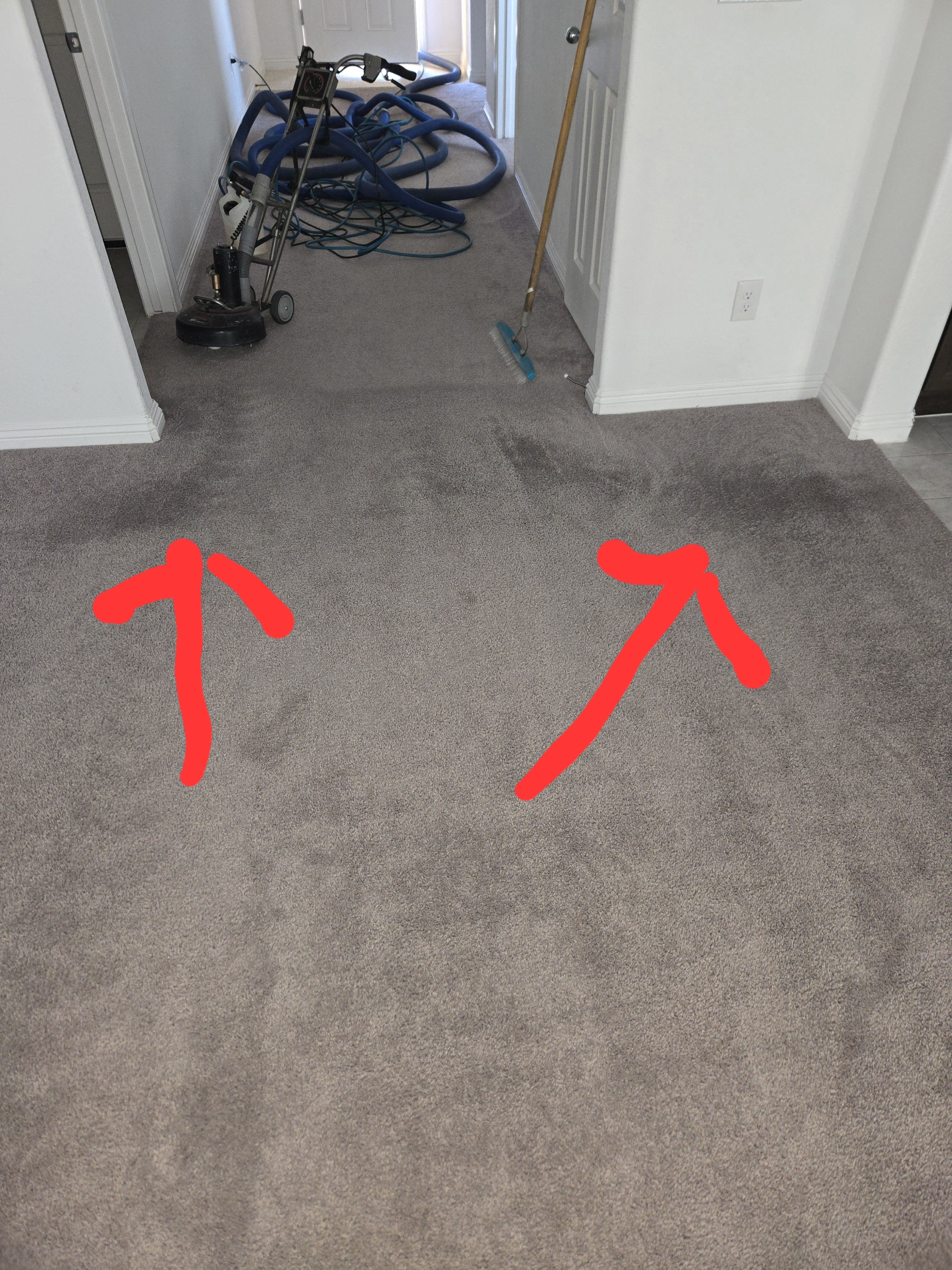

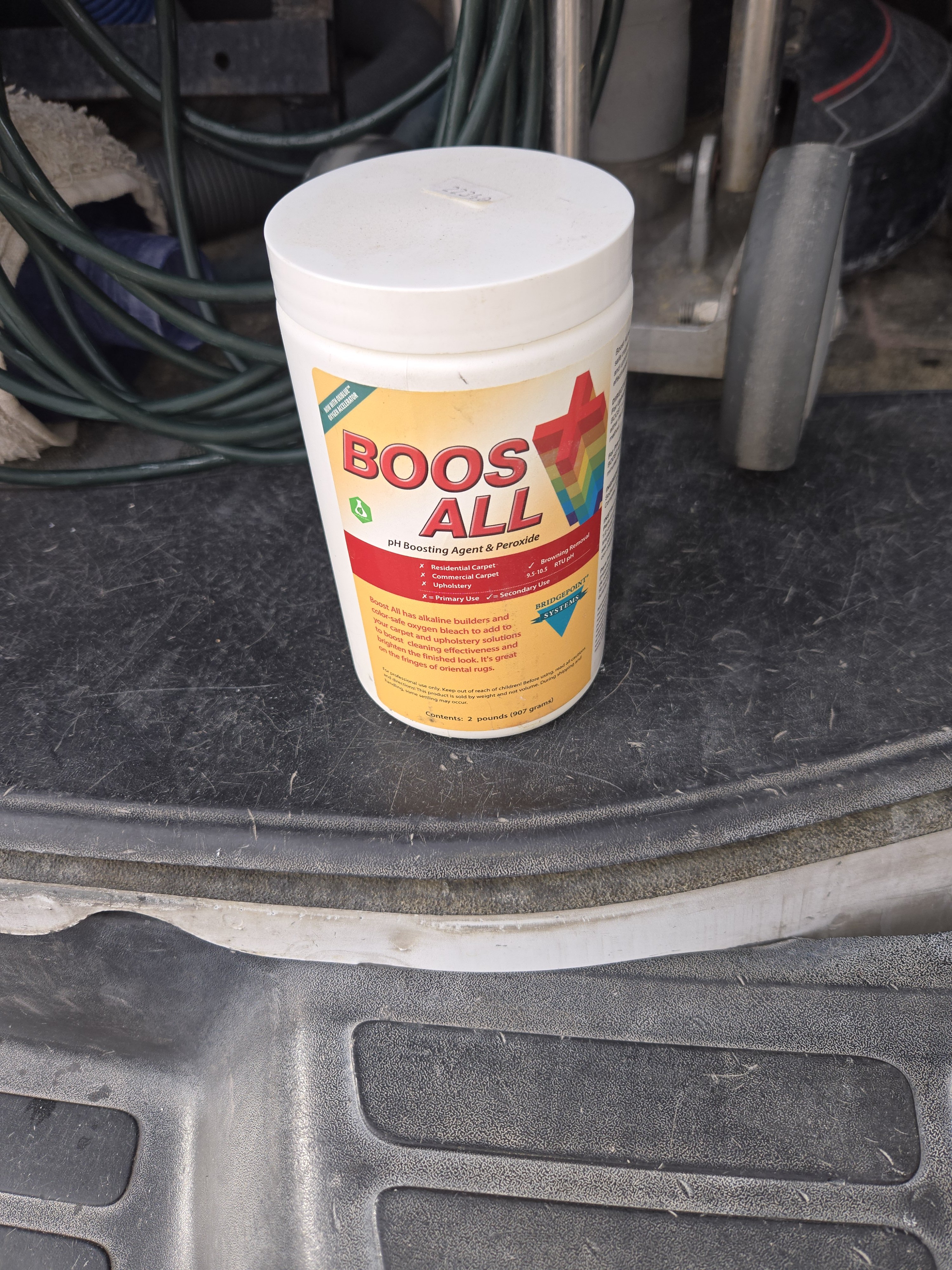

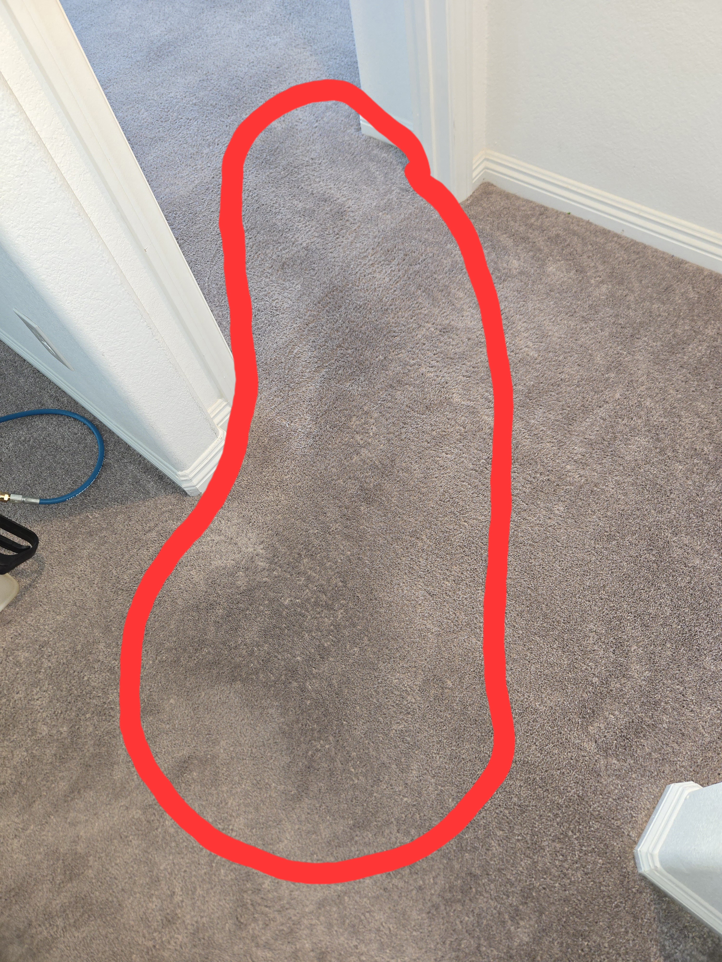

This looks like crap, all these housing tracks in my town have this crappy polyester carpet, a customer showed me a carpet upgrade and it was just a thicker polyester. 🙄 Has anyone used "Boost All"? My former Aramsco rep. told me to use it? I haven't yet...(I think it's just wearing and shading different.)

A good last ditch product is Harvard's Citra-zov powder. 12-13 pH. Contains oxy and citrus boosters. Cuts through just about anything.

Sodium per carbonate or powdered peroxide helps brighten the dinge and wear.
Bio spray 8 is loaded with it.
Also a polymer can fill scratches and help with wear.
Lastly clean the carpet and groom it in a direction that makes it looks brightest.

I'm using Flex Powder and it's 13.2 pH I believe...
I use Flex as well but the Harvard product is what I use when all else fails. I have a job on Monday that if I am somewhat successful, I'll take some pictures. It's commercial carpet that for the last few years, the staff have been renting a machine and doing it themselves. The carpet is supposed to be light blue but now is completely black. When I was standing their giving them an estimate, my shoes were sticking to the floor. I recommended replacement but they just want to see if I can improve it a bit first. So no guarantees but I look at it as a challenge. We'll see what happens.

How long have you been using that product? I used about 5gallons of it and found that it was too hot for normal residential carpet. It wasn't doing anything special that the other lower ph treatments performed
A ph of 9-11 is the sweet spot for residential

I would say about 10 years? Usually works great for me, I use a little Prochem Power Solvent for tough spots, but normally Flex, RotoVac 360i standard 3 jet head, brush head if it's really soiled, 400-500 psi, and full heat on the Prochem Apex...it's just these 2 housing tracks with polyester that I'm unable to get these dark pathways to blend? Nothing I try on it does anything? Thinking the fiber is just breaking down and I'm seeing wear shading? 🤷‍♂️ Just frustrating because it looks like I left it dirty....

This polyester carpet is a good option for the homebuilder, as it's cheaper in price, but since the carpet is made from recycled plastic, it's not holding up very well. I remember my teacher at my IICRC class telling us not to purchase "Green Products". I'd say don't purchase green, recycled carpet either....

Most likey, it’s not a prespray issue. There’s a thousand good prespray products and he’s probably already using one. In my experience, if a Rotovac with a brush head doesn’t solve the issue, then it’s time to replace the carpet.

Sorry to say, but Flex w/cutrusov SUCKS!
I used it for 5 years as my go to trashed prespray…
I probably used 40-50 5 gallon pails of it.
I’ve got 3/4 of a 5 gallon pail hardening in my shop as I type this.
I switched to Prochem UPE, and the results on trashed residential and commercial were mind blowing.
When I get into a situation (residential) where I need the power of peroxide, I’ll add a couple scoops of sodium per carbonate to my spray…

To your question about Boost All
It will help a bit, as will similar Sodium Percarbonate products.
The biggest problem you have there is the damage to the fibers, which no magic prespray solution (Marty/Hogjowl said it well) can change.
While you won't find it in rental property, or mid-income homes, wool is coming back as a wall to wall carpet. It will hold up much, much better, and other than specific staining issues, you'll get it clean and looking good without needing to use thermonuclear presprays.

Sometimes dinge away from cti and fill scratches and brighten worn carpet.
But when the fiber untwists and looses density.
Or has pile reversal, there's not much you can do.
I agree wool is great, I still tell people get nylon.
