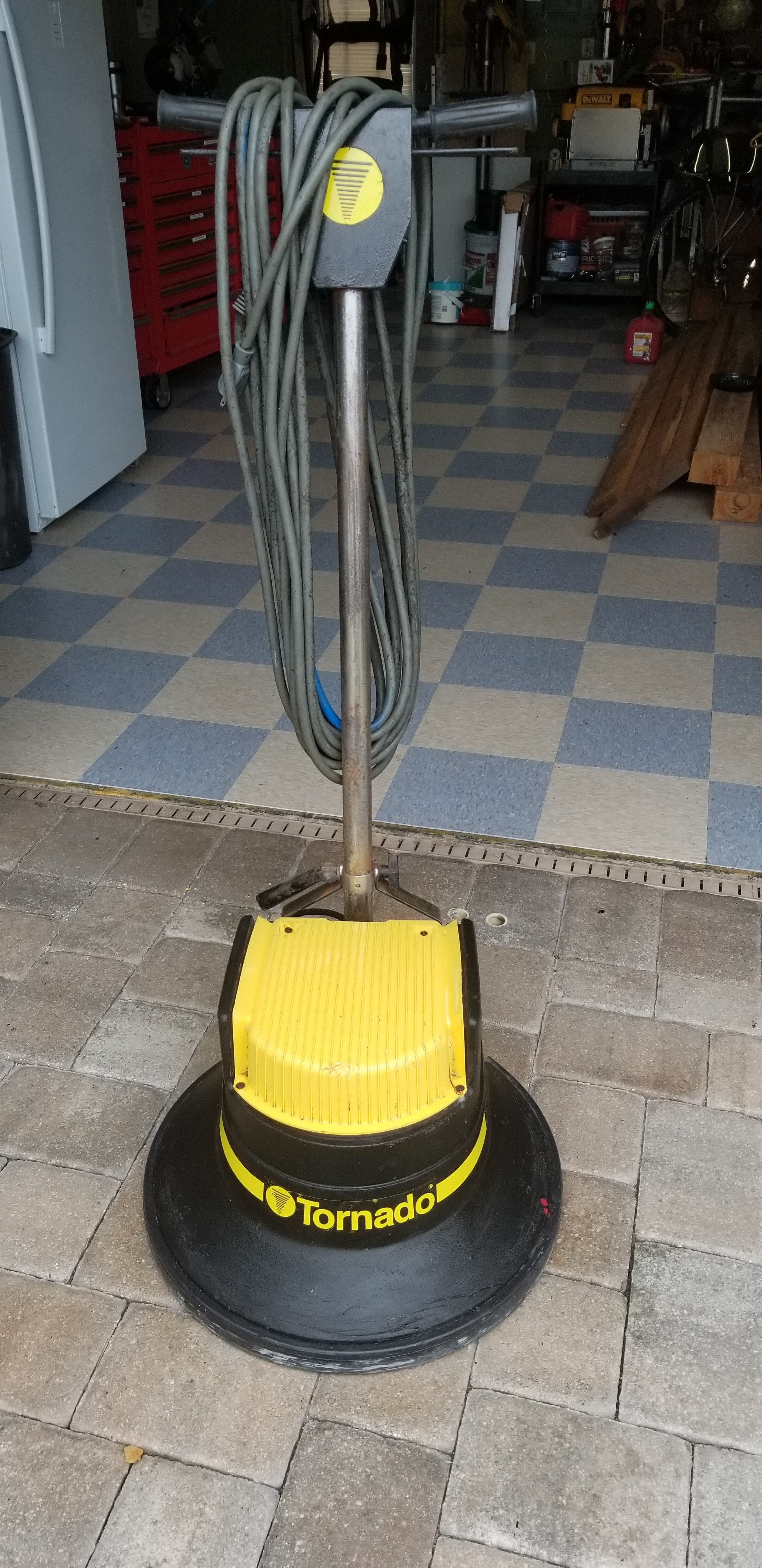

Hey All,
I was finally able to contact the guy with the Tornado and picked it up just now. I now have come across another person that has 5 5Gal containers of GEMSTAR Stratus. He said he's " looking to get" $80 for the lot of 5.

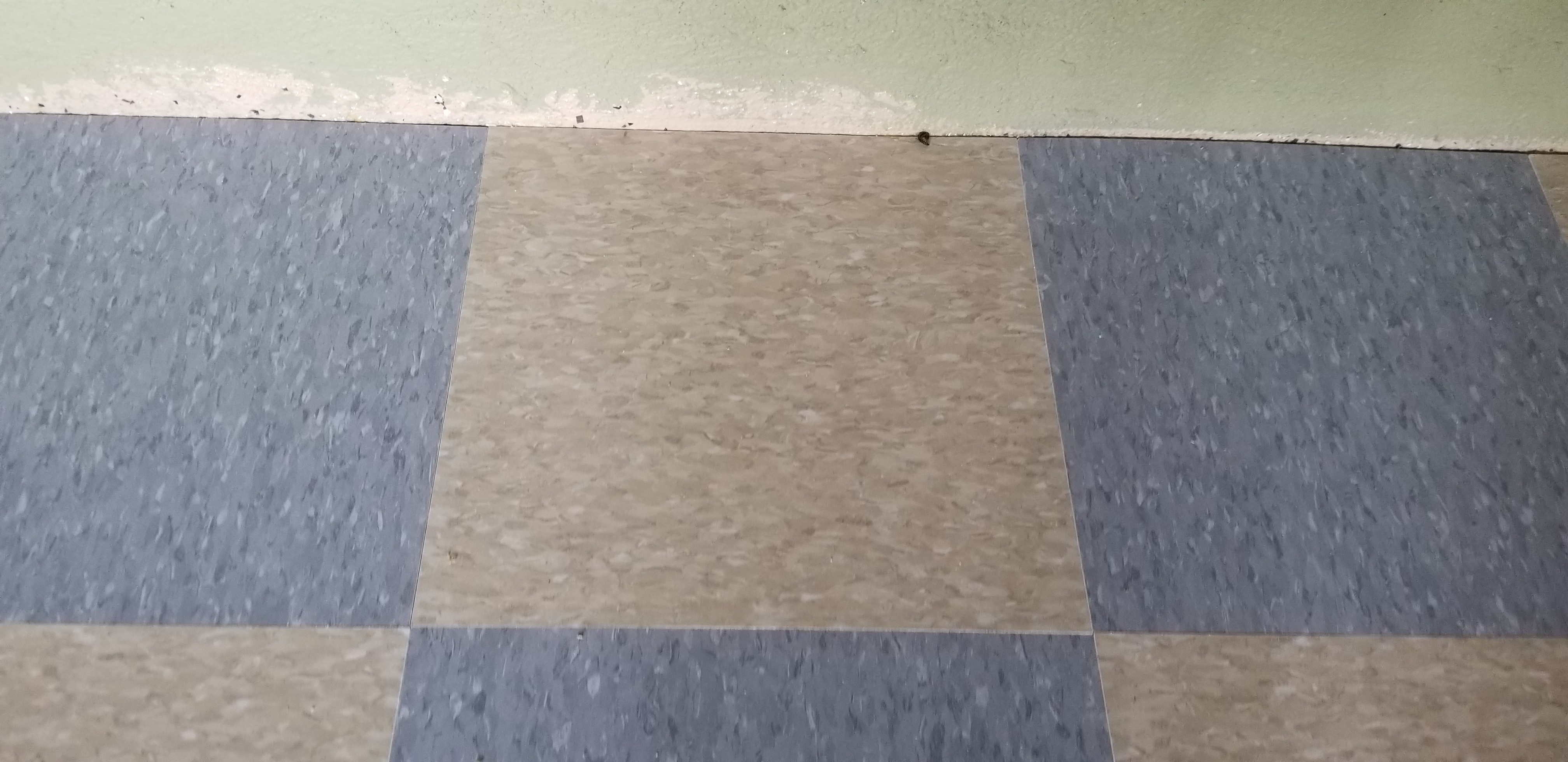

Being that I haven't yet decided yet if I'm going to use a rubber cove base, would it be a good idea to squeeze a bead of silicone around the perimeter?
I would cut at least a half inch of that sheet rock off all the way around. Before installing the cove base.
Trust me. Your welcome.

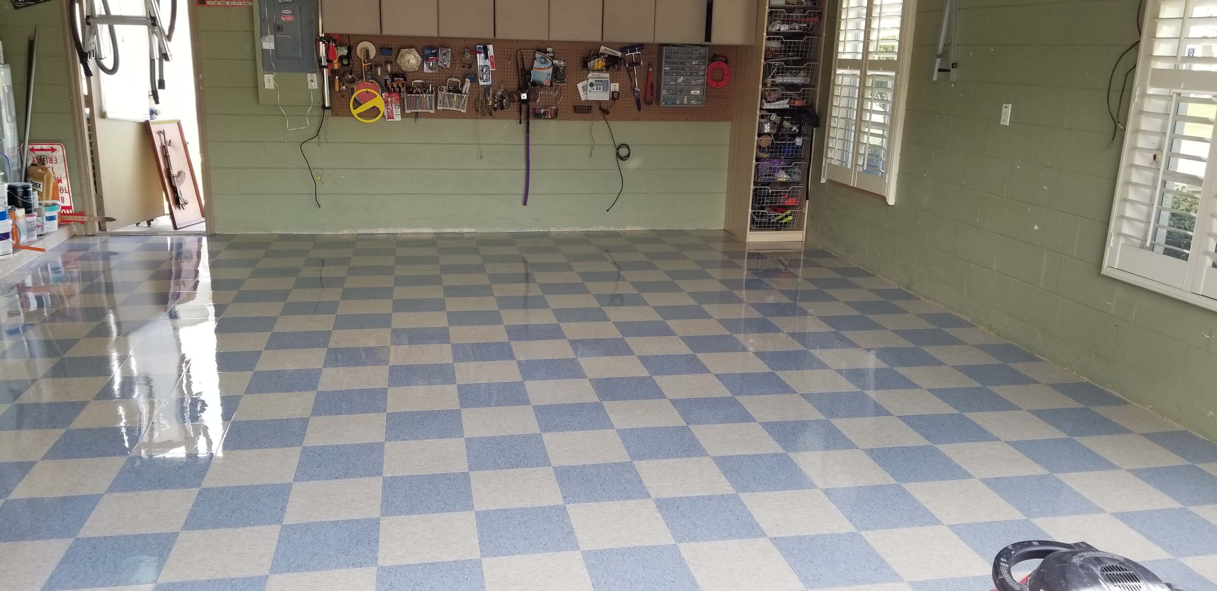

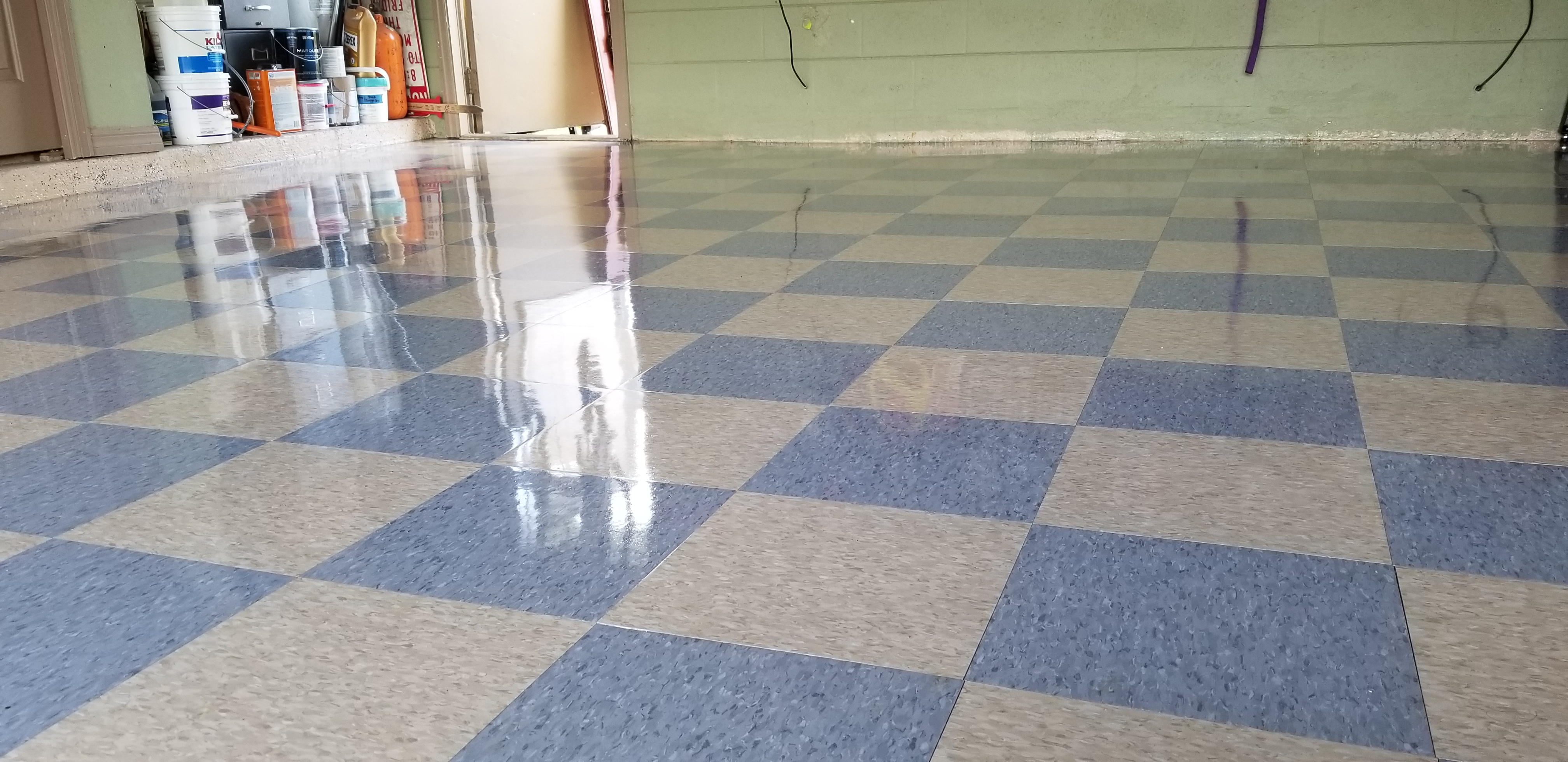

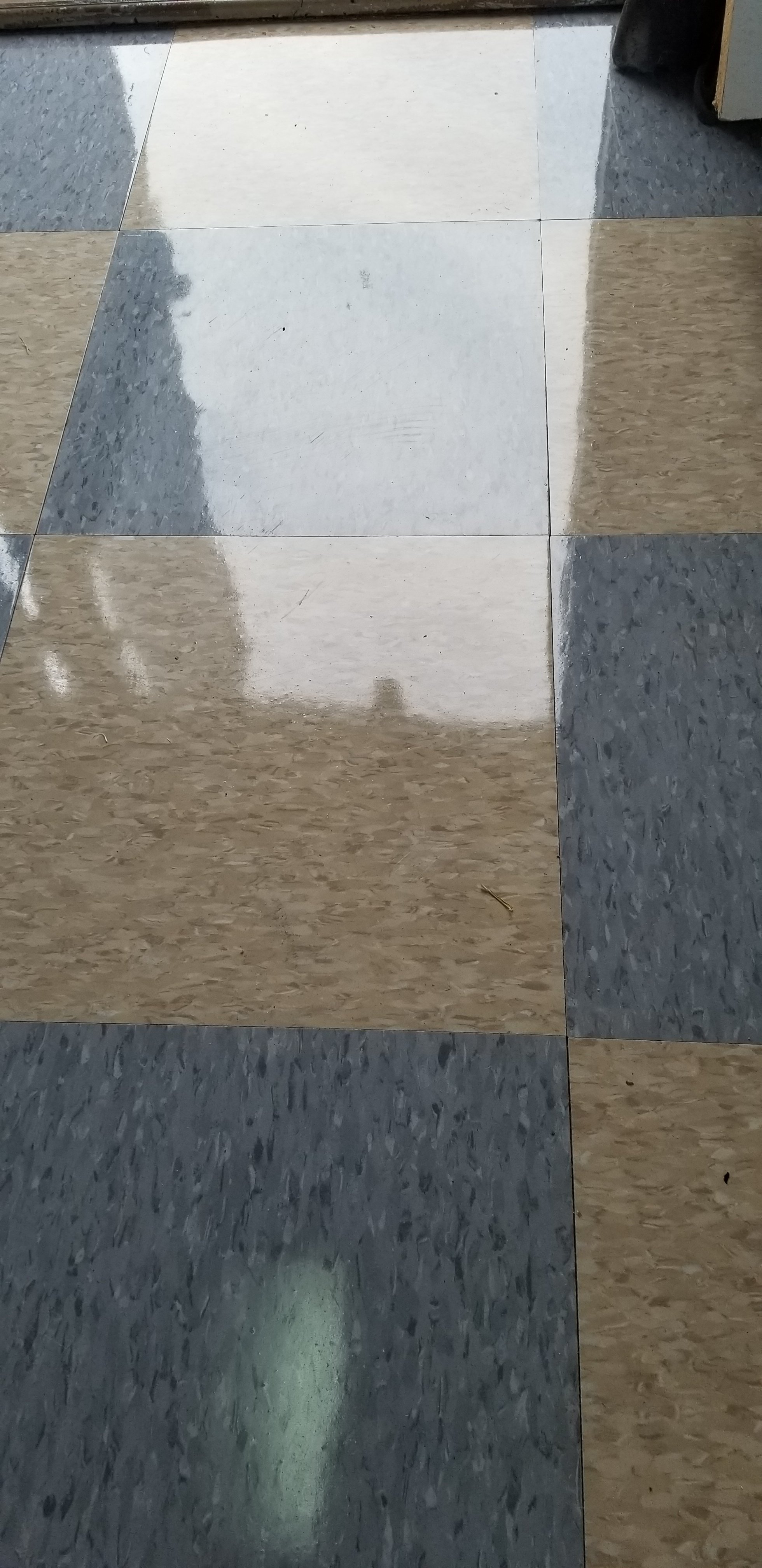

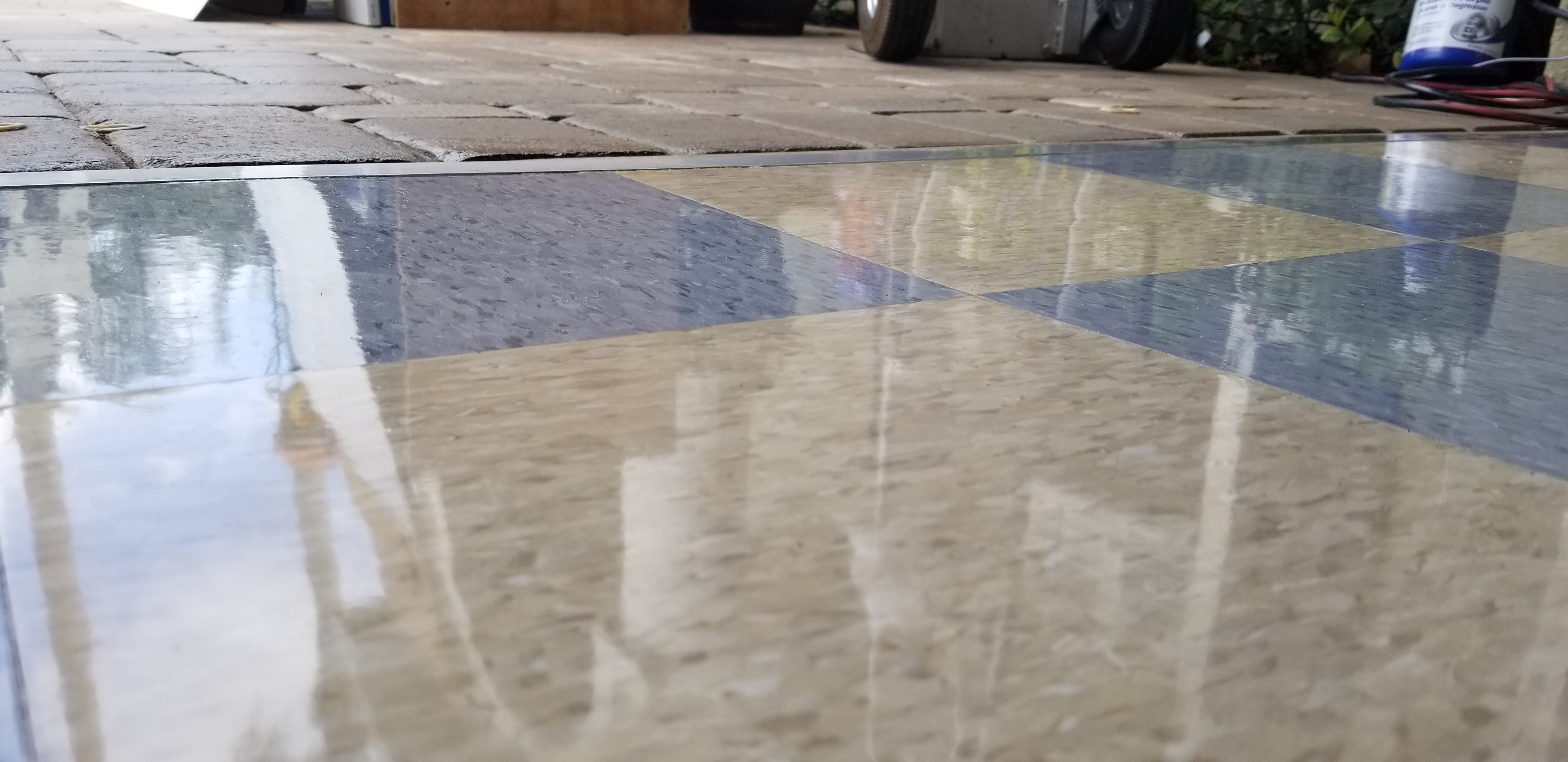

Hey All,

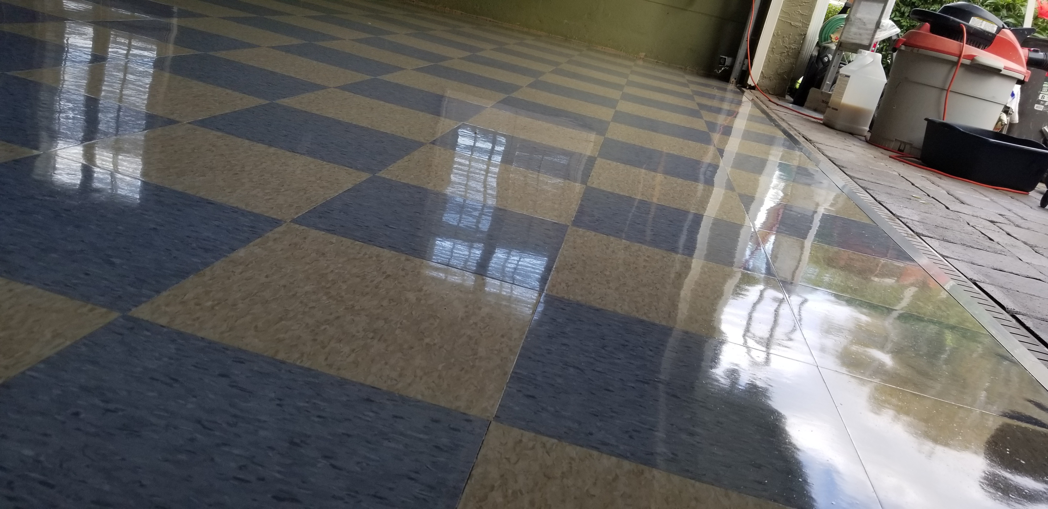

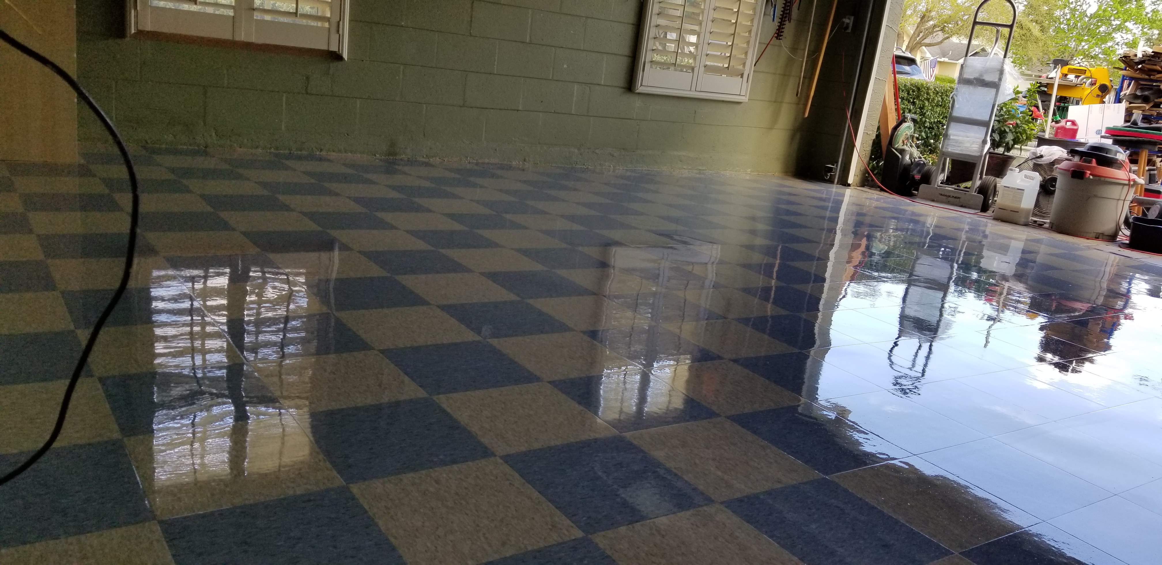

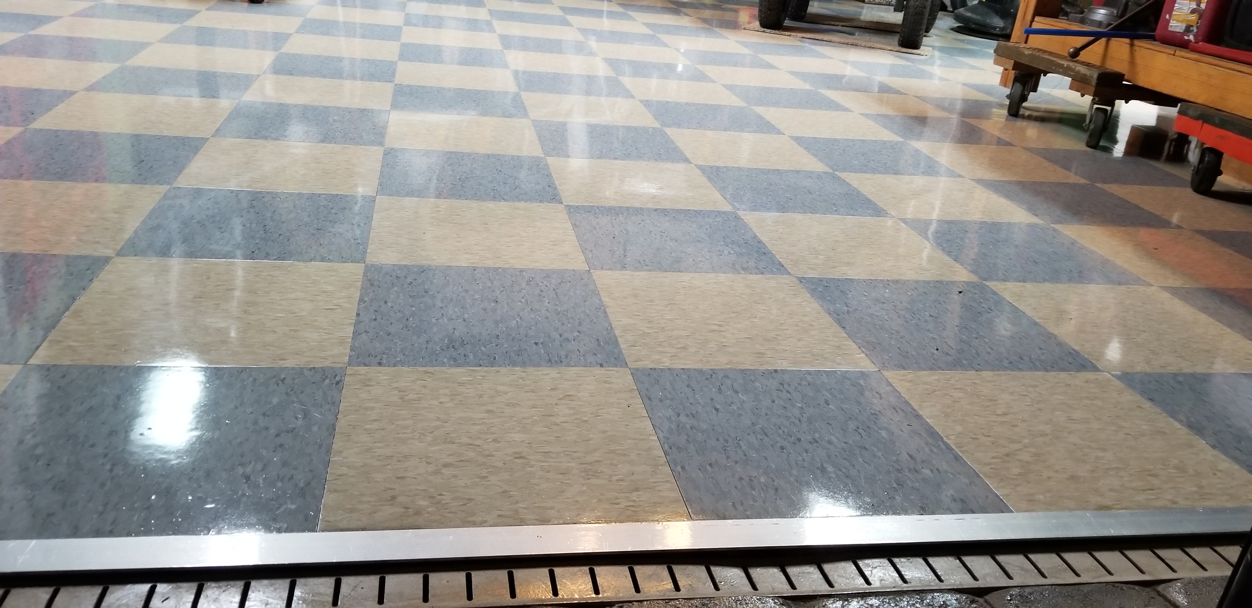

I was finally able to find the time to apply my floor finish.
What a big PIA moving everything around.. Anyways, Here's how she came out with 4 coats. Im thinking for a NFG it's "Good Enough" lol for my purposes!!
Thanks again for all your help and advice.
20190309_144154.jpg 20190309_154802.jpg 20190310_230520.jpg 20190309_161930.jpg 20190309_163643.jpg 20190309_163719.jpg 20190309_174912 (1).jpg 20190310_230131.jpg
Andy
Feb 5, 2016
970
Doesn't Matter
I do what I call "2 past awesome" which equals six coats of finish, here is why. The first 2 coats of finish you apply are to protect the tile, that is the main purpose of putting finish on VCT. Coats 3 and 4 will give you an awesome shine like your floor looks. Coats 5 and 6 are applied to protect your awesome shine, thus "2 past awesome"

Andy,
I really wanted to, however i was fighting potential rain and daylight, then having to bring everything back inside again.
Question:
Can i apply additional coats, by moving half shit to one side and then coating, then after it dries, do other side?

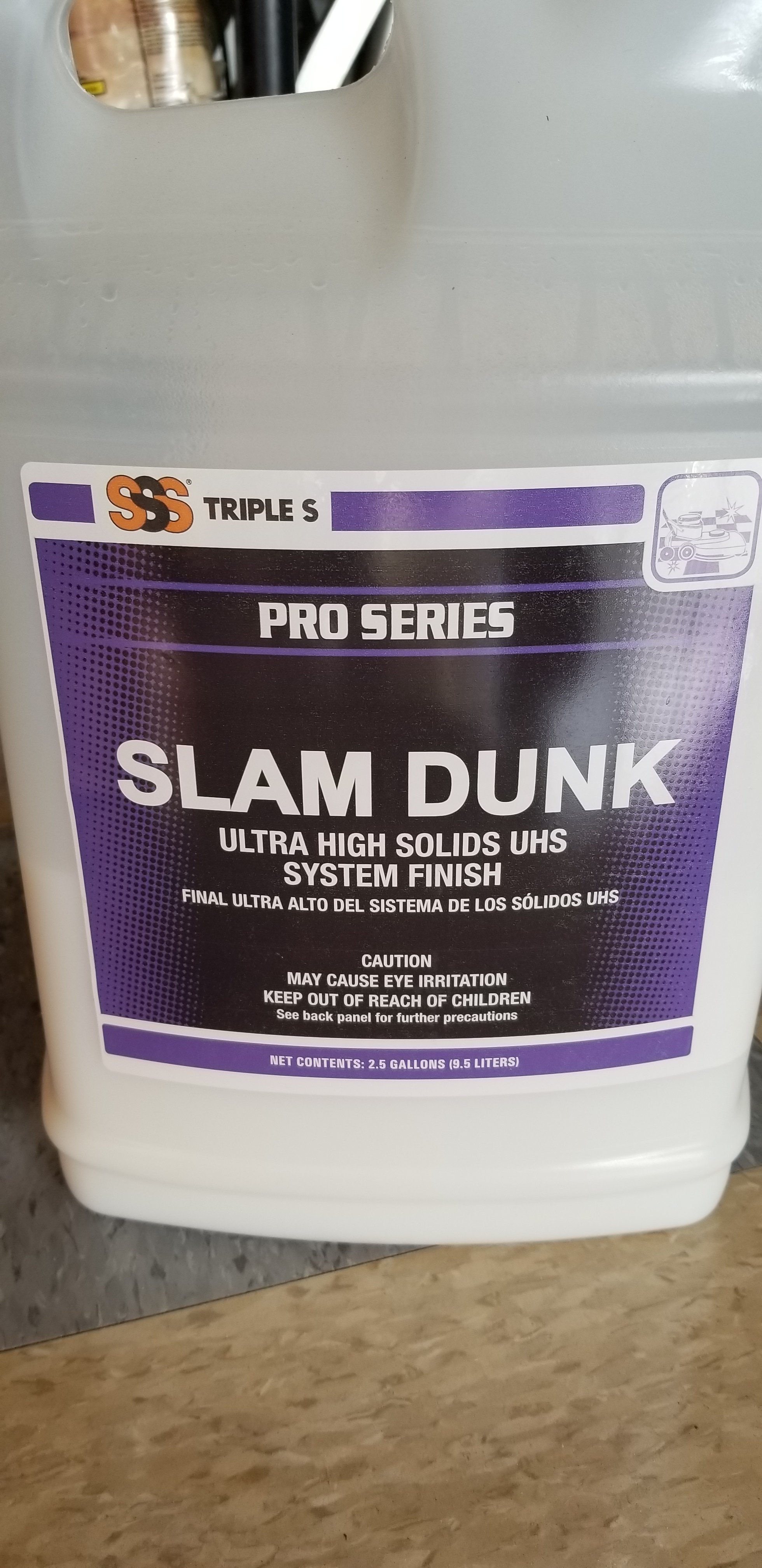

This is the finish i ended up picking up from my local supply house
J Scott W
Oct 16, 2006
4,061
Jeffrey Scott Warrington
Andy,
Question:
You will have a line where the two halves meet. To to make the line fall between tiles rather than in the middle of one tile, and you will have a pretty good result. Maybe some painters tape to make the line straight.

While it looks good I have to question if it's really worth the effort to have to maintain it. Over time in a garage expect deep scratches and wear and it will be ugly in no time.
M
MtPockets
Thanks Jimmy, lmao... i think I'll hold onto the buffer now i suppose😂
I dont have a lot of traffic, just about everything is on wheels,
Tablesaw, jointer, planer, tool chest, bandsaw, soon to have 900# workbench on wheels too once i complete it..
Also, made sure to keep a box of each tile for those times..

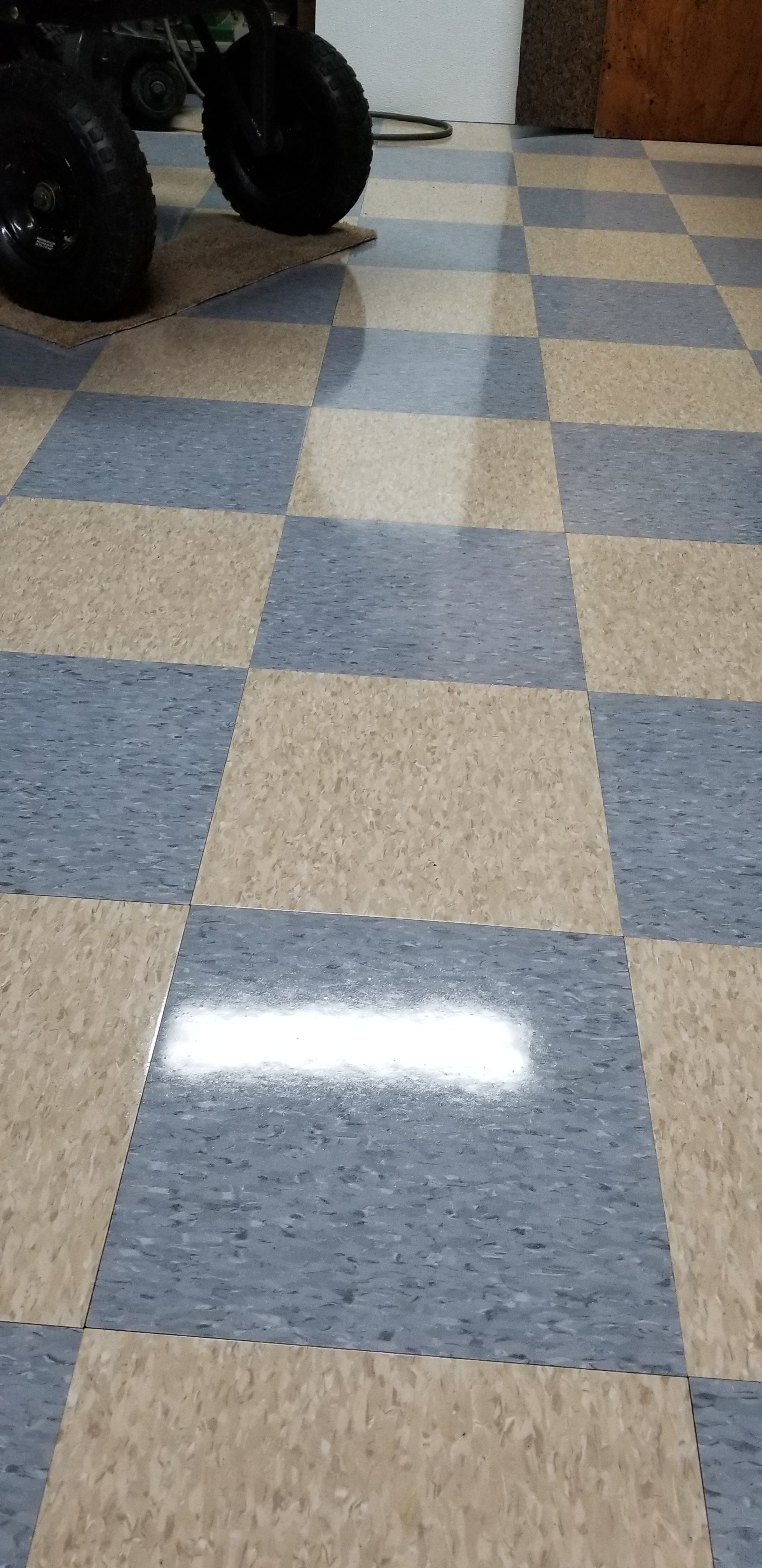

Andy,
You were right on the money with saying that the Pneumatic tires will leave Yellowish/ brown stains.. I had that happen with a 4 wheel cart, however only the cart and not anything thing else which is weird prior to finishing, but i replaced them... i talked to the saleshole and was told that i shouldn't experience that after the finish is applied.... i do have that cart resting on a cpl scrap pieces of carpet at moment, until my shed arrives
10,203
But if it does start to look ugly, you can scrub and top coat and make it look good again. You can do that a couple of times. Then, you can do it over again with ease since you didn’t put 6 coats down. Carry on🤷🏼‍♂️
