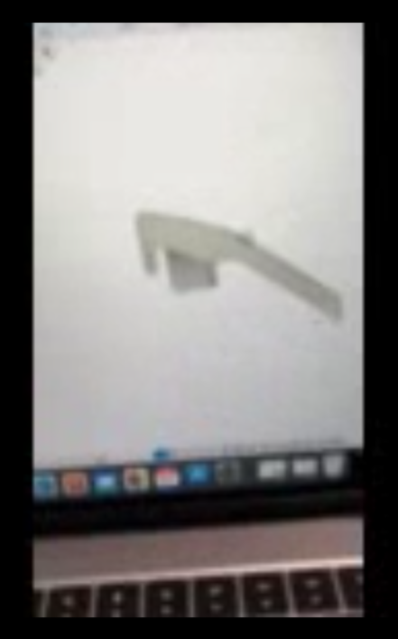

The tool is really coming along impressively
Two units will be in Indianapolis to play with Screenshot_20250318-213321.png

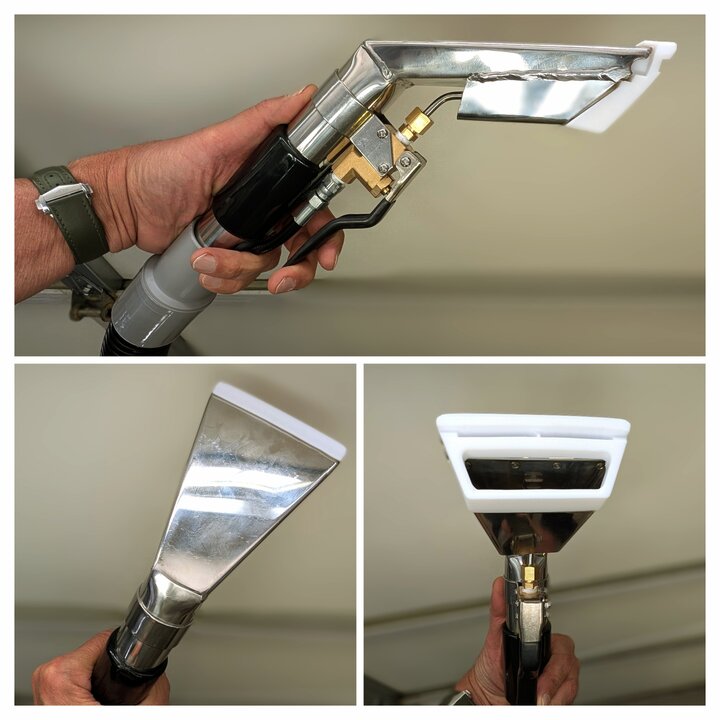

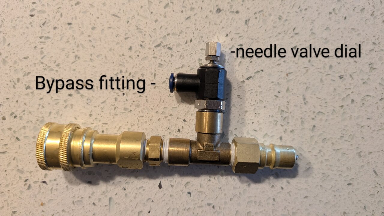

Getting sic'er by the minute...
View: https://youtu.be/_v0bQlEUPBs?si=a5dpKjr4Kk_85ndp
Inch and a quarter ultra flexible vac hose with swivel cuff, in 10, 15 & 20' choices.
The optional brass bypass assembly will come with a protective bag for those concerned about scratching delicate floors.
And did I mention the head will most likely be made out of titanium for a 35% weight reduction?
View attachment 130402 View attachment 130403
Looking promising.
I’ll be the first to ask,
Have you decided on pricing yet?
It all looks good so far.
Titanium should make it as light as a plastic tool, with more durability.
The bypass set up might not readily survive careless cleaners/techs, but it seems the bag should help with this. I think the feature is worth this potential issue, as you can control pressure/flow, and I would think it should enable enough flow to activate flow controlled burners.
Will that feature be an option?

That opening is about as wide as a Big Mouth Bass. Looks like it might pull fabric a little too much. Any optional cage like glide?

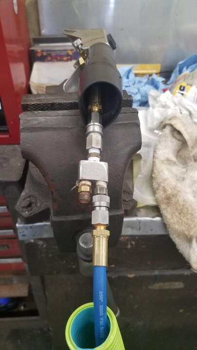

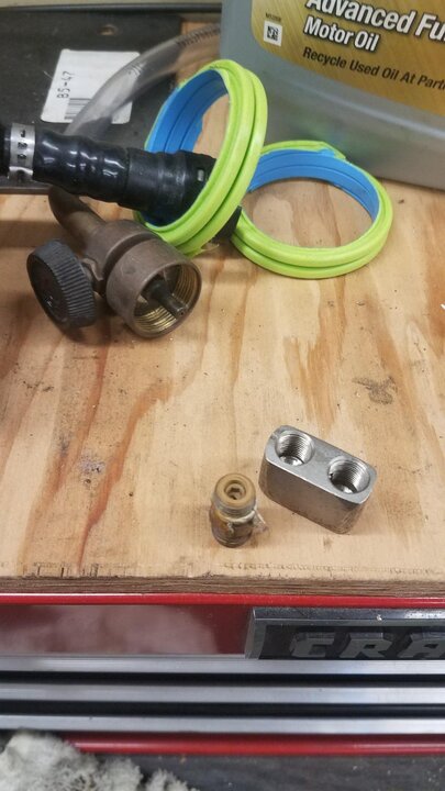

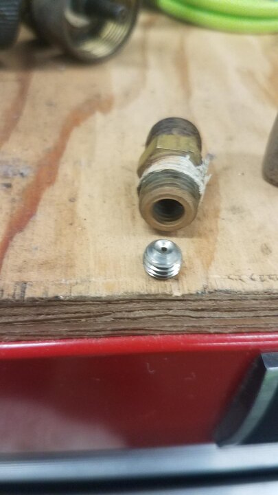

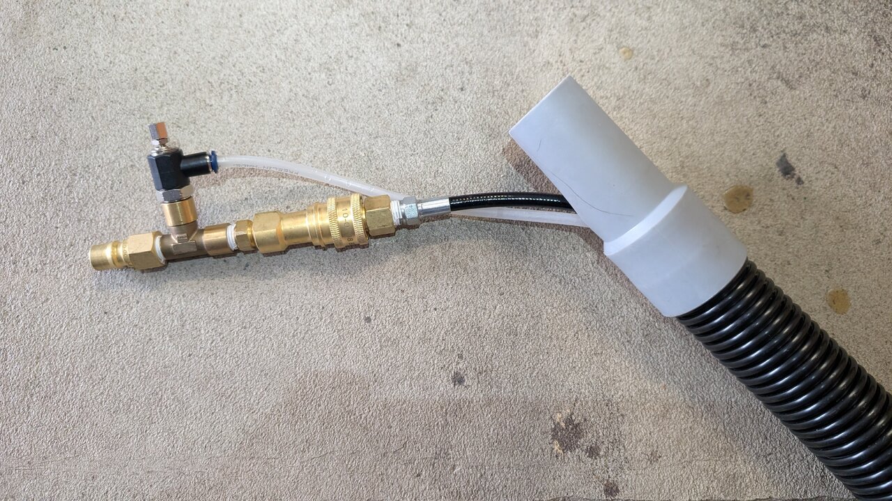

This is what i use to bypass on all my upholstery tools its built from off the shelf parts from a kleanrite solvent tool. It's simple and can be easily removed if necessary
View attachment 129914 View attachment 129915 View attachment 129916 View attachment 129917 View attachment 129918
Forgot to say , the short teflon hose is there so as the jet of hot solution doesn't cut a hole in vacuum hose(and it would). The teflon hose is connected to a small orifice used inside kleanrite solvent extractors return line
