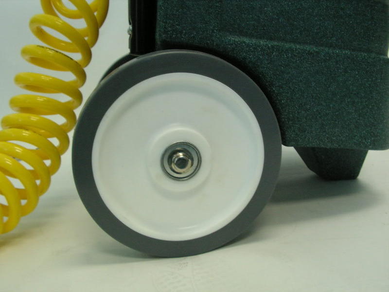

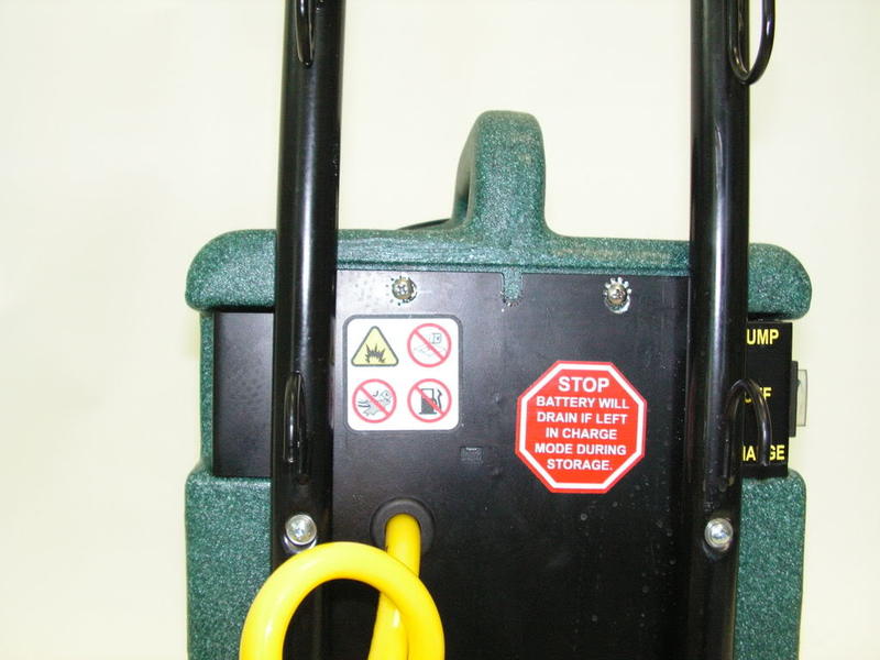

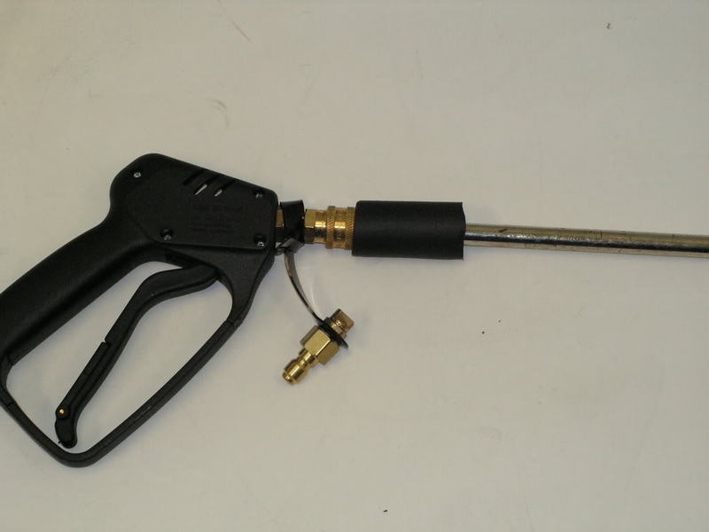

Some of the new features:
:arrow: Handle with basket and gun holster ring.
:arrow: 8" rear wheels.
:arrow: Spray nozzle tether - holds upholstery jet to gun.
:arrow: Safety yellow coiled hose.
:arrow: Foam quick-disconnect protector.
:arrow: New mounting method for rear plate.
You can click on the pictures below for views of many of these new items:
