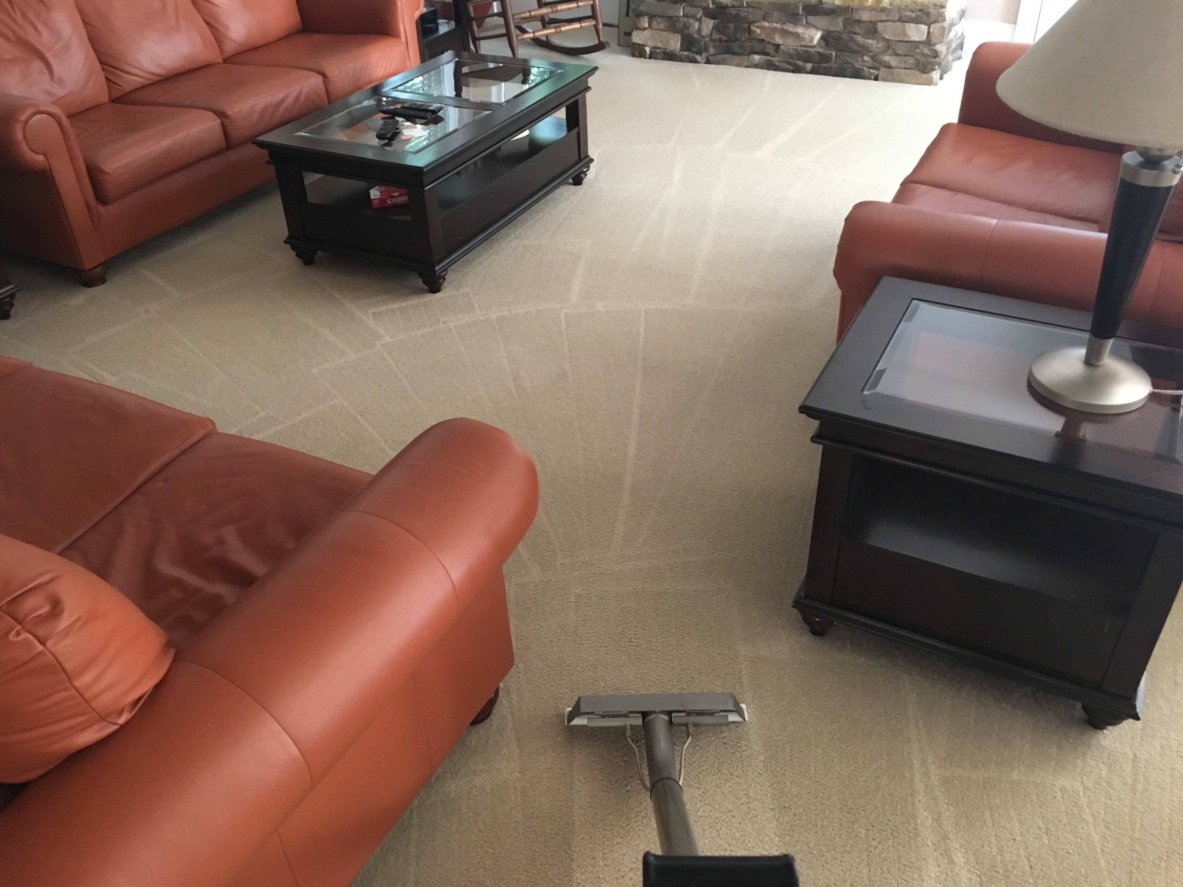

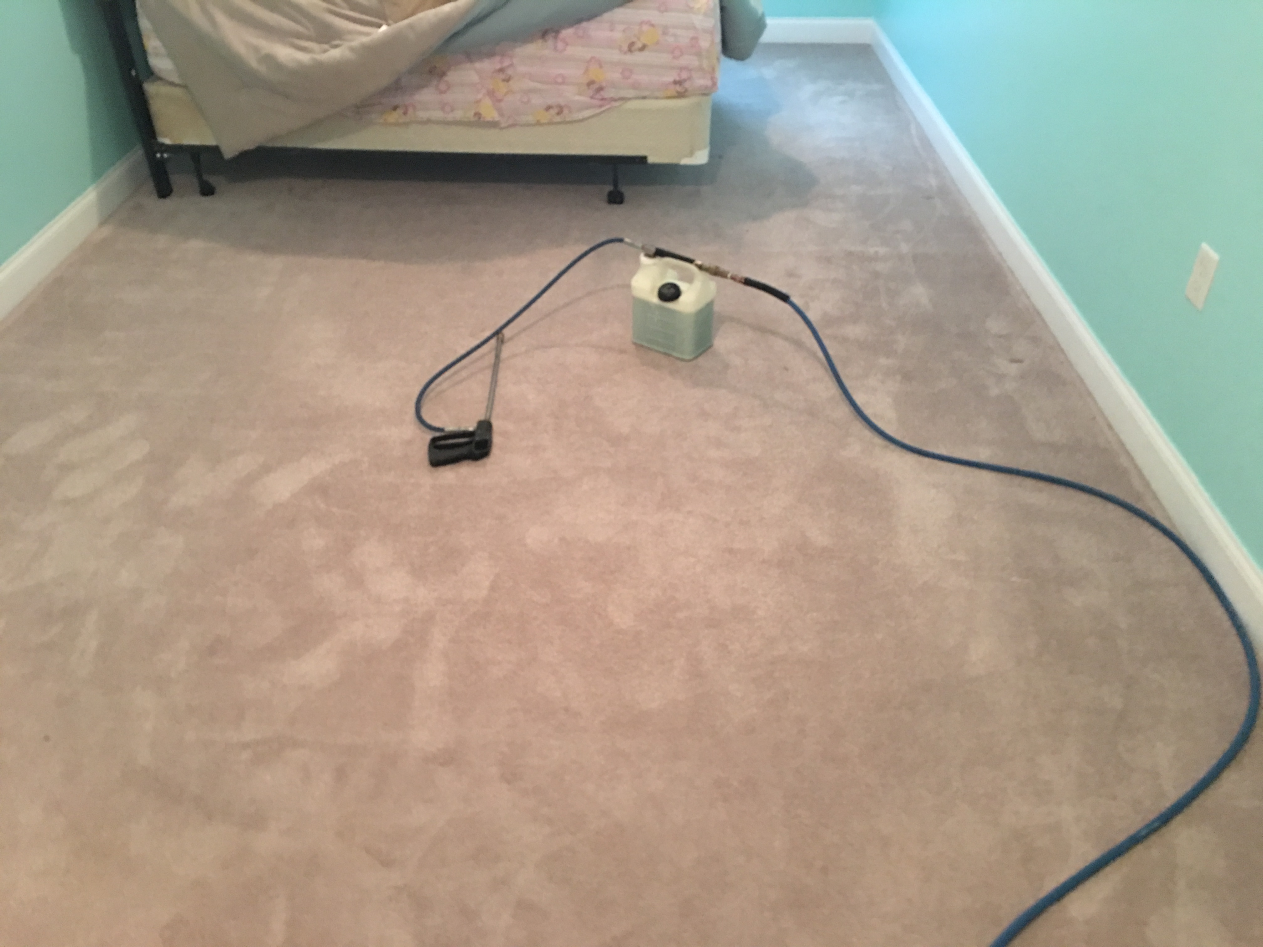

I cleaned with the 650 the other day.
Plenty of heat with the diverter set to low.
Quit being an idiot.
For the record. These jobs have the heat on low. The trashed jobs have it on high. I’m not a total idiot. I bought this tm so I could get that heat. I know when to turn it off
