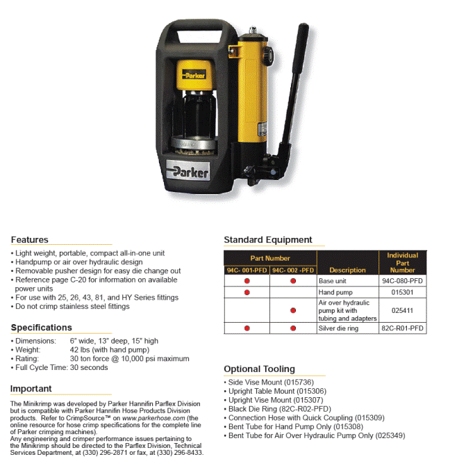

We use these to re-crimp our lines. They work really well.

is that the cobbs thermoplastic hose? was just about to order 200ft.
