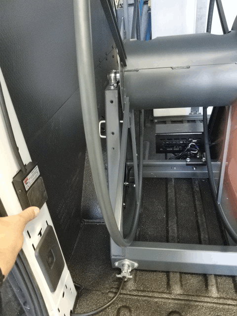

So what does that hose reel cost nowadays? Looks like the one I have. Wait til you have to replace the motor.

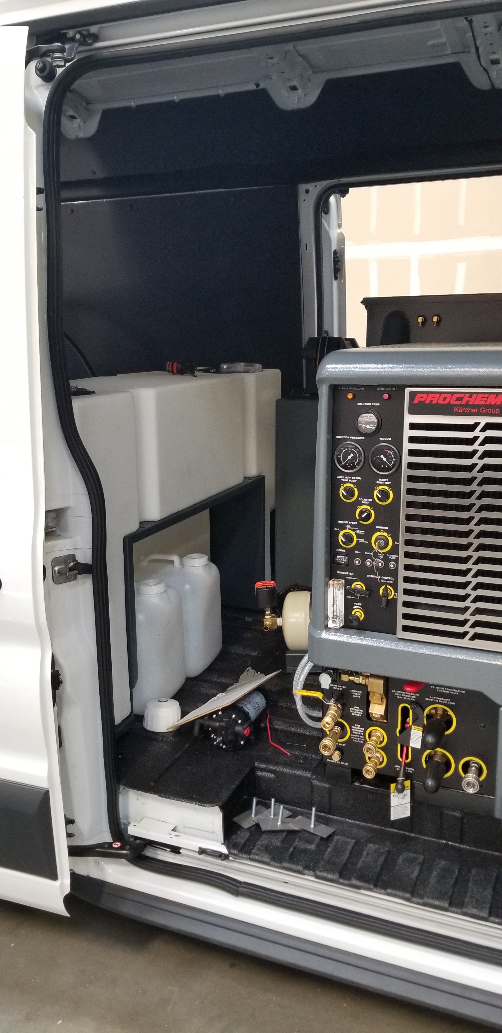

Guys y’all can’t see that it is a custom freshy tank ( or one Thaat was designed for over the wheel well design.) that he has set across the van?
It has a place to store some blocks or something.
We see that. Takes up too much precious space for its tiny capacity.

Lee if you put a 100 gallon it would easily take up twice that space.
He won’t have winters to deal with, or any of the simple problems that booking up and refilling bring in let parts of the world.
You saw the dimensions I posted.

Yes I did but I don’t think his current tank is but 12-15 wide ( again just guessing here) you are recommending a 27 inch wide tank for just 35 more gallons and the 27 inches might not include the mounting hardware to total figures.

I'd mount it in empty space above the machine/ waste tank, leaving floor open. ...and no transfer pump.

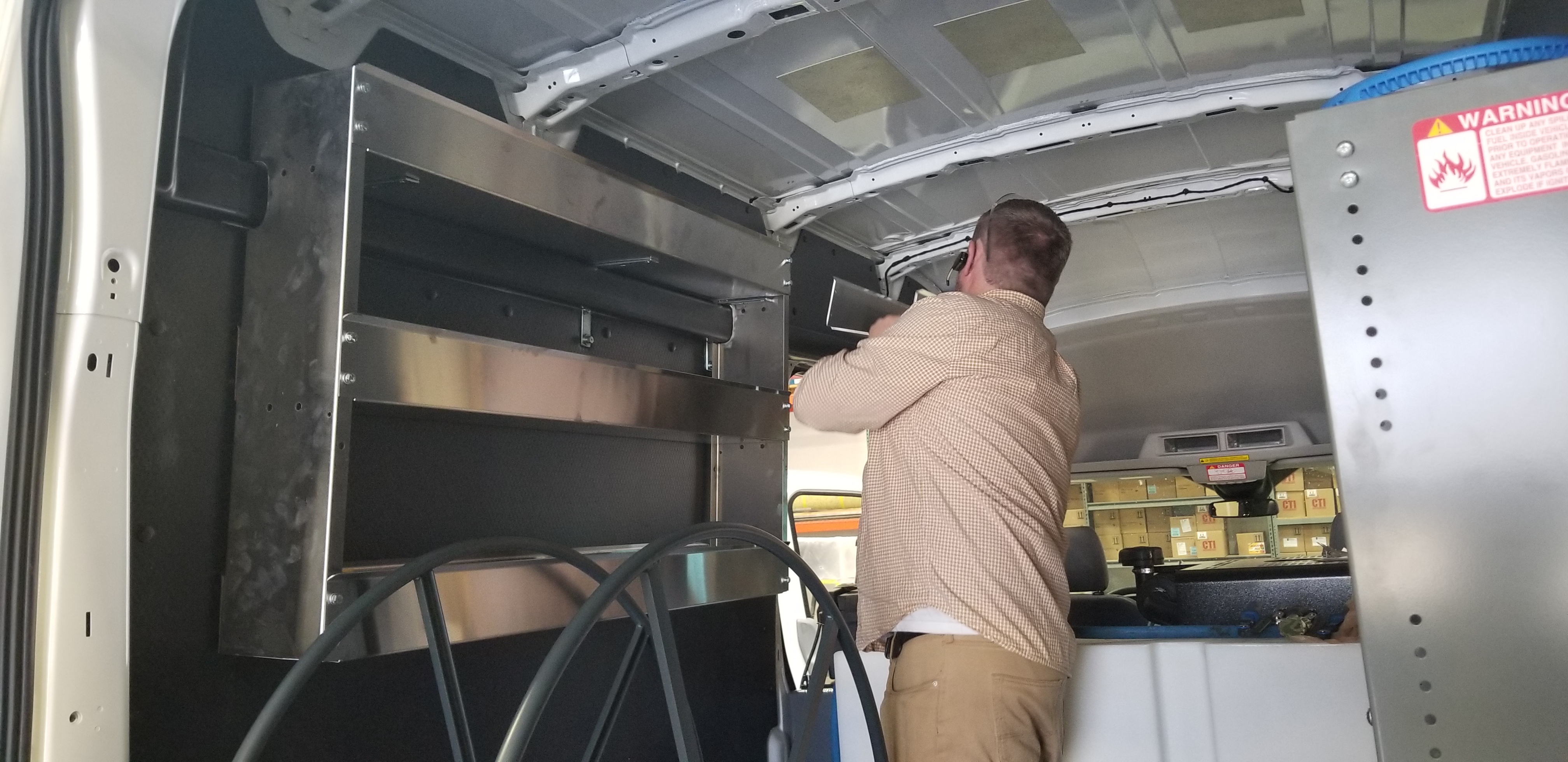

Still dying to know how you plan on suspending 900 pounds from that thin roof..

I have 2x100 gallon waste tanks and a 125 gallon fresh tank. No room for a transfer pump. 38" x 96" open center floor in the back for buffers and stuff. Lots of shelves. Will do pix.
Cimex is painted, special stuff to stick to plastic. I'll put it together the night before a big school project in June.
I'd draw a picture of how to mount your water tank, but you've made up your mind it won't work.

Wrap a bracket around two of the crossover top rails, and the vertical rails going down, at least four points. Add at least one support down to the floor, depending on where floor supports are located, where it won't block other access needs.
Poly tank would slide into the platform empty and be strapped to it with the factory straps.
Gotta figure employees driving it and being safe safe safe, one thing if he was driving it only!

Run at least 50 ft 2.5 hose, it really helps it breath

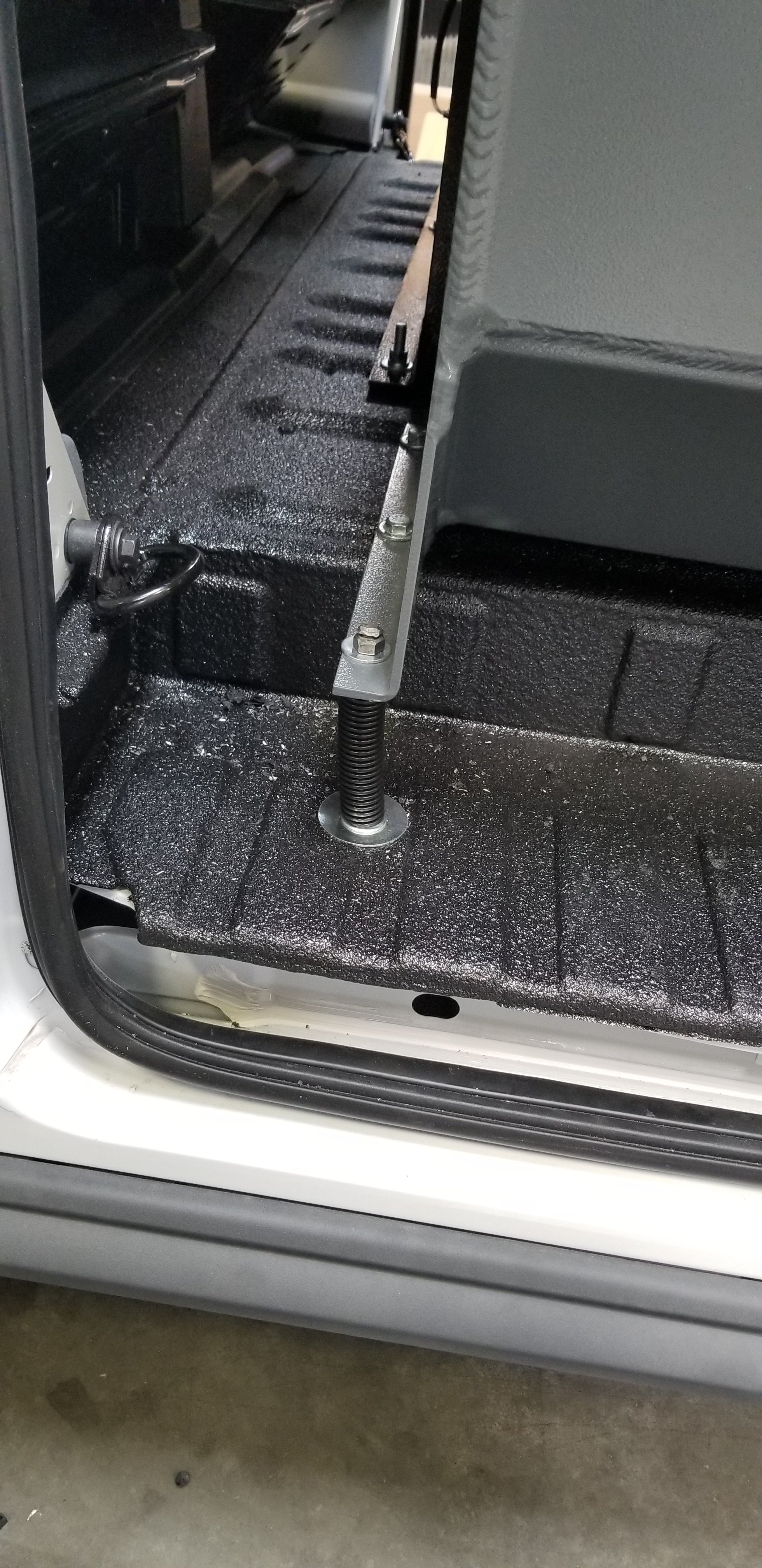

I didn't see the through the floor exhaust kit you did get one right? Also have them put in the water damn they forgot when they sprayed it :(
Never mind about the exhaust kit it’s a transit it can’t put one in the way the slider is built but you can put the water dam in to keep the water from coming up front
