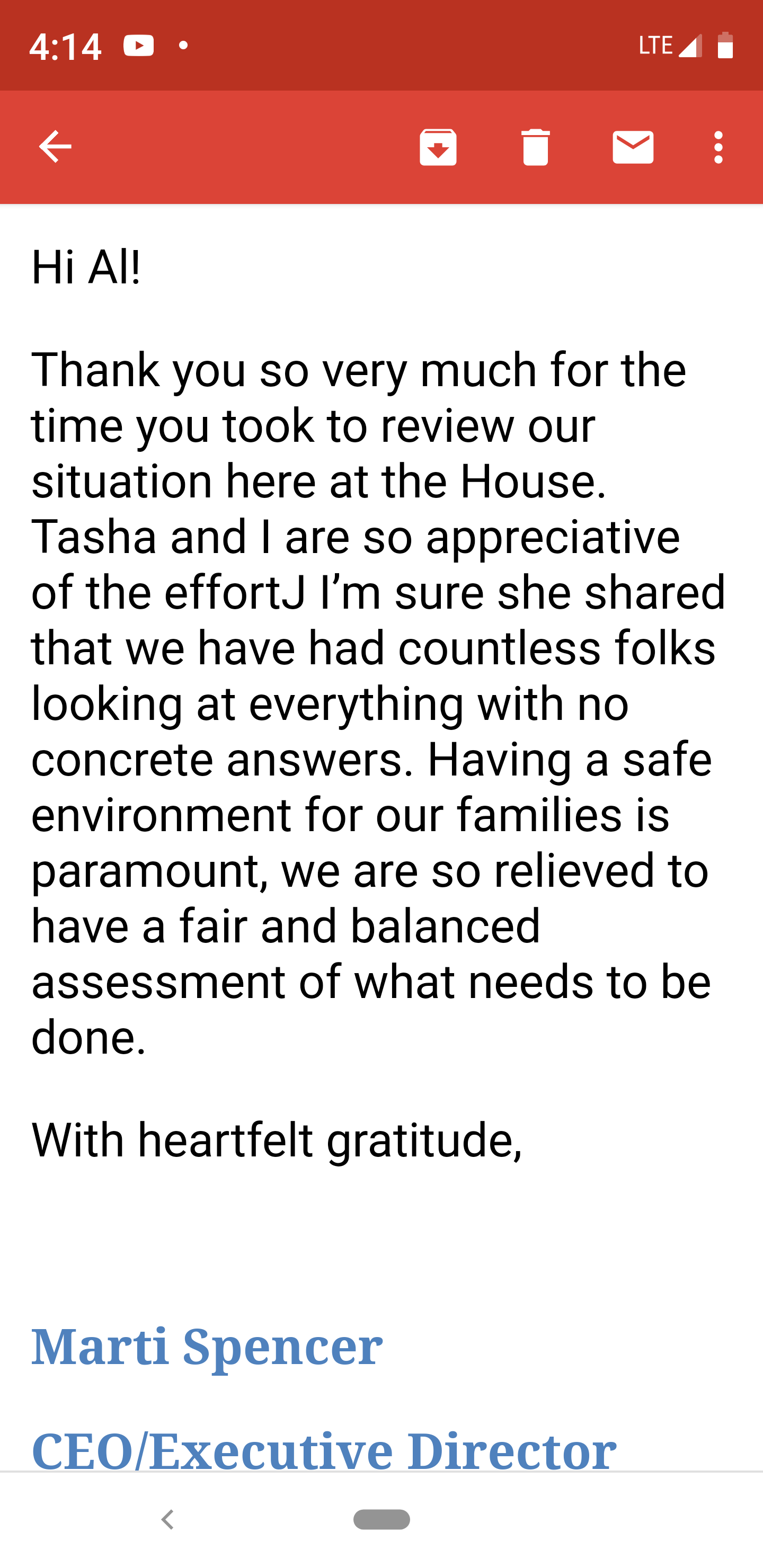

Discovering that wet space will prevent a LOT of illness and expense for them. Good job.
