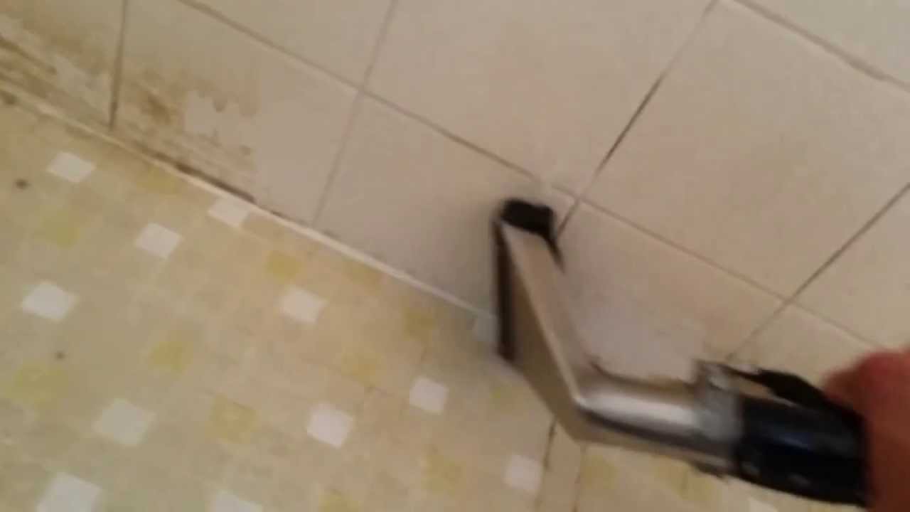

this thing?
what kind of PITA is it to pull the jet?
have an extra jet for field expedient clearing
(when a thin beading needle won't clear it)
Hint, poke the thin beading needle while triggering
if it fouls again within minutes, you need to pull the jet anyway and flush the valve/line
and toss a stuck hard fouled jet in muratic ...trust me
..LT.A
