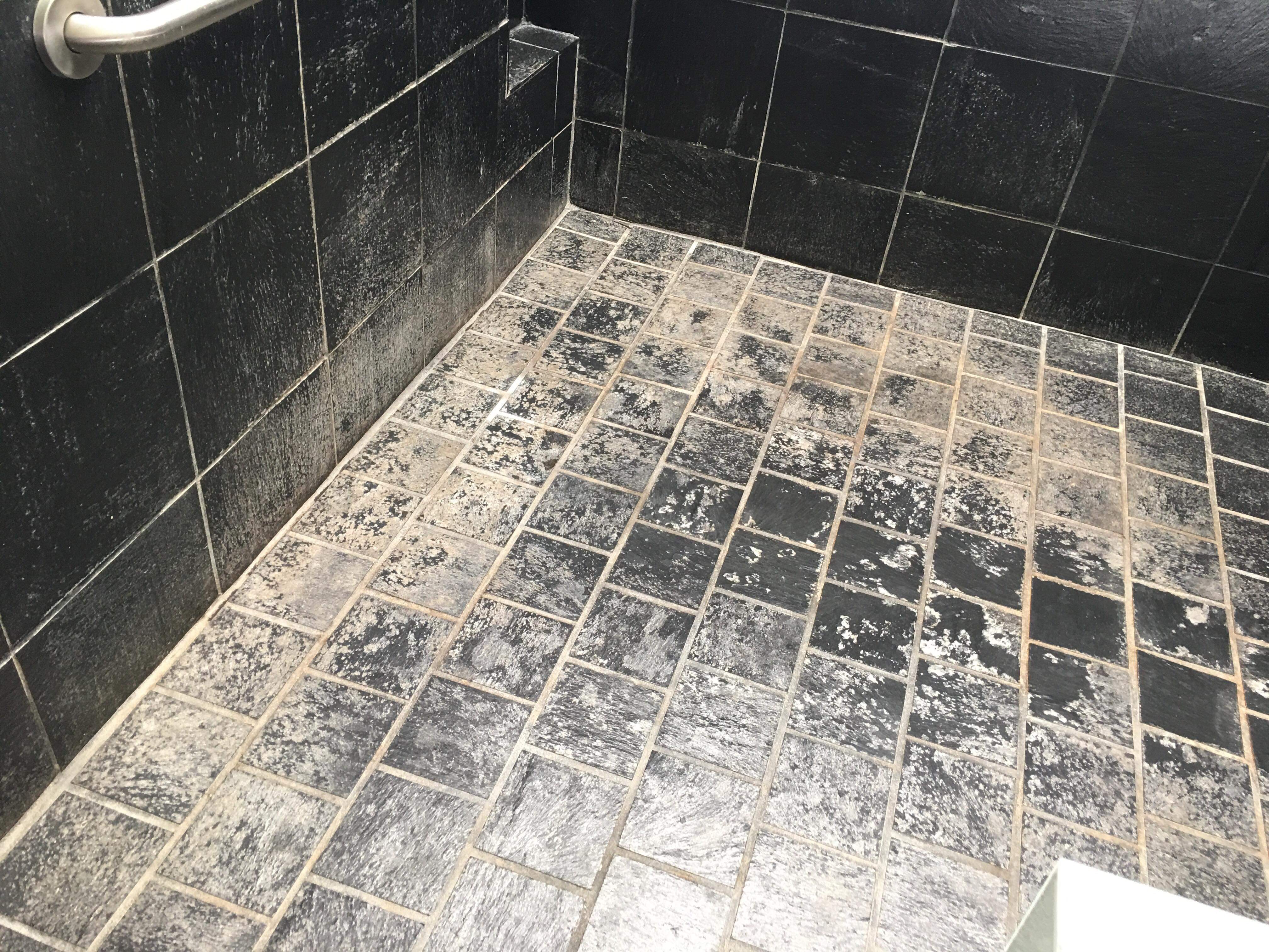

I've yet to see a Enhancer that was a topical.
Typically they are a penetrate live with a wood stain like additive, which make them oily. They need to to be wiped or buffed off after a few minutes of saturation.
Looks like this owner didn't do that properly

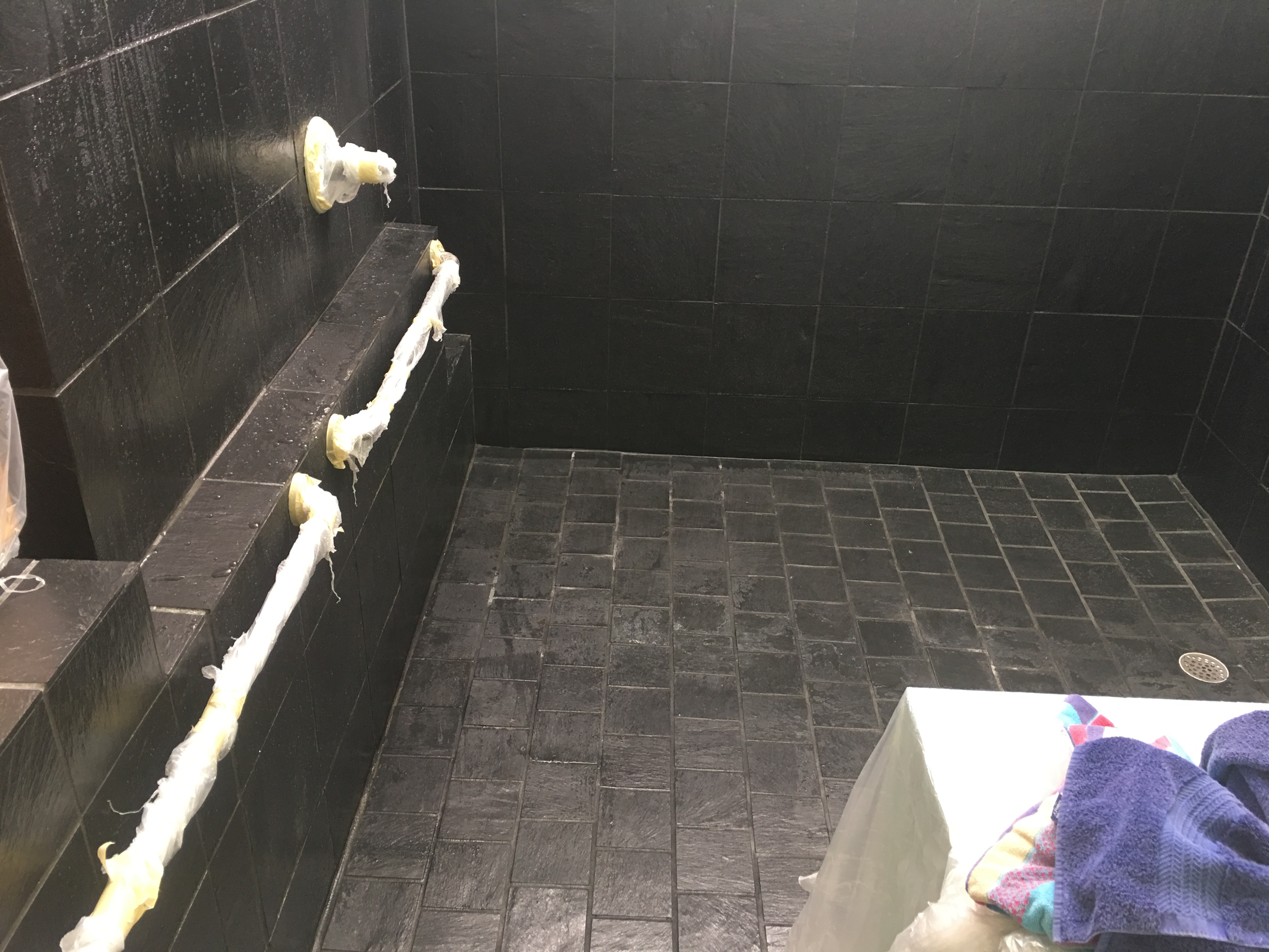

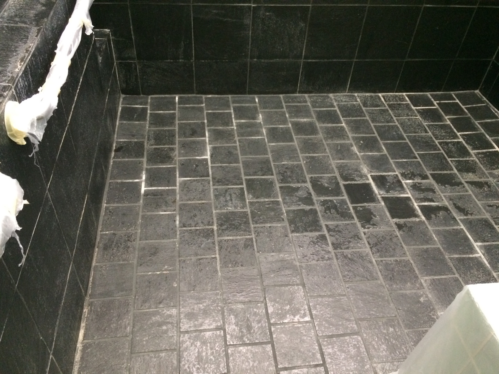

I started with 12ph tile spray/floor stripper, scrubbed, rinsed, another 12ph, scrubbed, rinsed, prochem acid, scrubbed , rinsed, acid again scrubbed rinse, back to alkaline scrubbed and rinse and it came out like this. As it’s drying it looks more and more like crap. I almost wanted to get some oil based black paint and roll it all over this crap
14,251
I’ll get another pic of it completely dry this afternoon.
Would a coating of enhancer help keep it looking black?

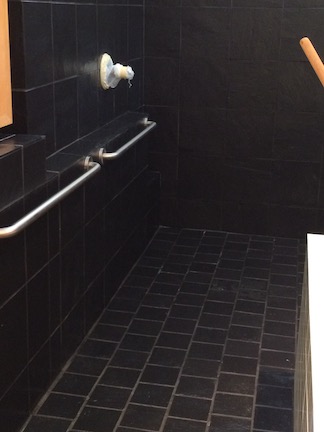

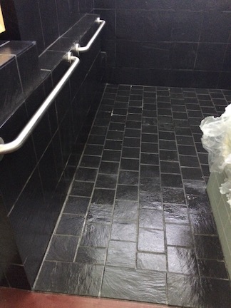

Update. This is after the impregnator sealer that they used on it. The last pic was just after the enhancer
Reactions: Hack Attack
14,251
My shower dries so quick I think I could pull off a stone shower if I use triple distilled RO water..
That’s why I told her to send me another pic 2weeks from now. We’ll see. It’s been a good learning job for me
