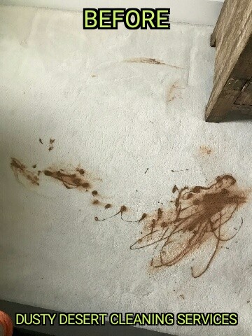

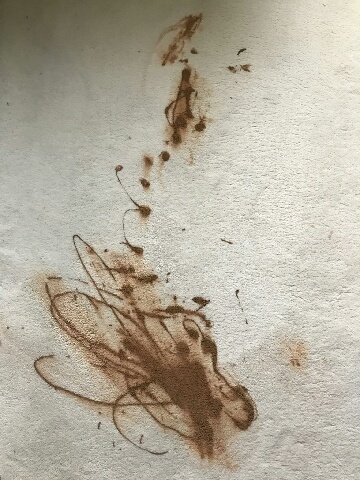

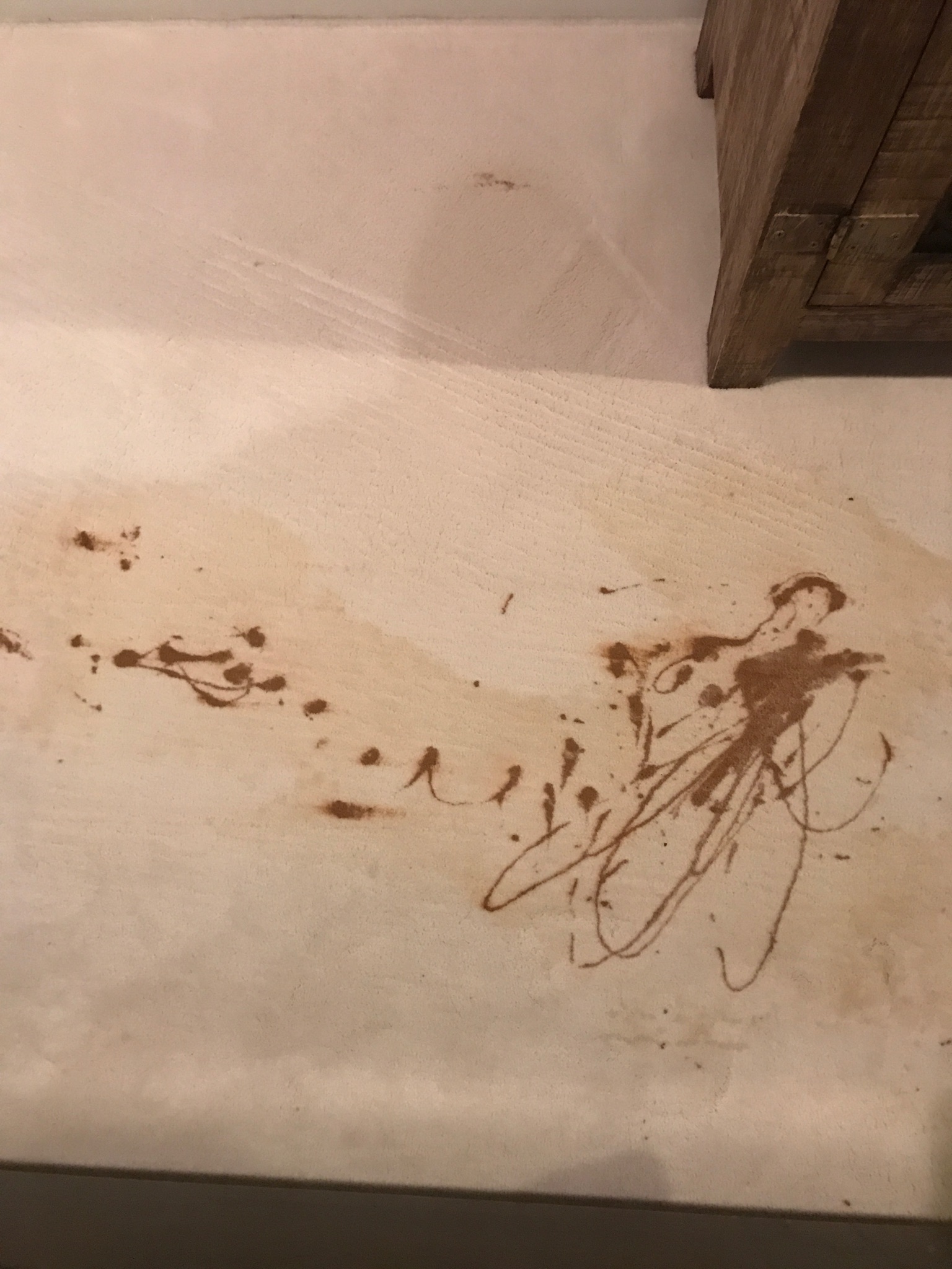

My client's daughter dump this on the carpet....
they called another carpet cleaner and they tried clean it. They said that it wont come up and they have to replace carpets...
They obviously made it worse. I have suspicious against these carpet cleaner. My client are renting this home and on their contract states that they can only use them.. as it was the same for the previous house that they rented. Anyways..
What you do to clean this stain up? They ask me to try this coming friday. My first thought was use a peroxide cleaner first on test spot..what else? I would like to wow these custy even more... Liquid foundation stain1.jpeg

Foundation like makeup?

I have pog, hel gel, chempec liquid gel, stain solv etc.. i will do various test spot to see what work.
@Cleanworks would stain solv be the one to act as a stripper?
When i read about the foundation, it seems to be both organic with petroleum mixed with pigments..
Cleaning Professional
28,283
The stainsolve is just to breakdown and suspend the oilbased part of it. A stripper is a reducing agent designed to remove fugitive dyes. Because it's already been cleaned, everything is smeared together and will be difficult to remove. Make no promises. Try the solvent first until you are no longer removing product. Then treat with a tannin spotter and rinse. Then try either an oxidizer or a reducer.

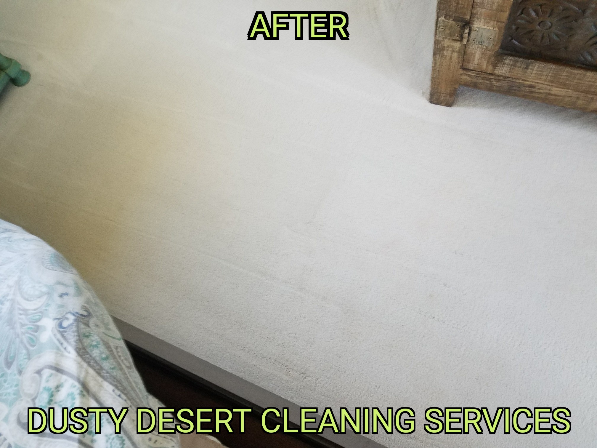

Exactly as @scottw mentioned.. i went ahead and bought avenge pro and all solve extreme. I used my portable with all fiber rinse added to solution.
I first rinsed the whole thing with no heat. Then i proceeded with the avenge pro, foamed it up and continued to do still it stop removing any more colors, blotted it. Then use all solve to get remove any other residue. Rinse and repeat throughout.
I forced dried it and it wicked up pretty bad, so i cleaned it some more using just stain 1. Forced dried it again, and it seemed to stay white. Customer was happy. Took me only 45 mins to clean Not to shabby.
