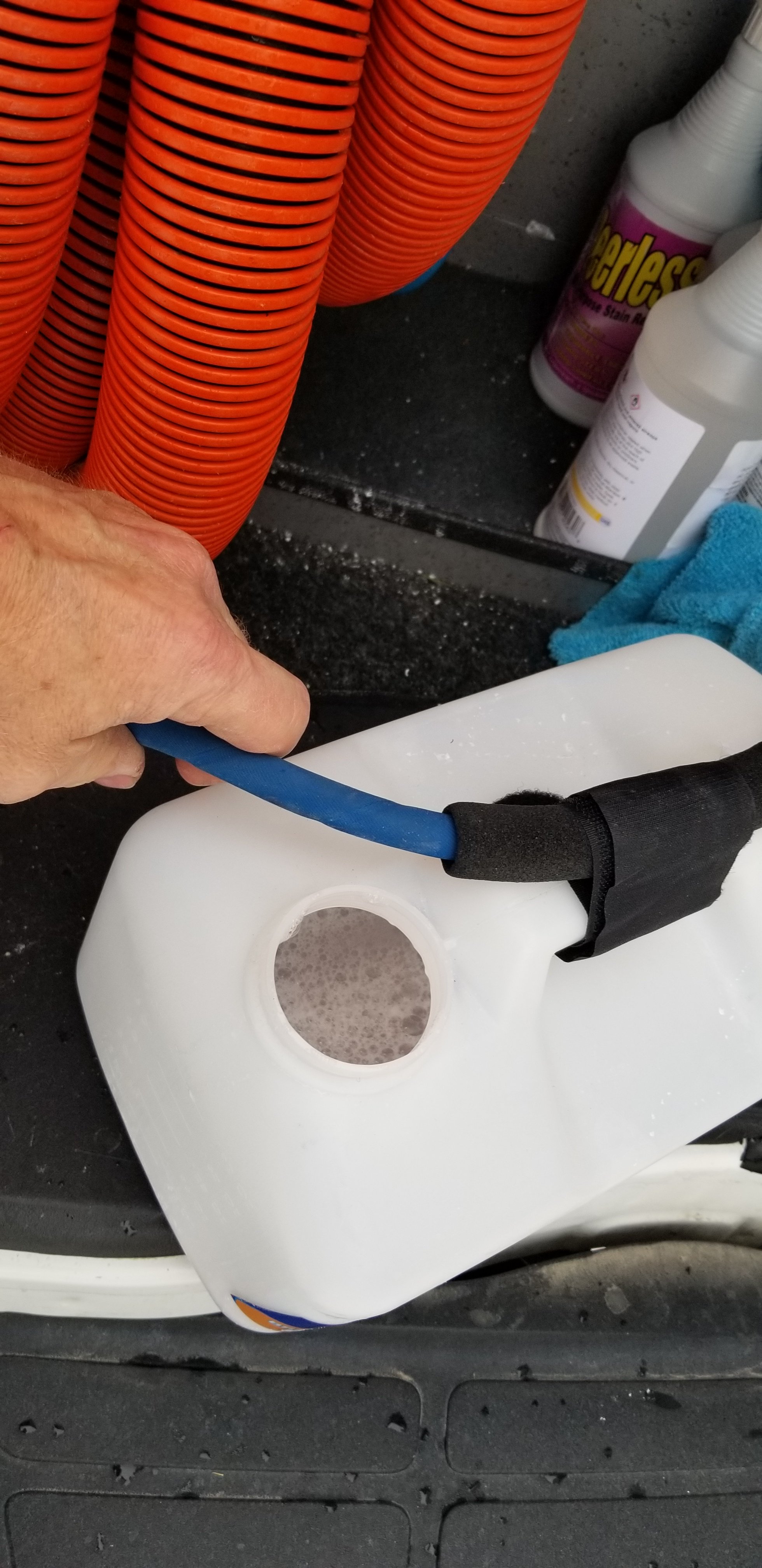

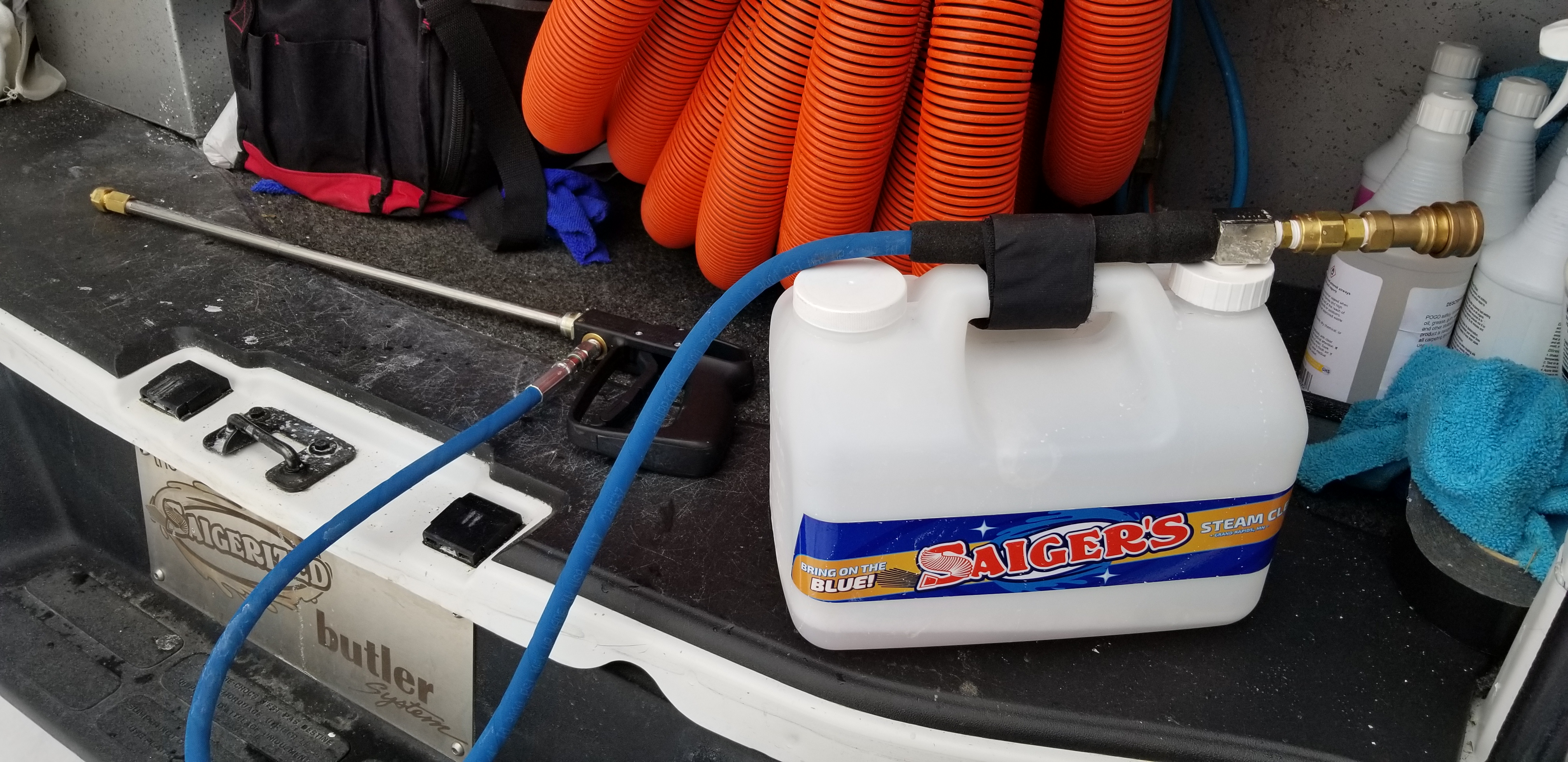

Funny you guys are talking about this. I’m using the same one going on 7 years. I’ve got probably 6-7 of them in the shop. NONE of them work, except the main one I use. The only thing I’ve replaced is the siphon hose, and the jug. It started to look like shyte.
27,969
If you let them dry with residue in them, that's what clogs it up.

A buddy I know rigged up a spray bottle with a quick coupler. He leaves it full of vinegar and at the end of the day he hooks it up and sprays vinegar through his hydro force. Says it makes them last forever. Seemed unnecessary to me, but I guess he might be smarter than I thought.
27,969
All you need is a bottle of vinegar in the truck. At the end of the day, just put the siphon hose in the vinegar and blow a little through it.
