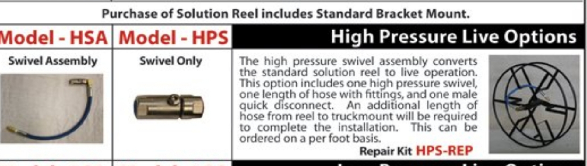

I'm considering converting over to live solution hose on my reel
14,644
My main concern is how often do you replace that 250-350ft of hose? Because I replace 1 section of my hose 75ft once a year. If I have to replace all that hose every year... no way
And where can I get the hardware to convert it without getting ripped off $$$

Rokan had a conversion kit at one time.
