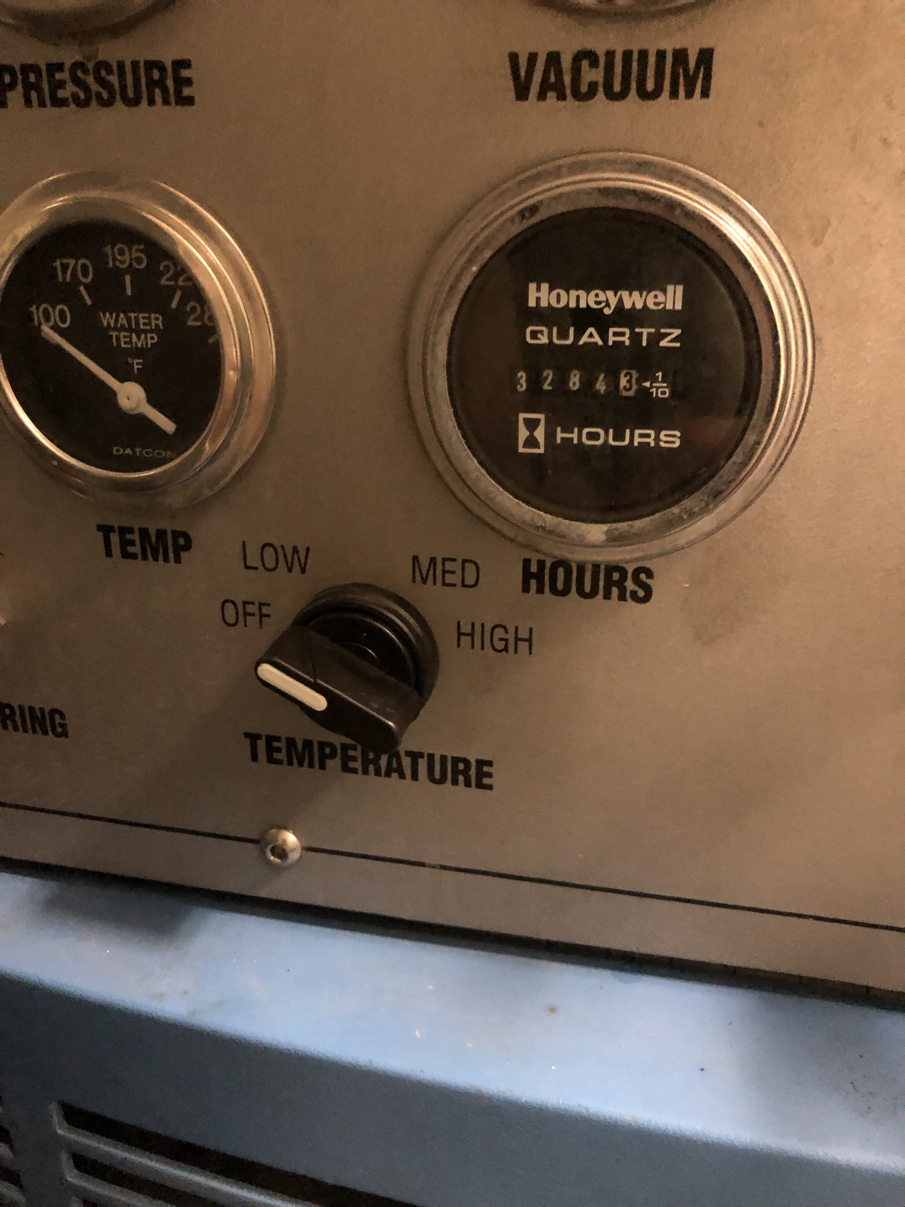

So, since I've never had to do any repairs on this machine, I really don't know a whole lot about it. Recently the water temp has taken a dump. The first thing I thought was maybe the thermostat might need to be replaced, but I'm wondering if there are any other things that would cause the machine not to produce hot water. The diverter is ALWAYS open and the radiator cap is barely warm. Any thoughts?

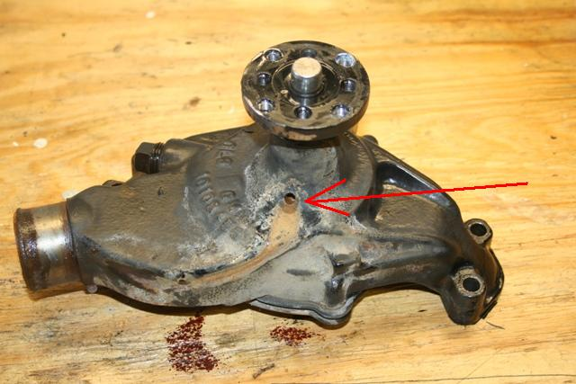

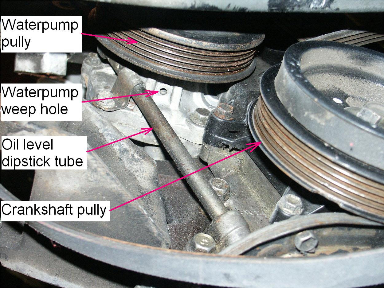

I've been corresponding with Justin from Legend. Working through one thing at a time. I think the diverter is always open because the water temps don't get hot enough to close it. I'm wondering if the problem might be an air block in the cooling system because the water pump has been weeping water. I do get occasional hot water and when I do, the radiator cap on the motor is hot. When the temps suck, the cap is warm at best.

I know perfectly well where to start. I thought maybe someone could pinpoint the problem. I've NEVER paid someone to fix my machines and I've been doing it for 35 years with no need for a backup machine. Not an emergency situation since the machine will maintain 195 degrees. Just generally slow with the heat coming up.
