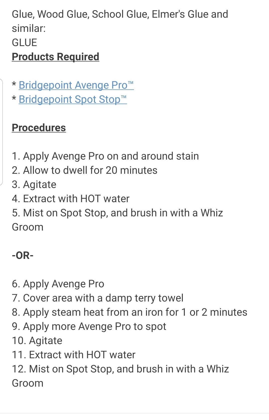

I used avenge pro or solvent clean and cut slits to let the chemical in the goo. After 15 or 20 minutes dwell I hit it with the 360i Quad or BH and it came out. I was surprised and it was the first time I had had any success removing the junk.

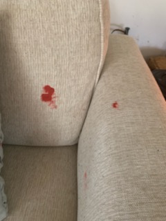

look what a customer just sent me to have look at tomorrow..
not sure if its home made silly putty or not? But its bright! 😳

I removed blue, red and white slime from some newer shag carpeting yesterday, without the use of any additional products other than the hot soft water spraying from my RV Stair Pro at 350psi.
The ability to hover over the affected areas while making 525 cleaning passes per minute greatly enhances my success in most any difficult situation.
Unlike the popular brush head, the cleaning head on the SP encapsulates the hot moisture directly underneath.
