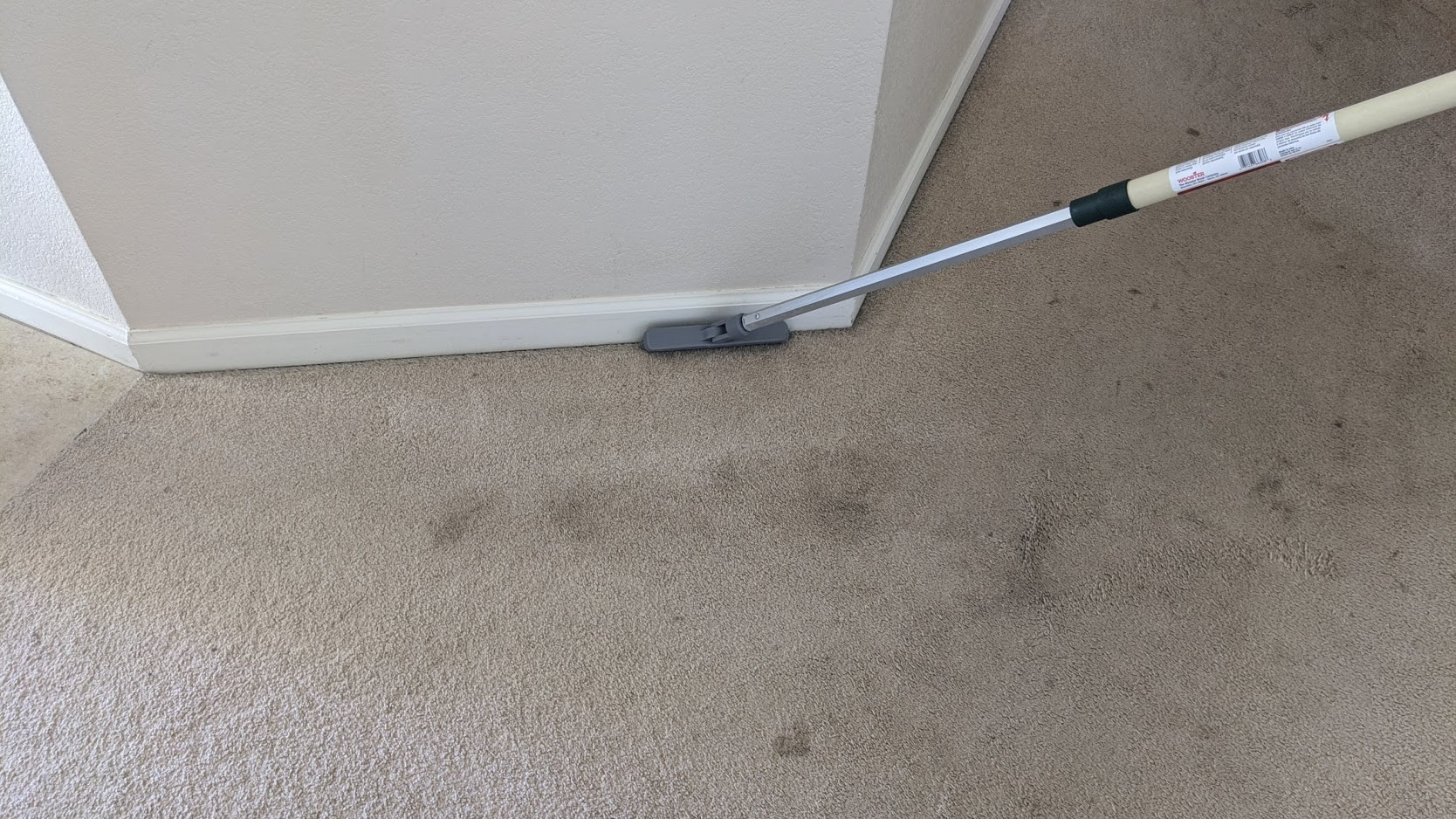

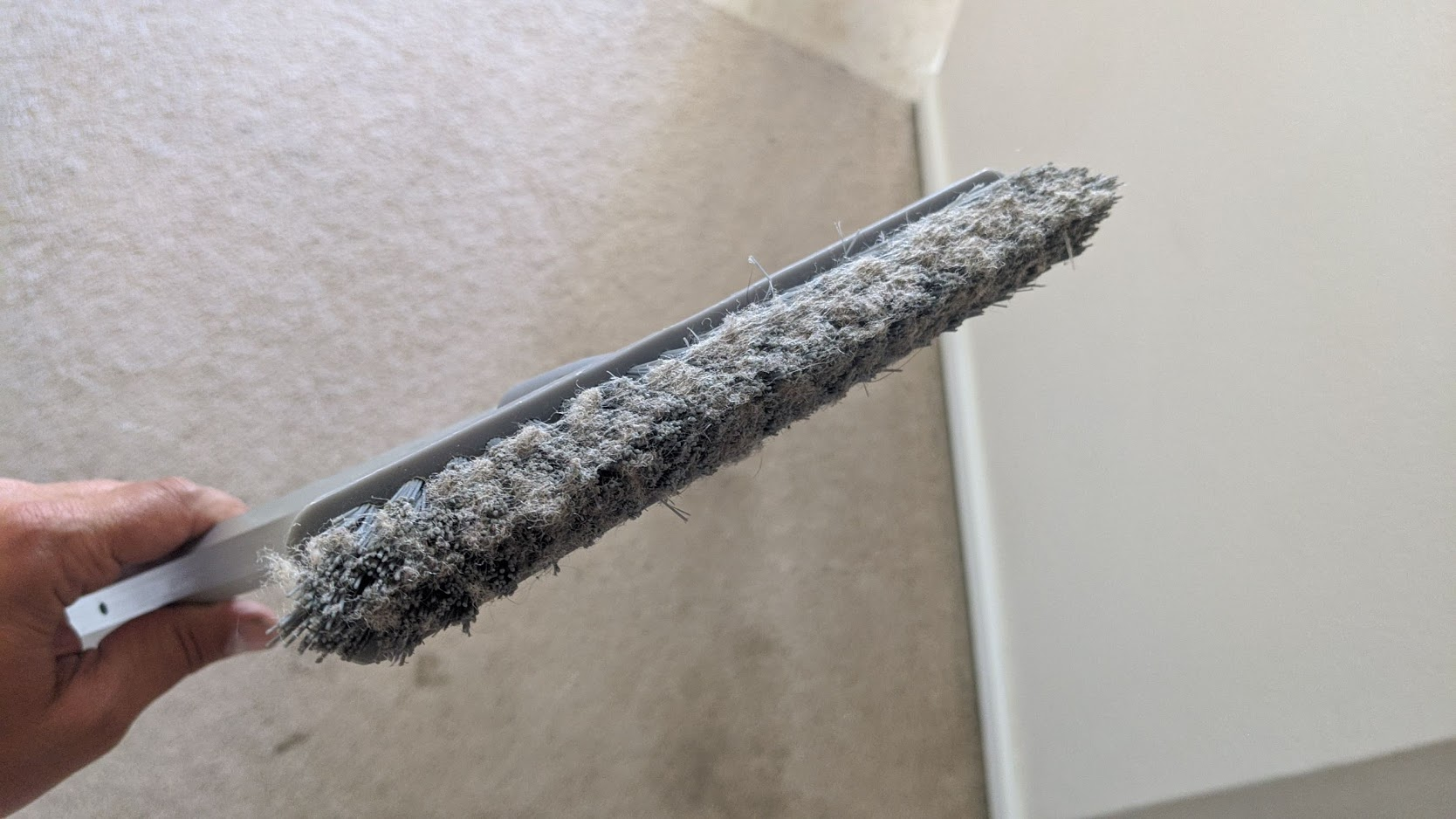

Do you realize that the black line is often just fibers, lint and dust and NOT carbon staining?
Do you ever brush the edge before you vacuum?

It is also recommended that the dust, hair, and lint accumulation at wall edges and corners be vacuumed, being careful to not damage the baseboards or walls. Cleaners should perform this perimeter vacuuming before preconditioning. A handheld or pole brush style (no metallic) Grout Brush can be very effective at helping remove embedded debris from edge and corners, especially along carpeted staircases
