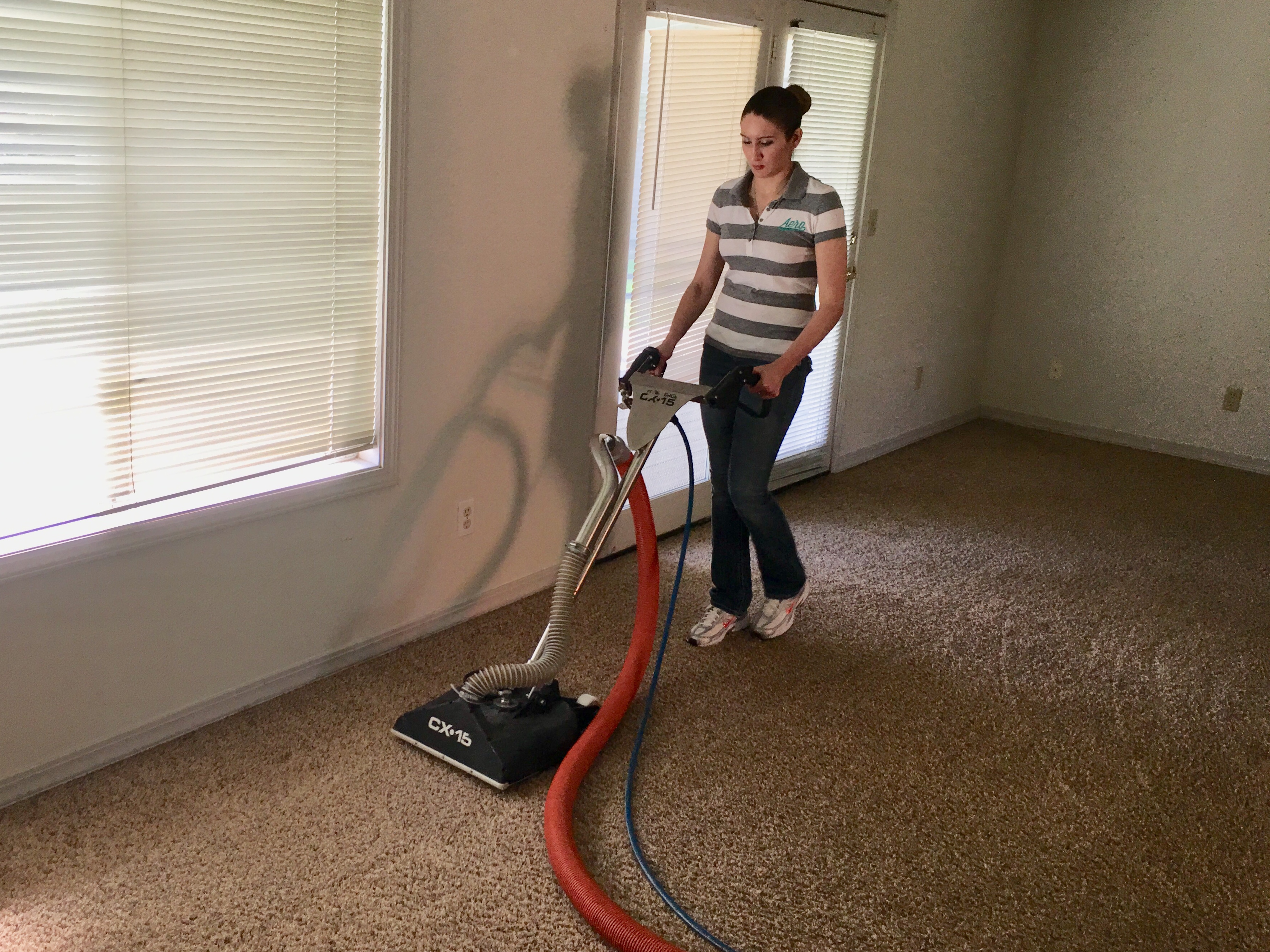

I’ll probaby have my new guy CX-15 it. :)
