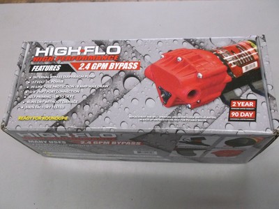

Do I need to install a bypass hose to send the water back to the tank somehow? Because it seems I have a bypass pump. I hope there’s some type of switch I can install to make this setup a Demand pump.
28,273
I think that has a pressure switch. It's that little square thing on the end of the pump. The only to tell is to hook it up, put a spring loaded garden spray nozzle on the end and turn it on. When you spray, the pump should turn on. When you let go, the pump should turn off.

Not all bypass pumps go back to the tank.
I used internal bypass pumps for years.
