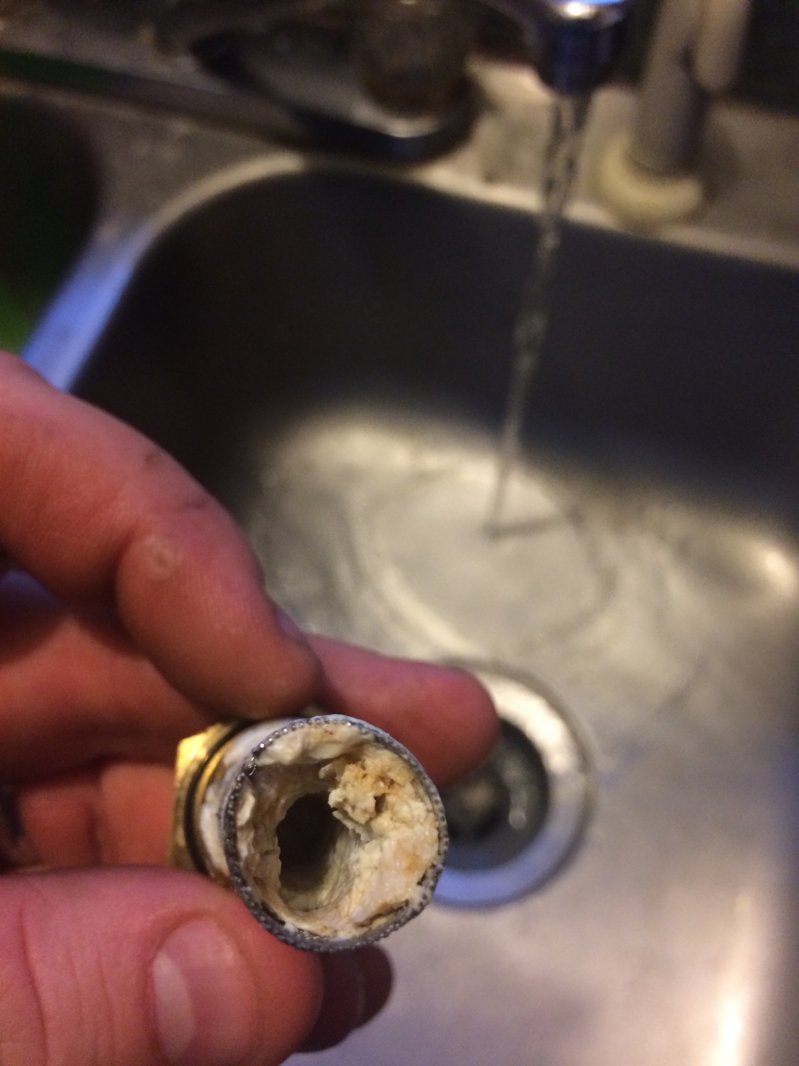

Im assuming most chemical injection systems run chem through the pump, but then you can easily rinse it out via the 5 gallon jug. In my case, i cant do that.
In some ways, it can be worse for people using a chemical jug with a super concentrated solution. Putting cleaning agents into your fresh water tank in a "ready to use" dilution shouldn't be too troublesome to rinse out if you have a drain hose at the bottom. With the 5 gallon (for the most part) containers that most TM operators use, there is an issue of concentrated product building up inside of the container. Most cleaners neglect the fact that this material will either increase the concentration of their standard product each time that they use it if they don't keep it rinsed, or it may cause negative reactions if they move between products of different polarity or pH.
This kind of problem is uncommon, but there are some icky things that can happen inside of your chemical system that you won't always notice till you have problems.

Jim raised some good points to consider. I won't go over the same things again, but will try to add a little.
Flex Ice is not usually a problem for the pump or the plumbing, but when using hard water or very high heat it can combine with minerals in the water and lead to scale build-up requiring more frequent de-scaling. The harder the water and the higher the heat, the more likely this is to occur.
If you have moderate to soft water, anything less than 7 grains, you should be fine. If your water is in the 7 -10 grain range, plan on descaling more often. If your water is above 11 grains, Flex Ice may not be the best choice for you.
While on this topic, let me make a point about water softness, something often overlooked by cleaners. Of all the things a cleaner may consider doing to get better results - more vacuum, more water pressure, more heat and all the ways they seek to reach those goals - the best thing most cleaners around the country can do to improve the cleaning results is to use soft water. A simple solution. Put a water softener in your van = better cleaning.
