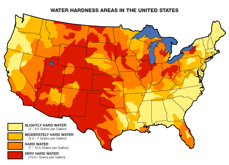

Marty is right!! Alabama has some of the softest water in the United States, but a lot of other cleaners need to take notice. https://www.google.com/search?q=wat...AhUSyWMKHZvtCl8Q9QEIKTAA#imgrc=hmXacXBVZ1BKEM: We have previously attributed this photo to the Salt Institute. The google search shows more hard water related maps.

Water hardness from city is about 7 grains... Not too bad.
Tom Forsythe
Cleaning Professional
Dec 19, 2006
486
The higher the heat of the truckmount gets you closer to vapor, the more the minerals want to separate from the water attaching to metals in your truckmount system. So 7 grains with high heat could act more like 10 grains. Water is soluble, vapor is not soluble. We get reports that high heat truckmounts are impacted more by minerals forming hard water than typical truckmounts. Of course an operator can choose when he needs high heat and turn it down when he does not need high heat.

My van came out of new Jersey and for a couple months the filter was full of crap. I descaled it a couple times and replaced all of the leaking controls.
That map shows jersey having good water
