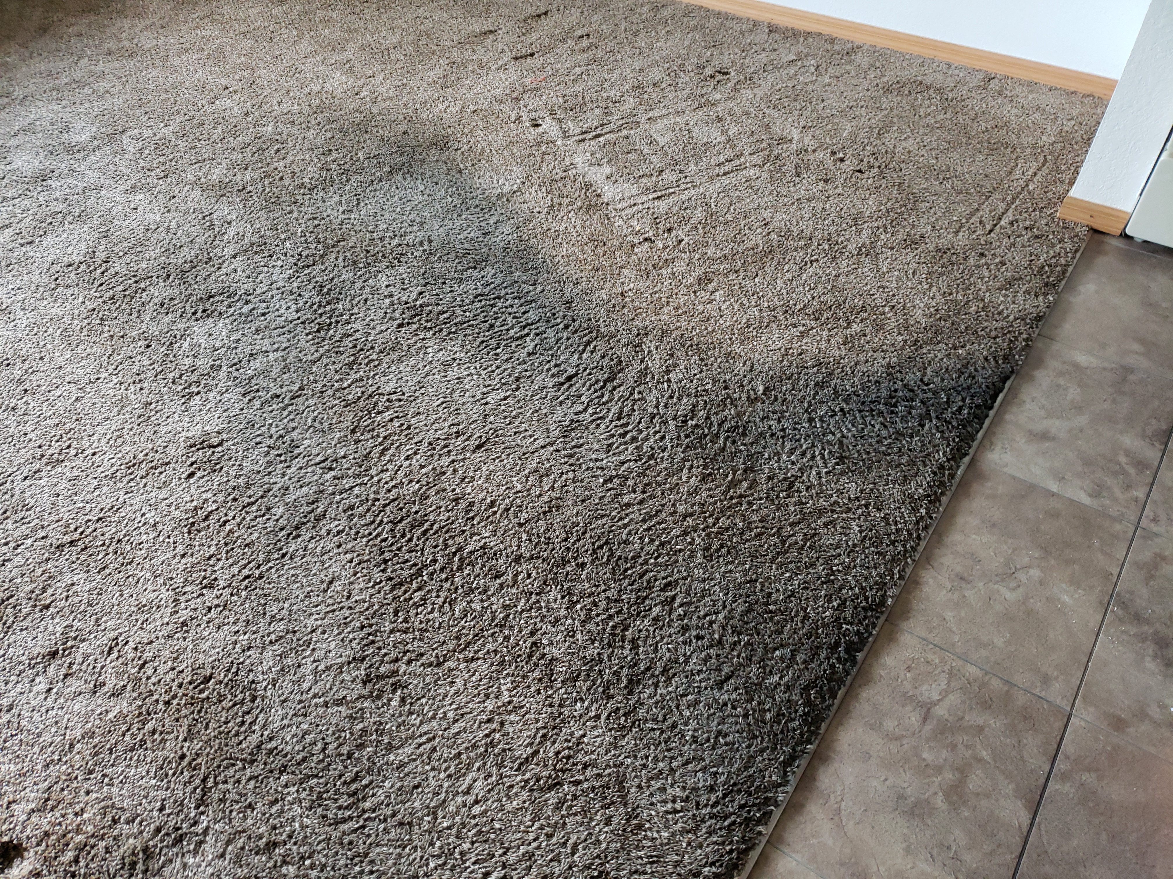

Rick J
Jan 9, 2016
962
rick Jones
PET after clean
upstairs bedroom . Rest of the place looked new. Used to seeing this, unfortunately.
And also on this stuff , often chemical damage looking like pink/purple irridescence, not correctable.

14,641
PET after clean

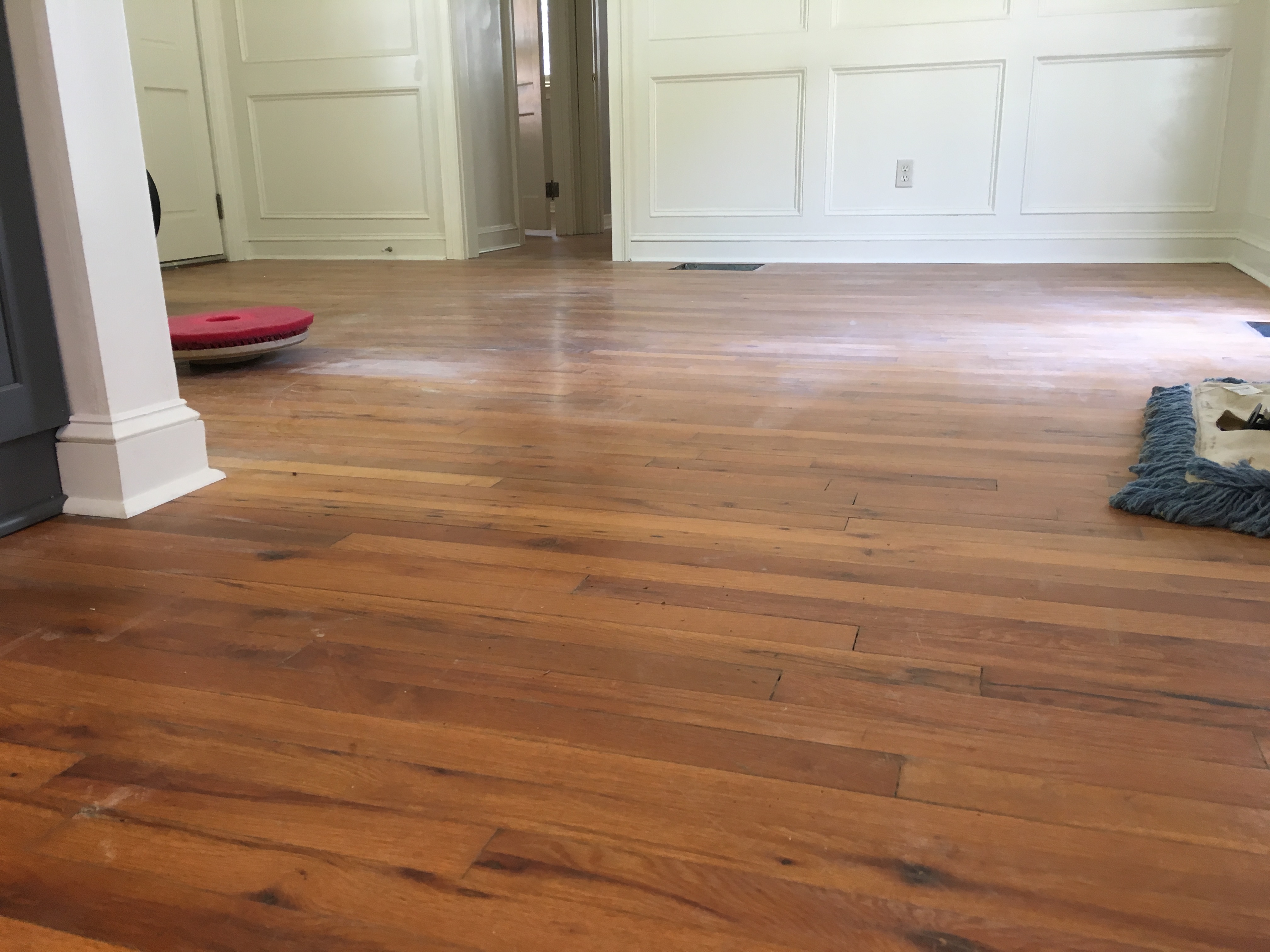

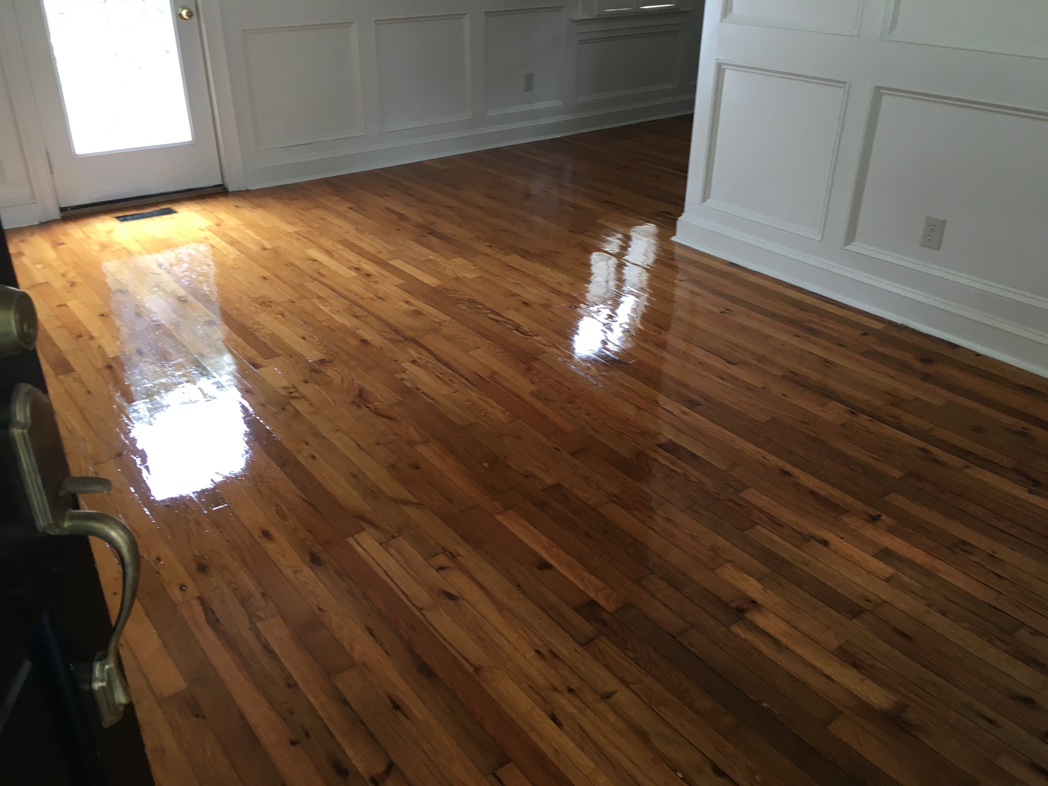

They’re pulling that crap up and discovering nice hardwood from the idiot baby boomer generation.
So I’m turning the average $150-200 3-4bedroom job into a $500-$750 hardwood job

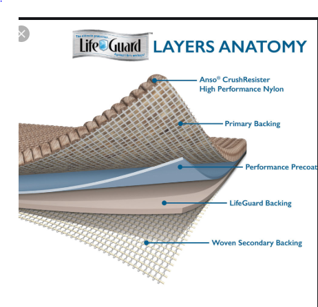

It seems some people, even some retailers are confusing P.E.T carpet with pet stain resistant carpet. I recently had a customer who was claiming he had pet proof carpet and that it had a special backing that prevented liquids from passing through. I pulled up a corner and it was just a regular backing. He was sold or assumed it was pet proof.
revitalize
May 20, 2016
59
adrian
The backing is Shaw's Lifeguard Backing which your customer didn't get.

The dirt dragon fills tackless holes too?
The dirt dragon was left in the truck on this job. The scratches were too deep to use the Tykoat method. I had to do a screening 150 to get deep in those scratches. No cleaning was needed. Just screen, tac, slap on a couple coats of finish
