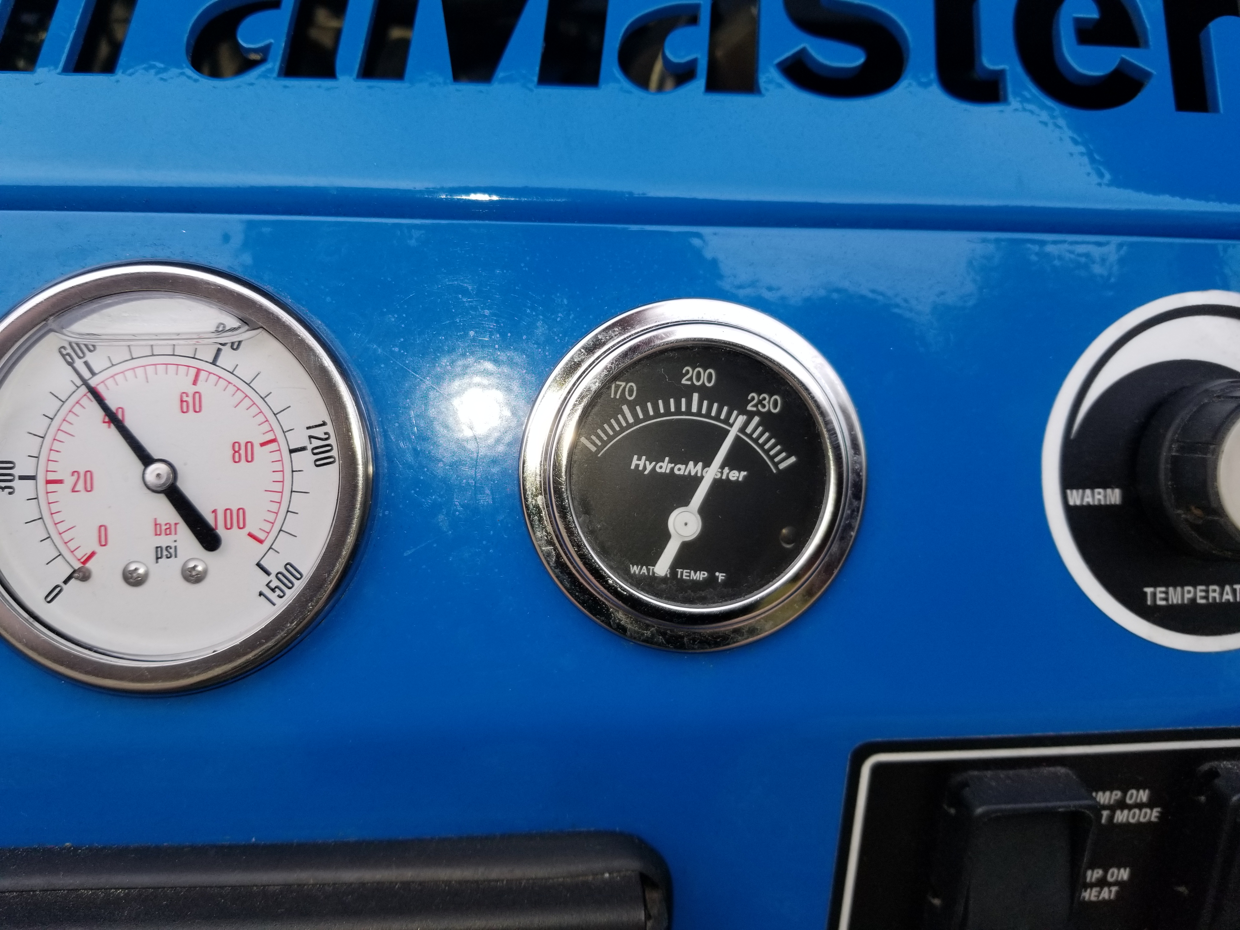

Before i brought it home, they started it up and tested it. Gauge showed 230 in temp. Im so glad nothing else was broken.
Is that your fresh water line with the longazz brass nipple?
shorten it and you get longer life out of the female QD on TM

That long thing belong to mechanic and it was hooked to solution line. I have no idea why he had it that way.

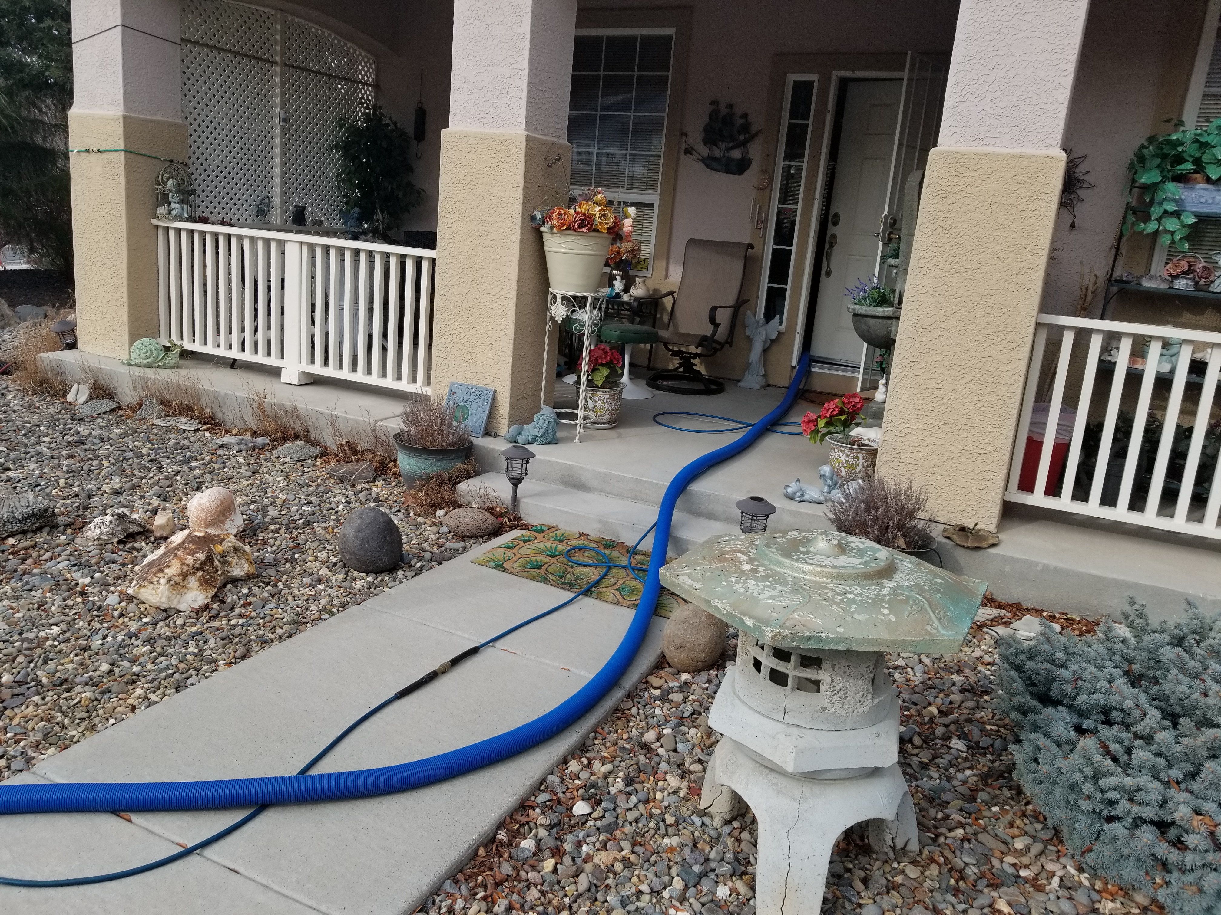

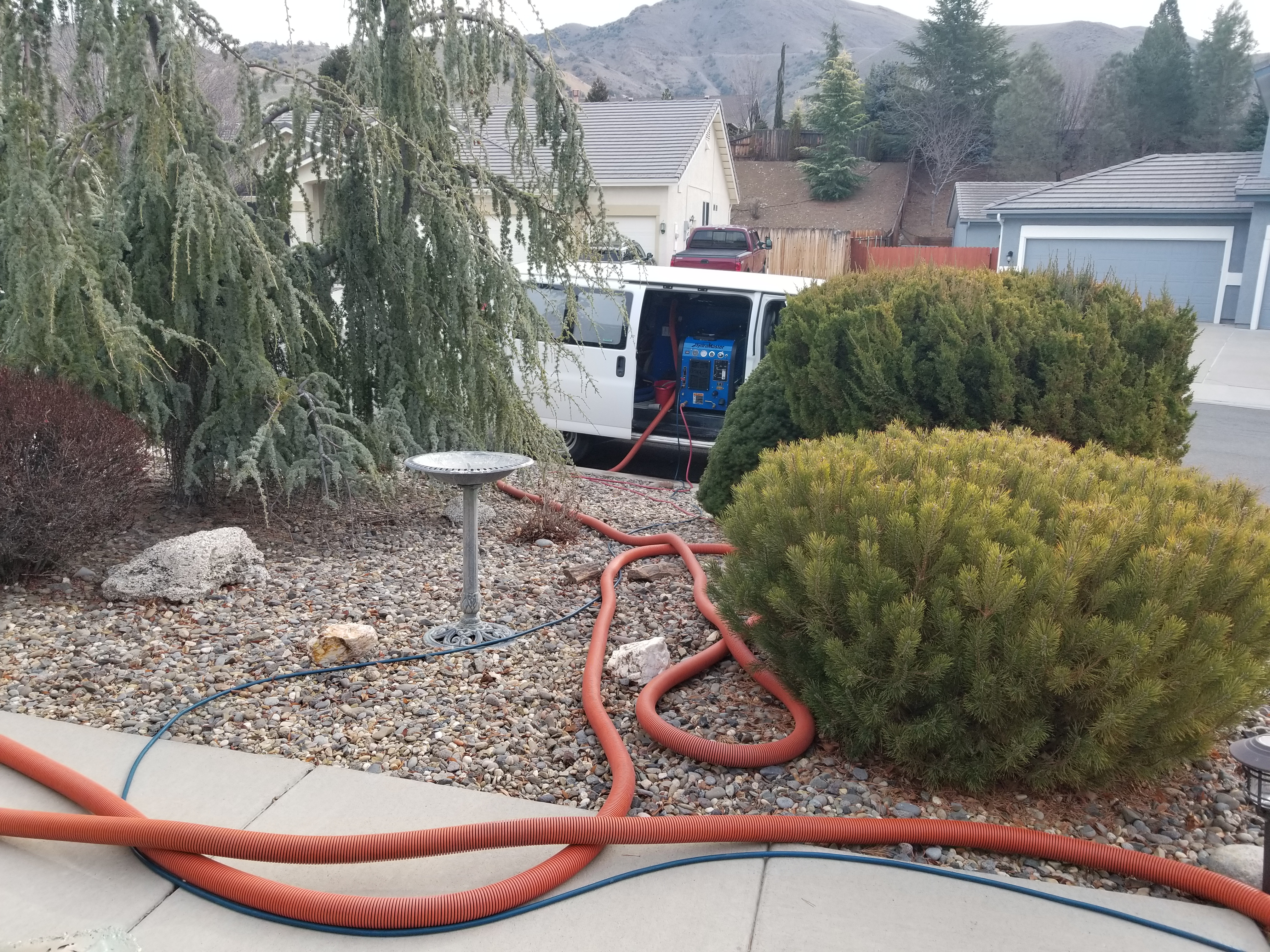

Not to shabby.

Looking good. Shorten your vac hoses as you work back to the truck. You'll get better drying times on the last parts you clean.
I did just that. I took that pic before shortening it.

Have you got Familiar with laying your vac hose on the way into the building to prevent damaging the corners of the walls?

First job, i learned that quickly.. i got the idea of what 50 ft look like to allow slack of the hose. That job had so many knick knack that i couldn't safely navigate through while laying down the lead hose.
Then i tangled up my solution hose and it had 4 knot. That job could've been done in 30 min instead of 1.5 hours.. she only want traffic path cleaned through out the house. Easy enough...not

Yeah, I've learned that setup and breakdown time is the most important in an owner/operator job. The quicker you can do that, the more time you'll save
