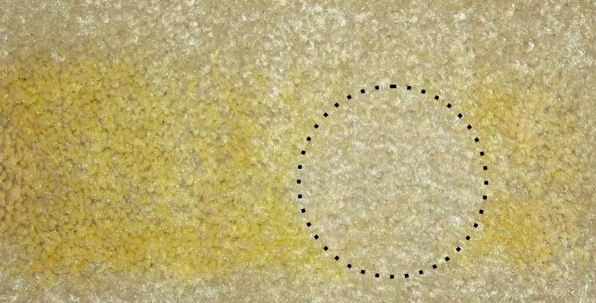

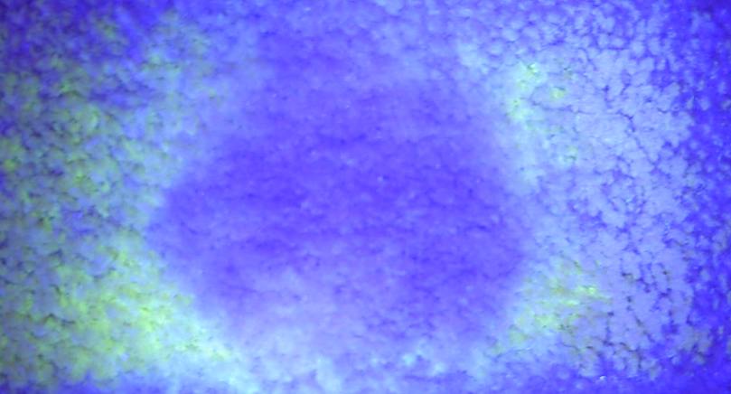

After a few quick tests, it cut the urine stain intensity by about 50%.
So it would help, but not make them invisible.
It still would take an Oxidizer + strong UV light to make Urine Fluorescence disappear:
Reactions: Nomad74
Tom Forsythe
Cleaning Professional
Dec 19, 2006
486
So are you saying that peroxide and UV light removed this fluoresence? Or it removed it with the help of a UV absorber? If the UV absorber removed 50%, then would doubling the amount of UV absorber remove it all in your test? Did you try the peroxide and UV light alone?
Larry Cobb
5,795
Larry Cobb
The photos were of Peroxide & strong UV light only.
Five minute exposure.
